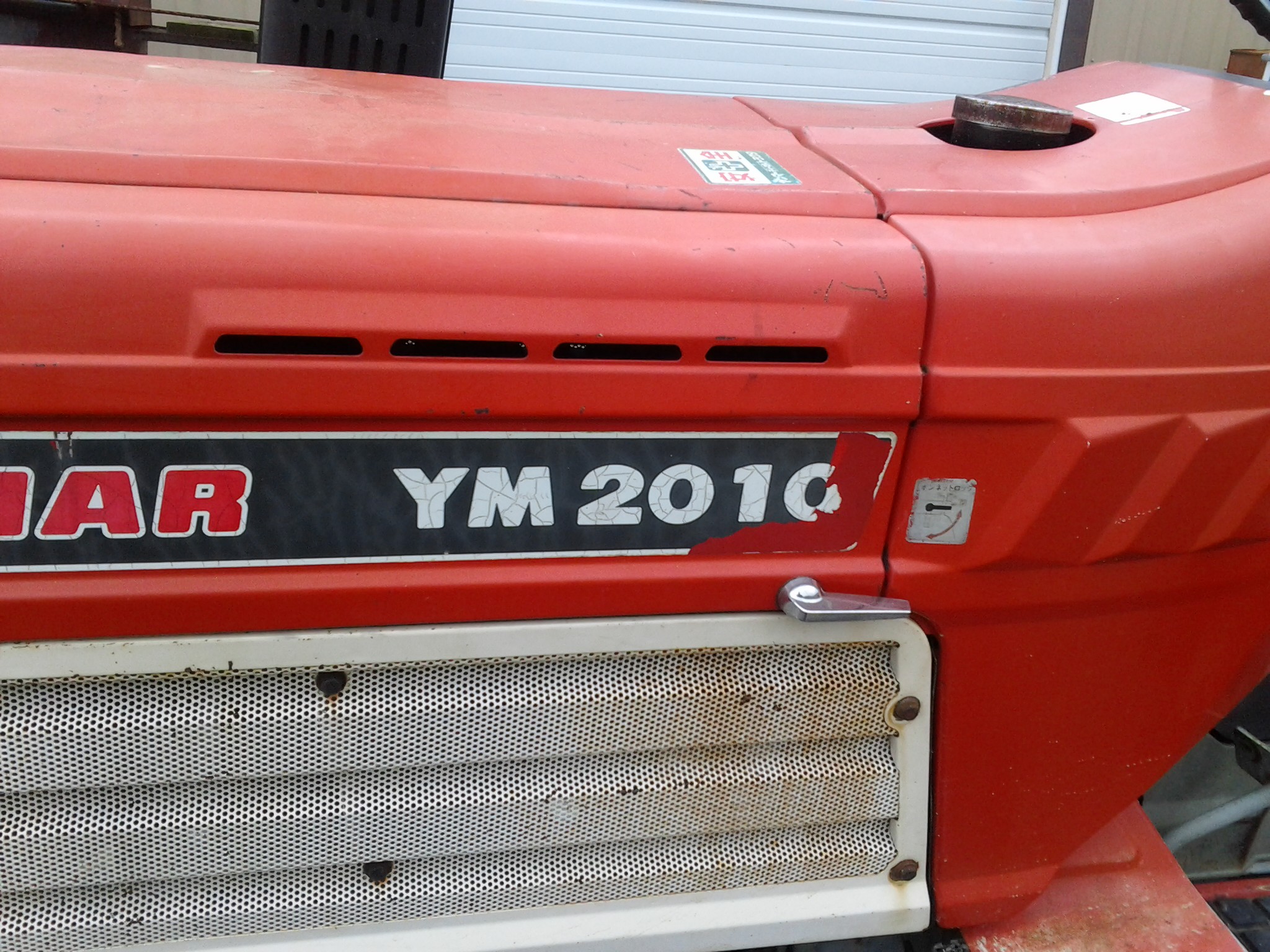

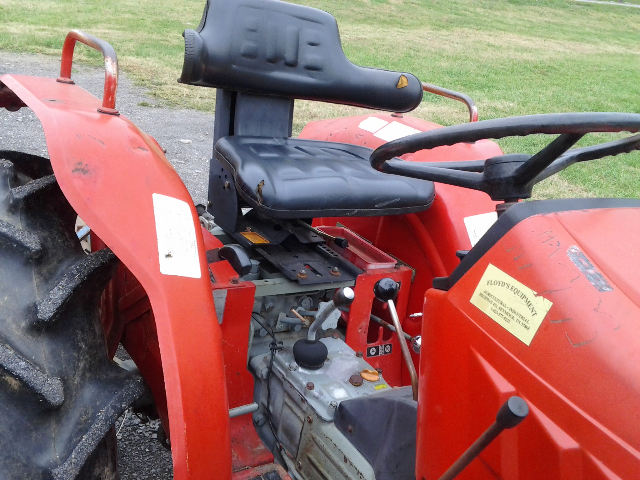

I just bought a YM2010 with the seat replaced. It is very comfortable. 1031151055.jpg1031151056a.jpg
