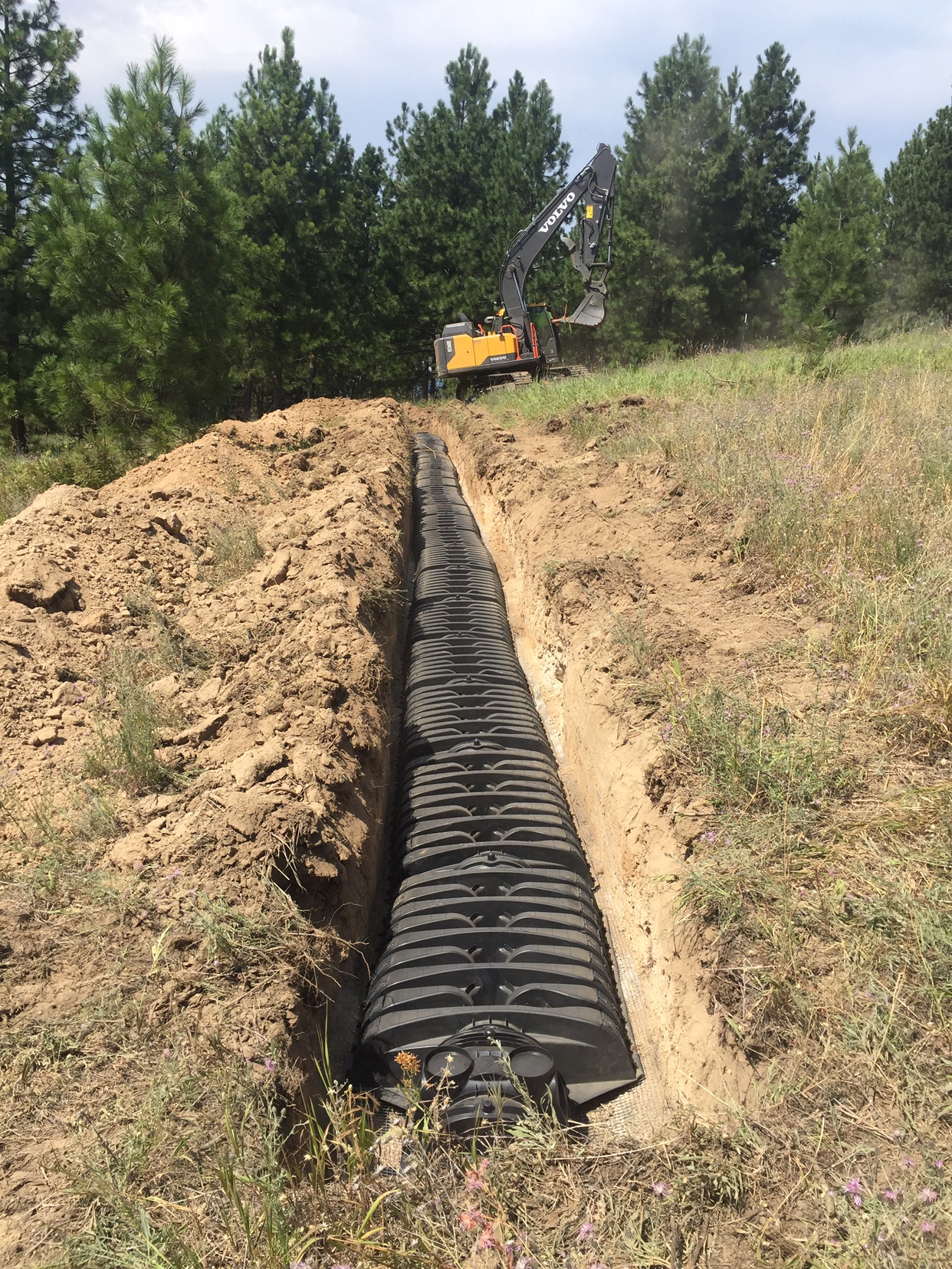

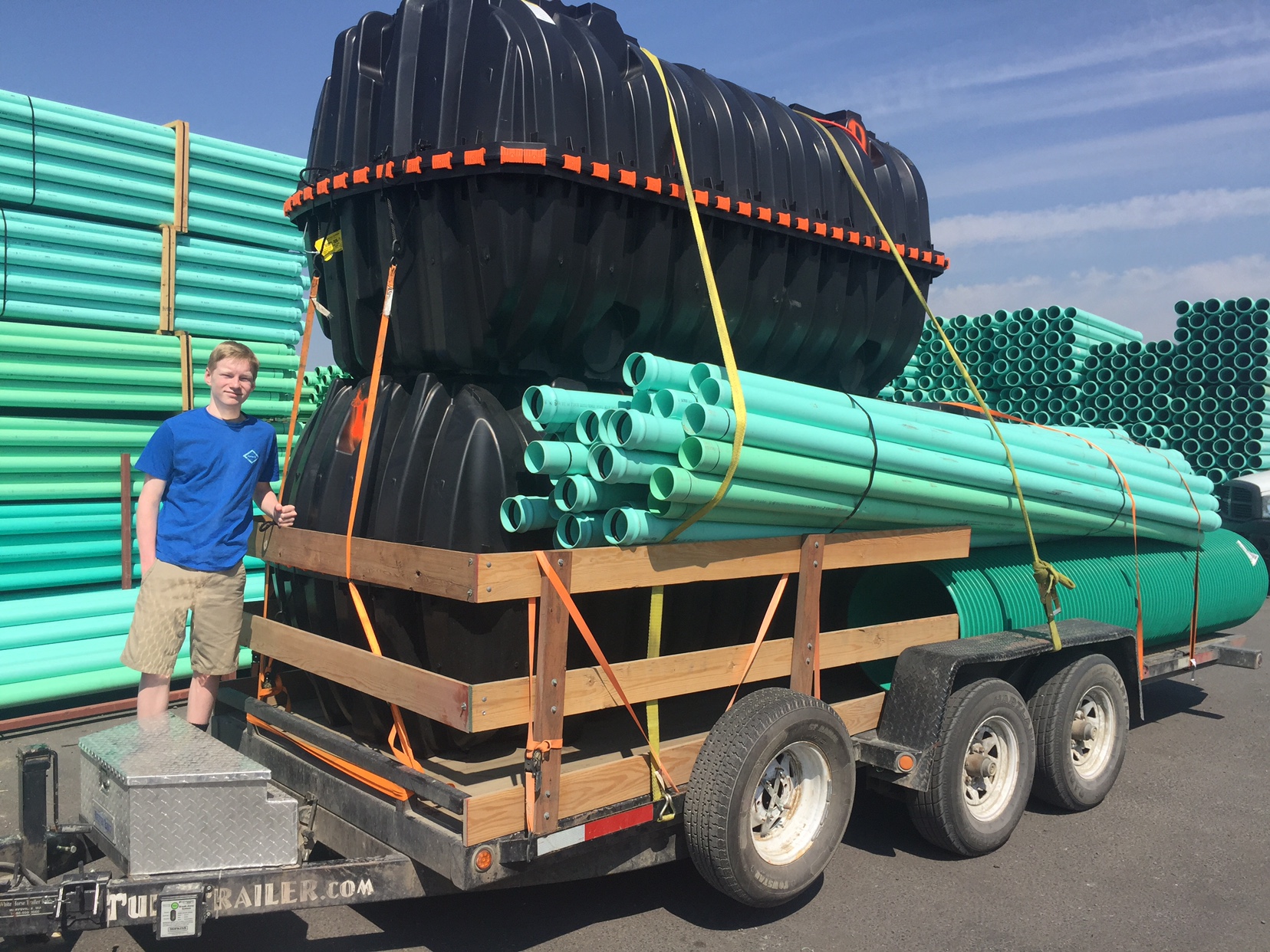

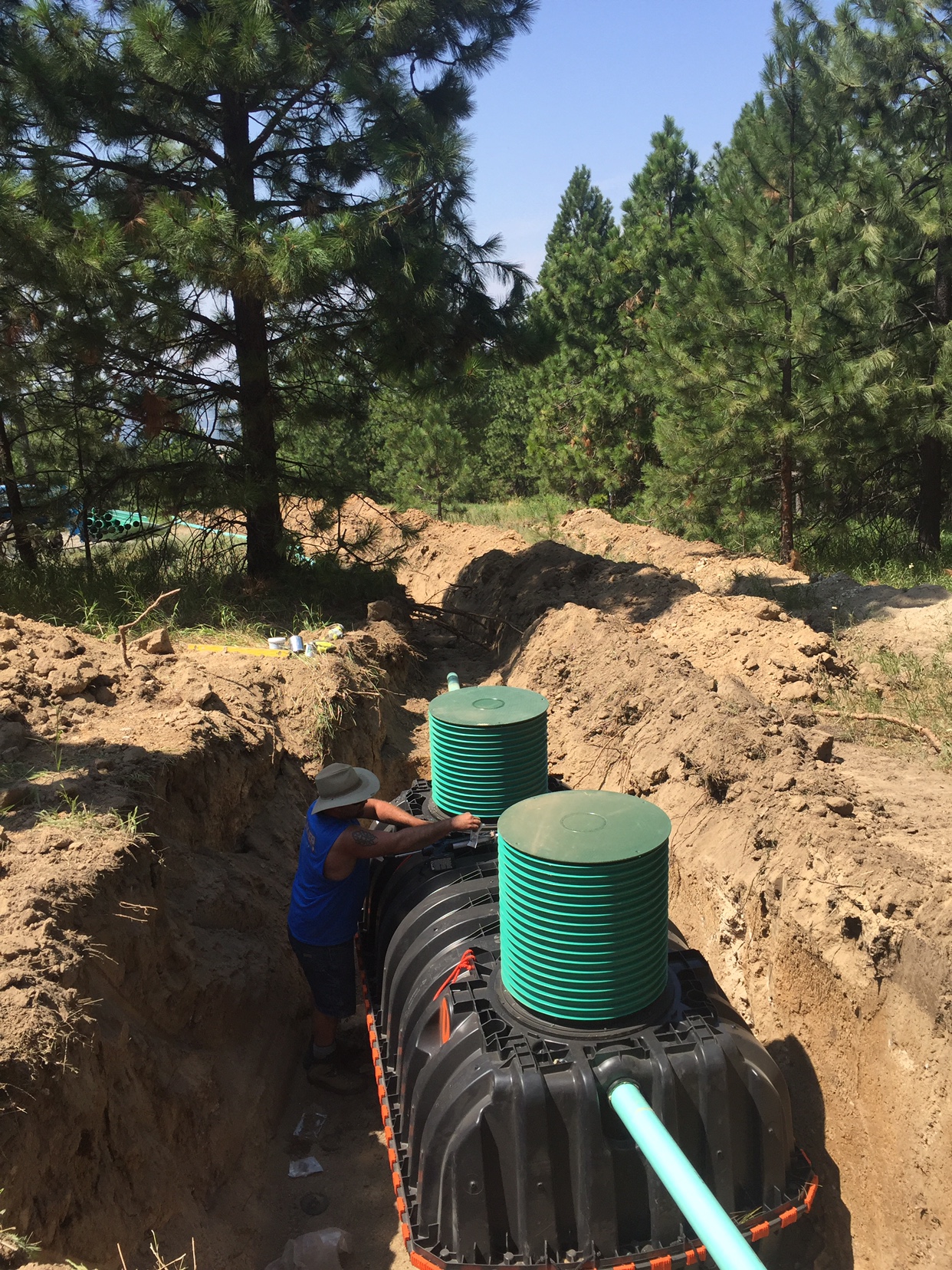

Poly tank hands down-more durable, easier to handle-big benefit if doing install yourself.
My recently permitted and installed system has 2 poly tanks (1500 and 1000 gallon dual baffle)-easy to handle off of trailer with my backhoe boom.
Have 5 100’ laterals using low profile infiltrators-in my region, gravel and pipe isn’t even allowed anymore since infiltrators are considered more reliable and thought to do a better job of distributing the effluent in the drain field. IMG_1106.JPGIMG_1120.JPGIMG_1127.JPG
Have 5 100’ laterals using low profile infiltrators-in my region, gravel and pipe isn’t even allowed anymore since infiltrators are considered more reliable and thought to do a better job of distributing the effluent in the drain field.View attachment 666783View attachment 666784View attachment 666785
