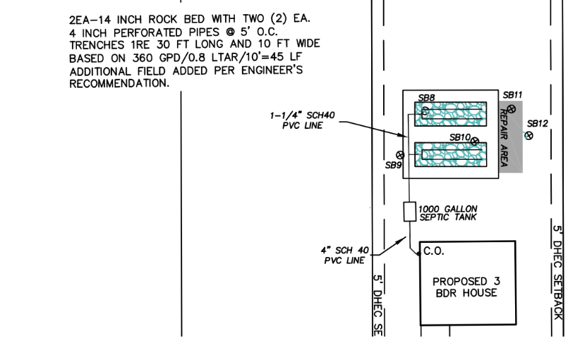

I looked at the as-built again. Here is a snippet:
According to this, we had 4x 30' drain lines originally. These were placed in 10' wide rock beds. So that would be about 120'
The area between the two rock beds is what was dug up, and an additional 30' added, with a significantly thicker layer of rock than the existing 10' beds had. This was done to get through the organics layer. Although, because the trench filled with water so fast, who knows if they fully got through the organics layer.
We are in a very low spot in the country, and the soil here is typically sandy/loamy, with some clay mixed in. Even the drainage ditches will hold water for a couple days after a storm. But our house has the advantage of being built up on 2-3' of heavy sand fill. We have neighbors on either side that are not built up, older homes, and their septic system is working fine. I do not know how much drain line they have overall.

Ok that makes more sense. An "as built" is a drawing of something that is existing. I'm guessing that drawing is the drawing of the repair?
Leach fields are required to have 100% replacement areas. That may end up in that area. If the soil layering is consistent with the neighbors and you brought in 2-3' of nice sand I'm guessing the leach lines will need to be about 6' deep. A test pit can be dug to verify the soil layering. A perk test down at the leach line depth would help too. If it was perked the test was done on that top layer which isn't your reality.
That drawing is what was done when the system was originally designed. It does not include the new "repair" line, which is located between the two rock beds shown in that drawing. I asked for a new as-built and asked if it was submitted to the county. The engineer said that they don't generate an as-built for repairs and there is no need to submit anything. Is that normal?
