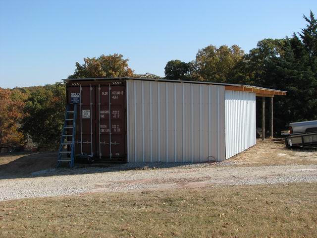

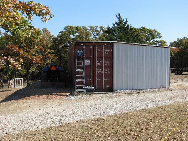

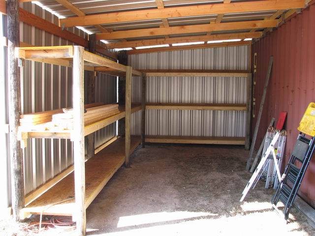

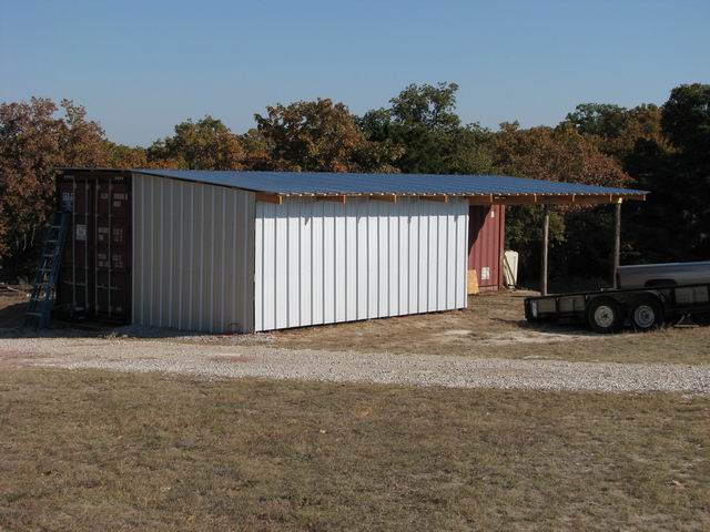

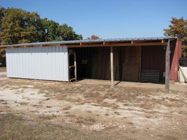

I posted earlier in this thread about a container lean-to I was building. I've just about completed the construciton for now with the constant great help from my wife.:) Here's a link to my first post for pictures and I've attached some pictures to this post to show the finished lean-to. I've got some molding work to do and later I will put a wood crib on the other side of the container. This will have to do for now because we have to clean all our stuff out of our second house before closing on the 10th of November.
Framing the lean-to
In the pictures below, you can see that we put a flat roof on the container. Even if that flat roof leaks a little, it will be okay. There's about a 6" overlap of the sloped metal on the lean-to. If we have a problem with leaks, I'll go back with some caulk under the metal to seal it. Since our weather comes from the west, it will blow against the front of the container and I doubt the roof will leak much if any. However, if we get a little snow, I may see some leaks as it begins to melt. We don't usually get more than one snow each year with any accumulation of over 4", so I'm not really worried.
Oops! I almost forgot to mention that the container used to get so hot you could not stand to be inside it for more than a few minutes at a time. In the hottest part of summer, it was unbearable. Now, it's as cool as can be. The roof and lean-to on the south side really did the trick.

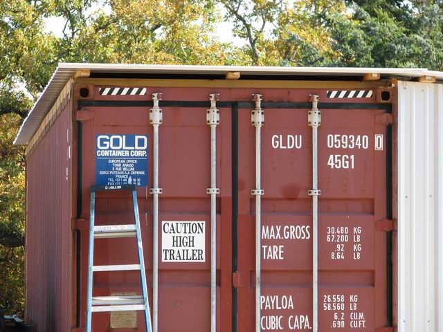

Carl, thanks for the links. I think that artist has gone out of his way to make a B-I-G statement. At night, his museum is surely hard to miss. It may be just me, but the thing I have the hardest time with is that the containers are all different colors. It might have been impossible, but if they were all from one company, the repetition of design would have added a pattern to the building. Hmm. . .
I plan to put a door in the back of my container that opens to the lean-to. I want to incorporate the corrugated side metal into the door. If I can cut it neatly enough and put hinges on it, the only thing needed would be a seal around the edges. That shouldn't be too hard. I might have to weld angle on the door edges to keep it rigid though.

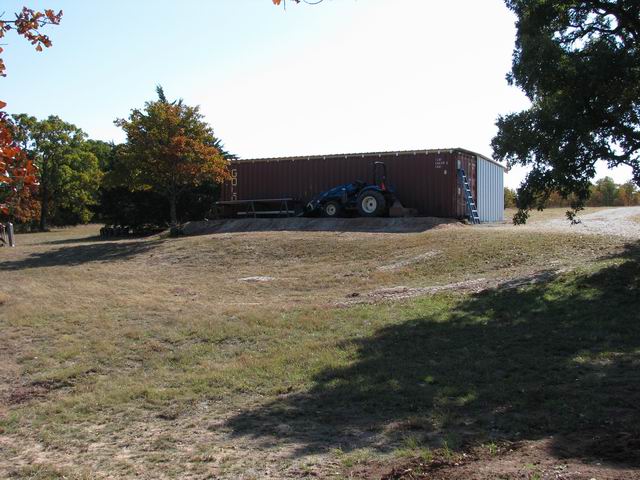

I'm trying to figure out where it's at on your land? I keep thinking that you built it where my dad parked his RV. Is that it?
Yep! You have it located, Eddie (see photo). I added to the size of that pad and cut drainage around it. I'm going to tear down that little crooked barn that was here when I bought the land and build a shop (40' x 60') there soon. As you know, you can't "find" a level spot on our land. You have to make it.
BTW: I built 172 sq ft of shelving in the lean-to and will probably add more later. I don't think you can ever have too much shelf space. By this weekend, these shelves will be full.
