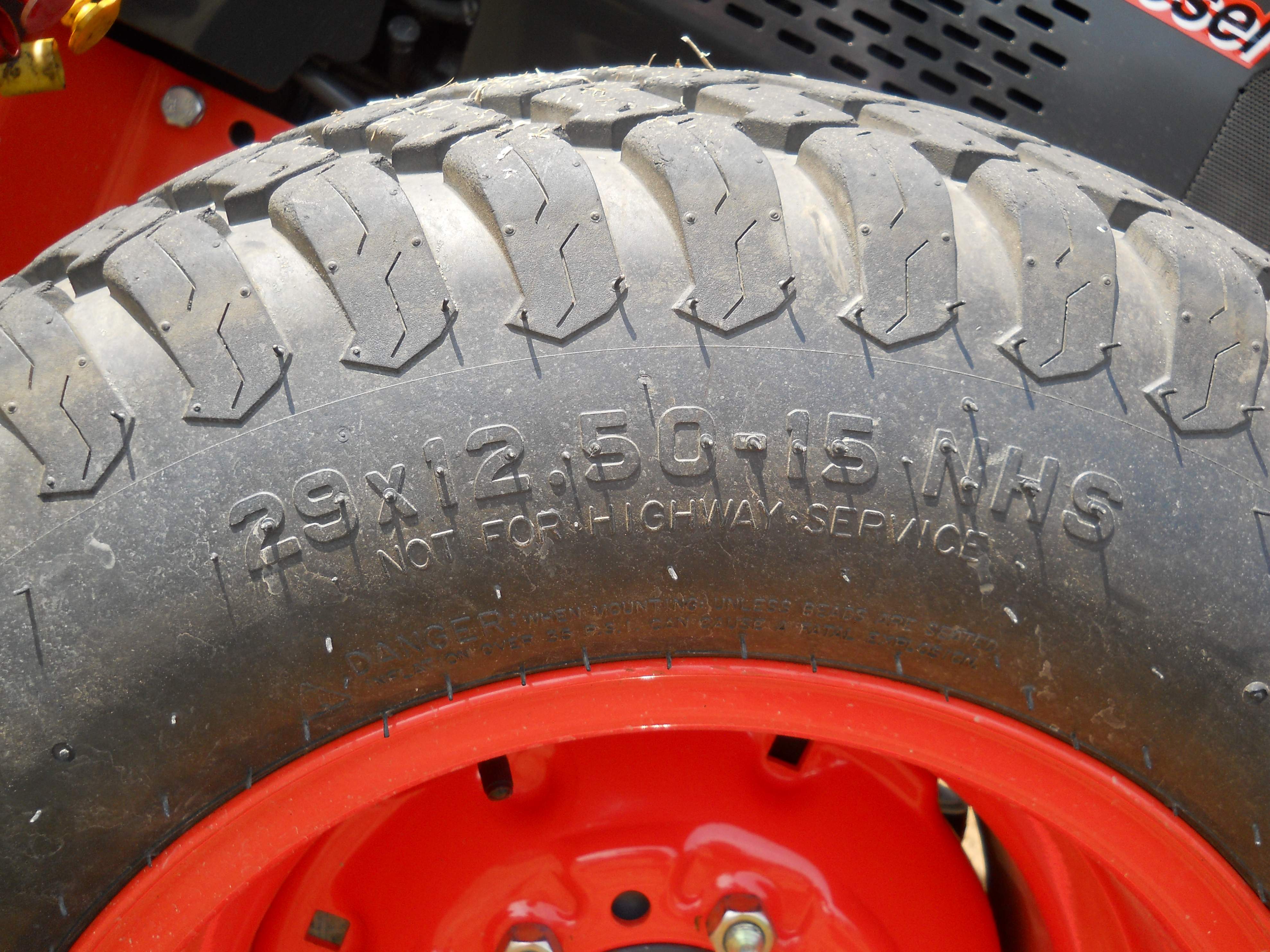

I think you need to ask PHILIP8N to post close-up pics of the actual text on his rear tires, & let you know his rear wheel diameter. It looks to me like maybe your new rear wheels have a smaller diameter. Something's gotta explain the big space between tire & fender on yours, vs much smaller on Philip's.
Maybe get the same info from him for the fronts, too, although your fronts "might" be the same size as his ... They also look a little small, though.

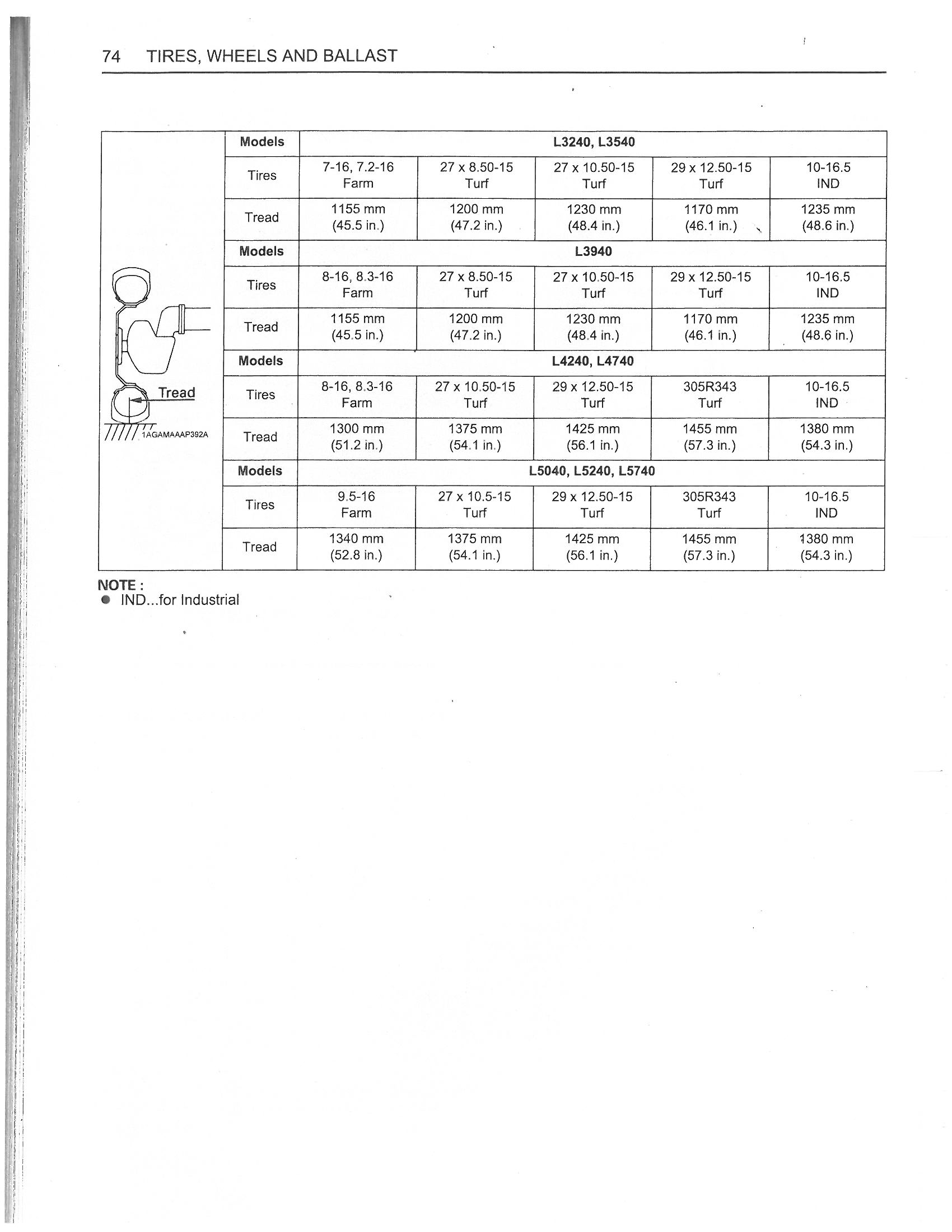

These attachements should help, right out of the manual. The L3940 and L5740 use the same size turfs. Mine are Tital Multi-Trac 'The Grizz', 44x18-20 4ply rear, and 29x12.5-15 6 ply front. Philip.

Fronts.

Philip: That's very nice of you to do that :thumbsup:

THANKS Philip for all the info. I'm sure that I have the same within my pile of manuals - just didn't think to look.
From the Kubota website, the configure page offers two turf variants - what's on your tractor and what's on mine. Mine definitely have shallower tread depth and gives a lowered ride (about 5"). Surprisingly, my rears appear to be 6-ply tires. In contrast, my fronts are listed as only 2-ply - that's a worry for me. I occasionally do a lot of heavy lifting with my grapple. Tread depth may also present problems if engaged in some aggressive disking or deep tilling - an unknown until I try. Of further note are the recommended tire pressures. For my tires, they are listed as 20psi front and 15 psi for the rears. Considering pressures on arrival (30psi front, 40psi rear; mounted by dealer), I was puttering around on some mounted mill stones.
Still haven't decided on my best option - more info to digest. There's pro's to both, just need to count the con's.
