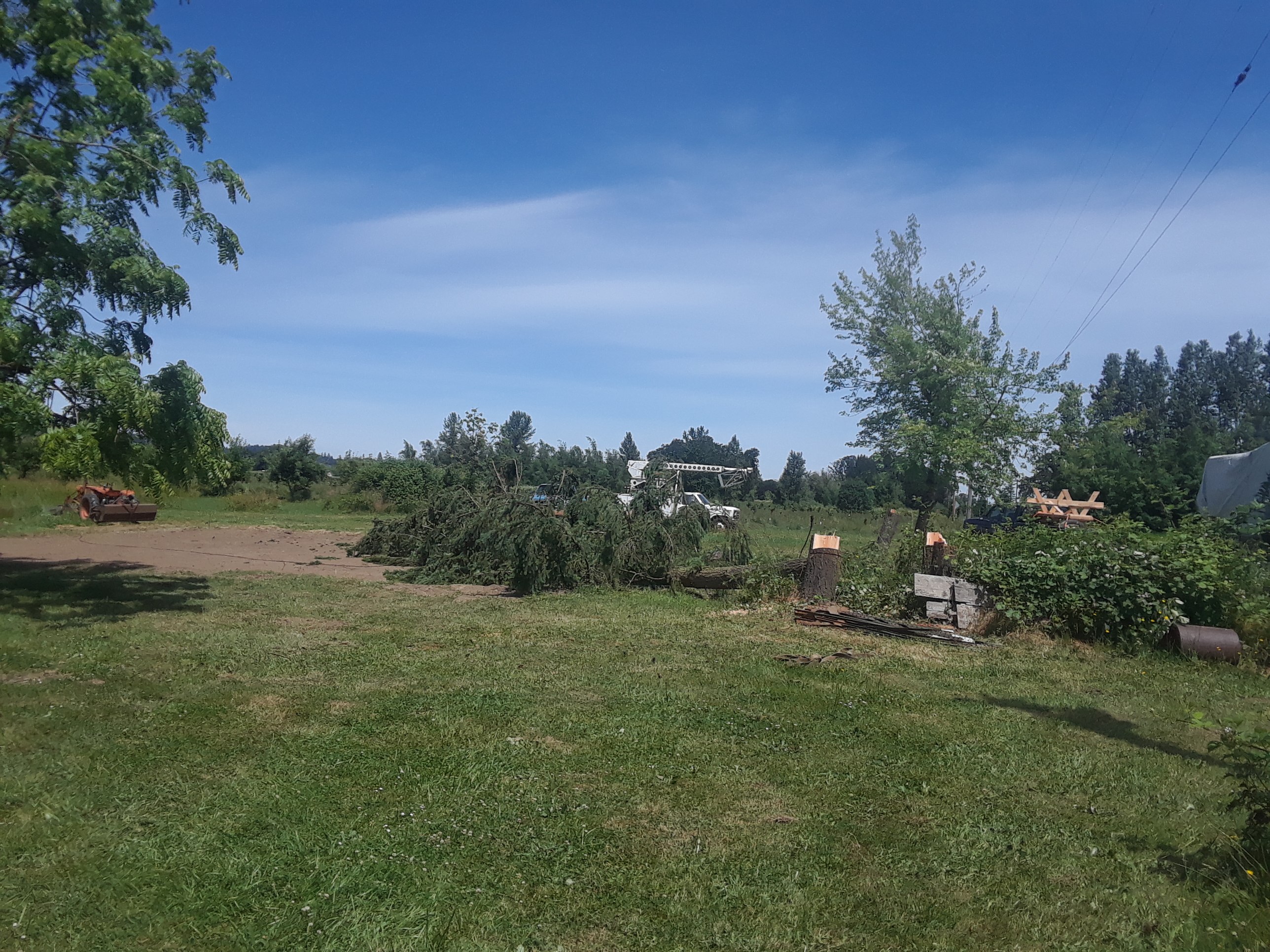

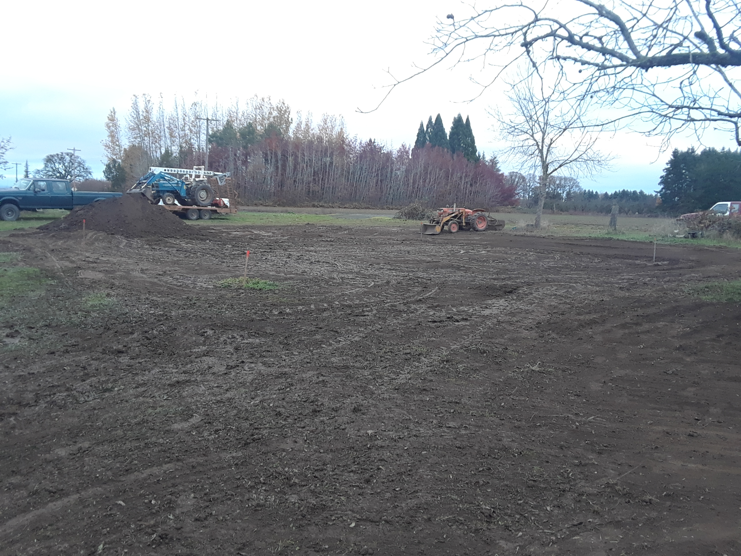

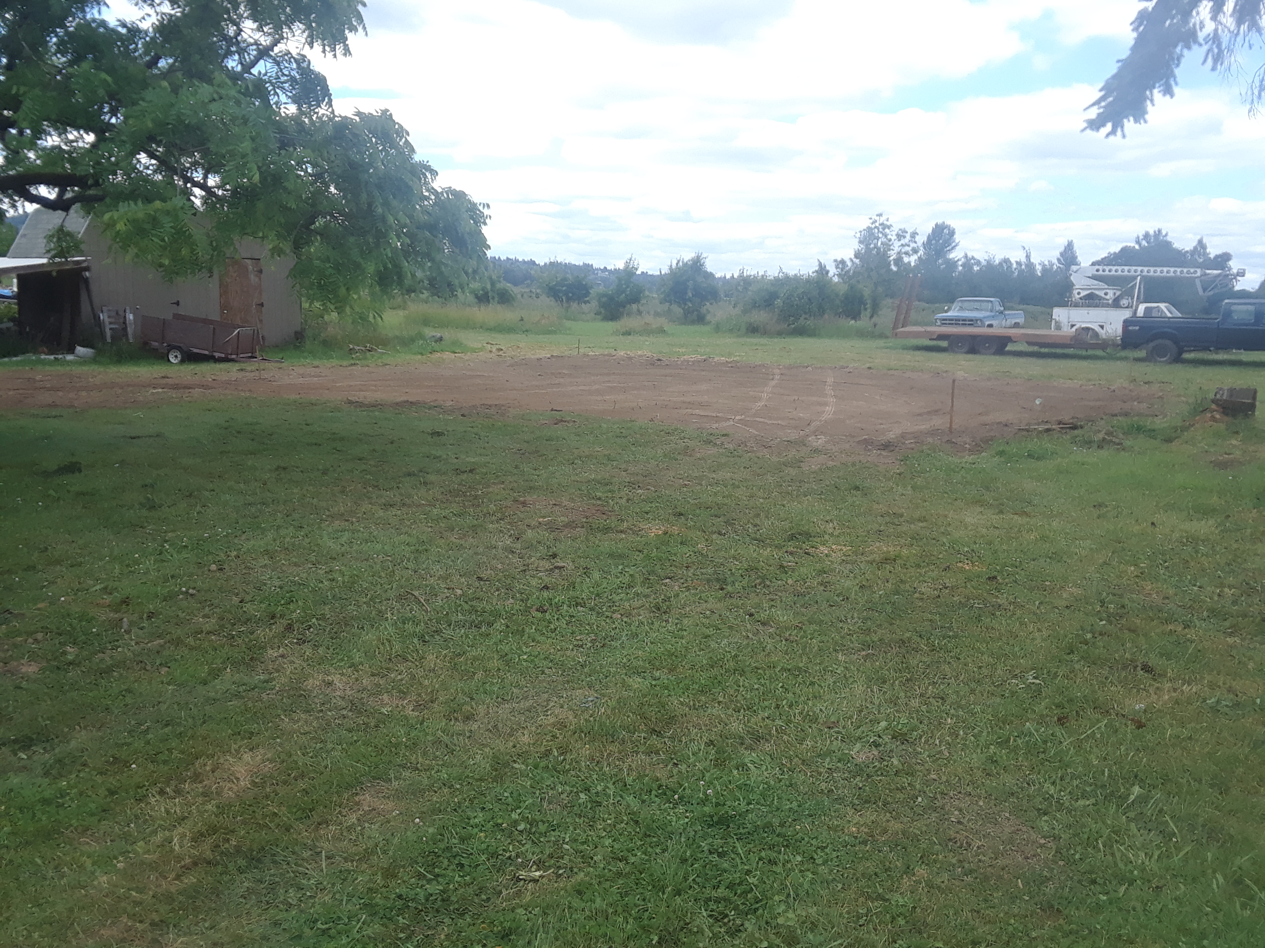

Here's some pictures of where I got to this summer and where I ended this weekend... The picture with the 4600 doing work is yesterday with my brother operating and the picture with the 4600 on the trailer is where I ended this weekend. Have the corners marked (the right posts might be hard to see, they have marking paint on the tops) and everything is within 2" and I have a big pile of dirt to figure out what to do with... I'll drag the transit out next weekend (need daylight, could borrow a laser level though...) to measure again but I imagine being within 2" is close enough, the gravel will need to be better but that's easier...
Seeing the corners marked I need to get the transitions on 3 sides a bit further away I'm guessing... How much space should I have flat away from the building? One of the short walls will be on the right of the picture, there's maybe an 18" rise over about 8'. The long wall toward where I took the picture tapers from floor level to that about 18" level and I have maybe a foot from the corners flat at most. I might be over thinking it though as this is just the lowest level, the plans call for 4" of 3/4" minus gravel under the slab and I'll likely be going with a 5" or 6" slab to use my 2 post lift so floor level will be 10" above that and probably a 4" thick gravel entrance for now...
