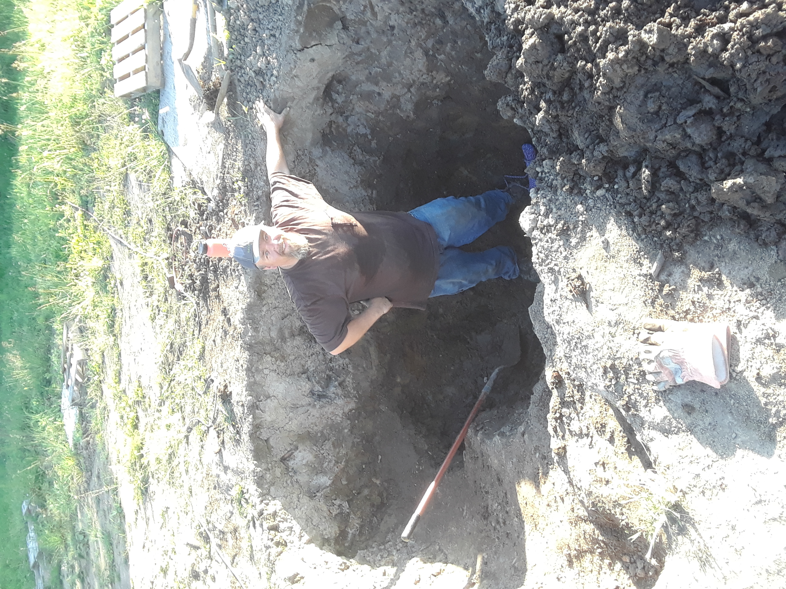

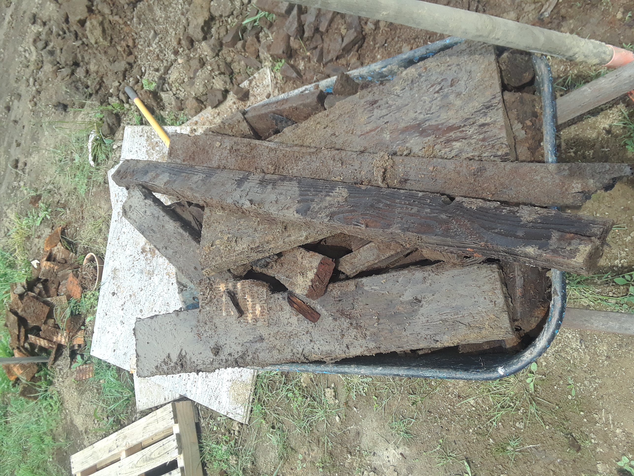

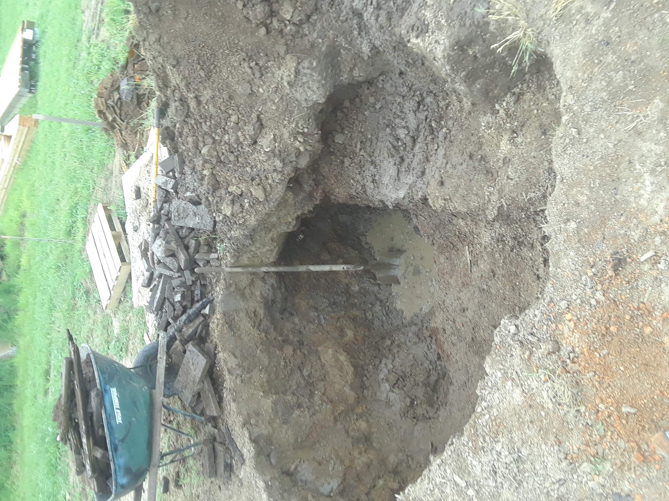

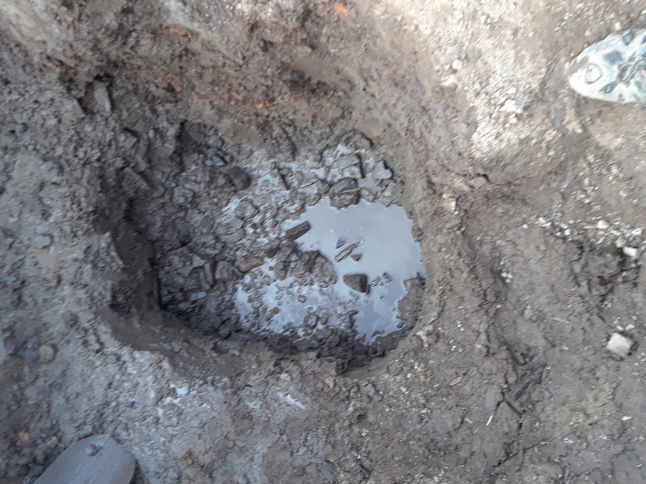

I've given up digging by hand, I'm down 5' and have at least another foot to go, gonna rent an excavator to finish the job, and might as well dig the stumps I need dug...
Few pictures for scale, one of me in the stupid hole, one of junk I've pulled out of the hole (that's one of about 15+ wheelbarrow's), one of the junk floating in the water at the bottom and one of the hole and the little bit of actual dirt I've pulled out...

Rented the excavator, found the bottom of the hole which is about 6.5' deep (haven't measured, but close to that...), I even got ahold of the inspector and I can do it the easy way. Build a wood box for the concrete footing (just go 2'x2' plywood) then fill the rest with 3/4" minus gravel, so that just adds a couple yards to the gravel order to almost 30 yards...
Forward progress! Hope to be pouring the footings for the poles this weekend, then get the holes inpected, then put poles up. I should check into who to get gravel from tomorrow...
