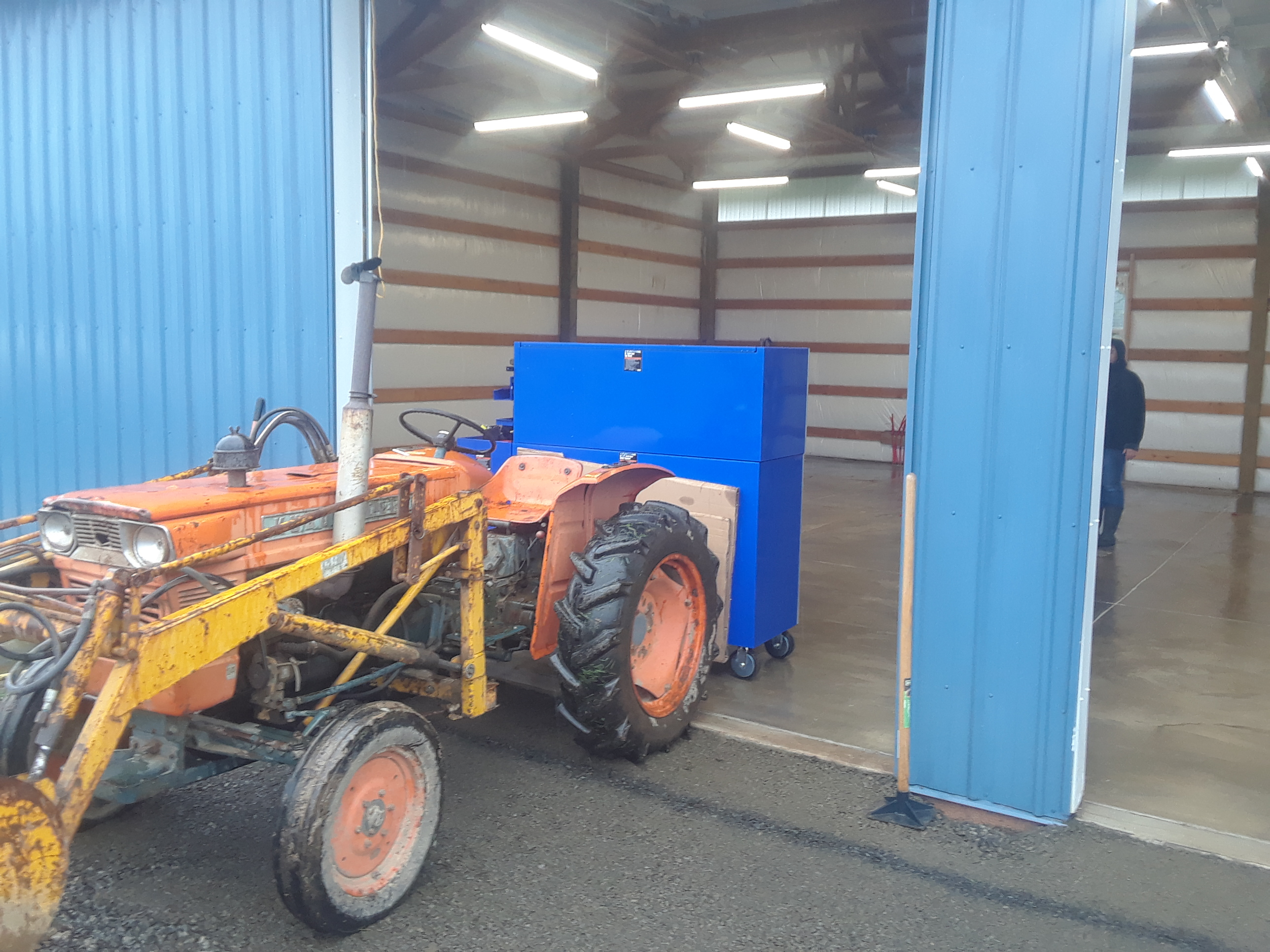

#263
Here's the first steps in moving in, The 3 pt forklift under the tool box in first low with the wife behind worked great for the 100 yard trek down the road to the shop...
I still have to pull the filler tubes for the chain pots and do some cleaning around the receivers...

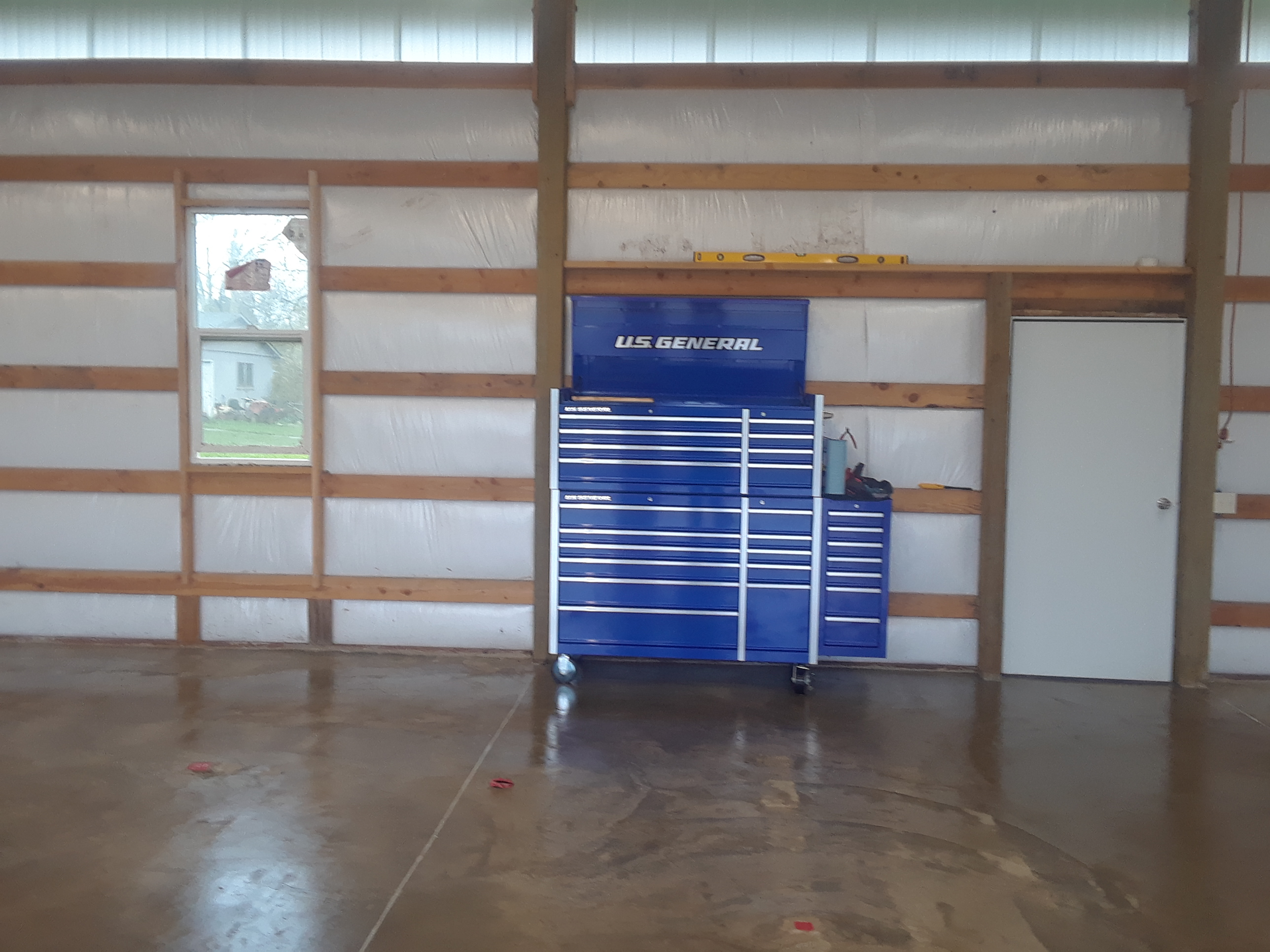

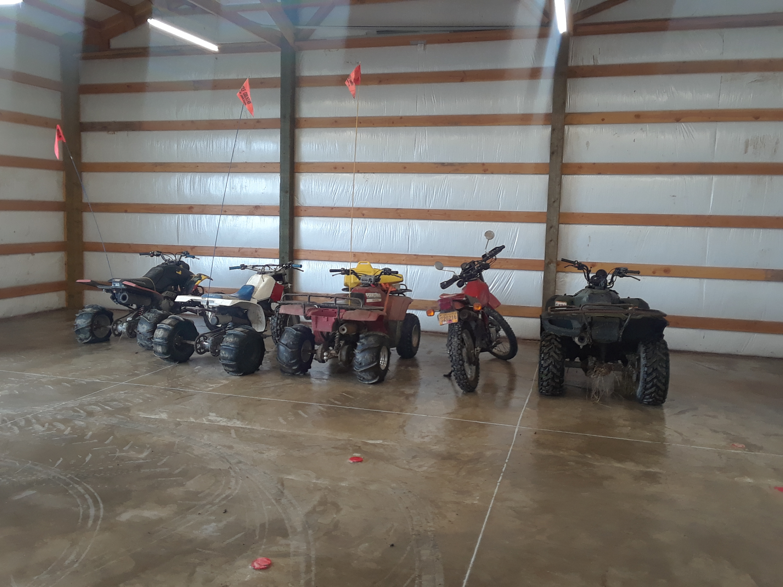

   / New shop build, Doneish but continuing shenanigans #265
Your floor really turned out nice!!!
What are you going to put on your walls so the plastic doesn't get destroyed?
   / New shop build, Doneish but continuing shenanigans #266
#267
Thanks guys.
After the material prices settle down a bit I plan on putting up OSB or plywood, probably plywood, gotta get electrical figured out first though.
