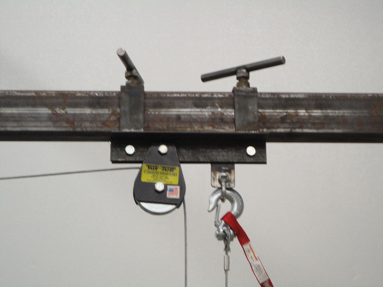

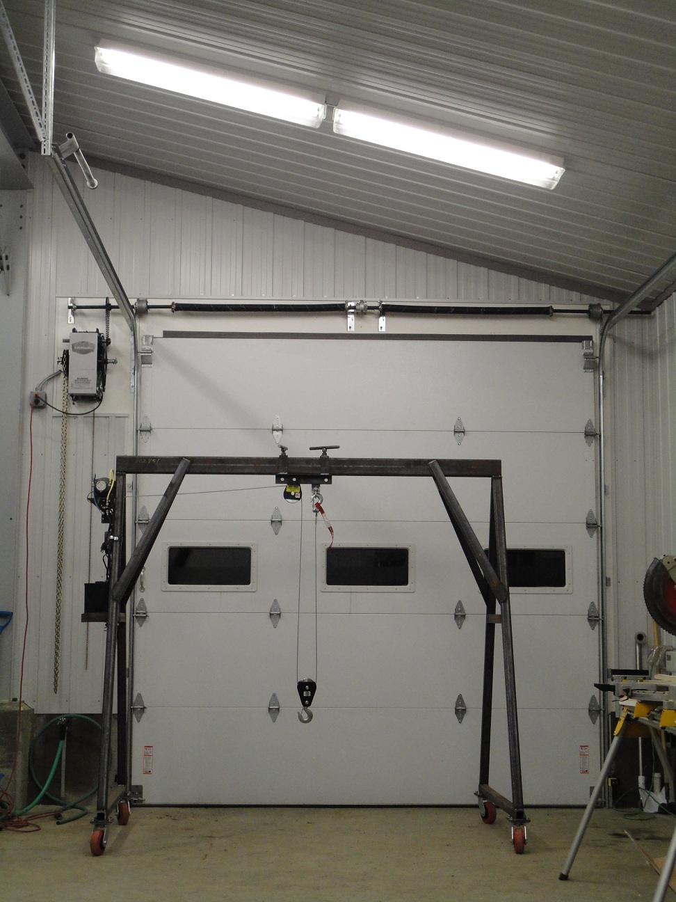

I was wondering how you handled that chore. Any pictures on the crane?
The bridge crane.
2x2x1/4 tube for the A frame 2x4x1/4 top cross tube and 2x2x1/4 angle for brace. 6 inch poly caster wheels rated for 750lbs each, 2500lb Warn ATV winch, truck battery and battery tender.

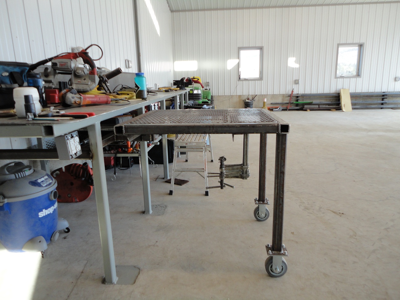

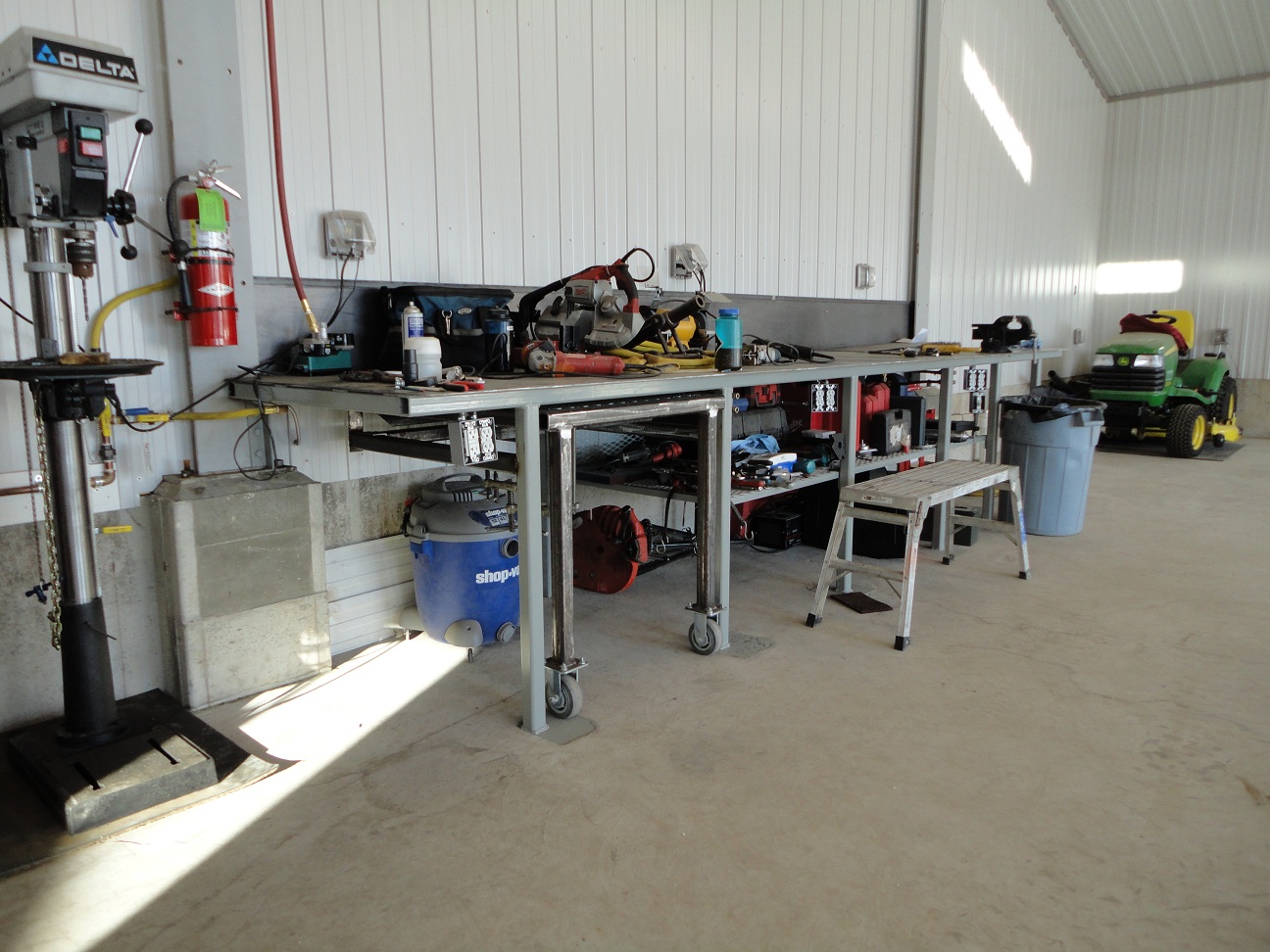

Started the bench today all the same size tube 2x2x1/4 with 1/4 inch plate for the top. welded to plates that were poured into the floor.

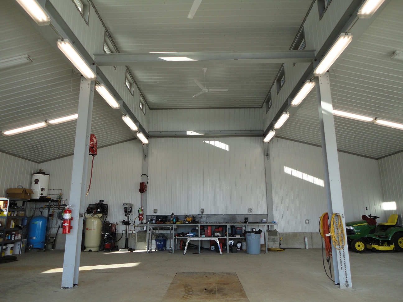

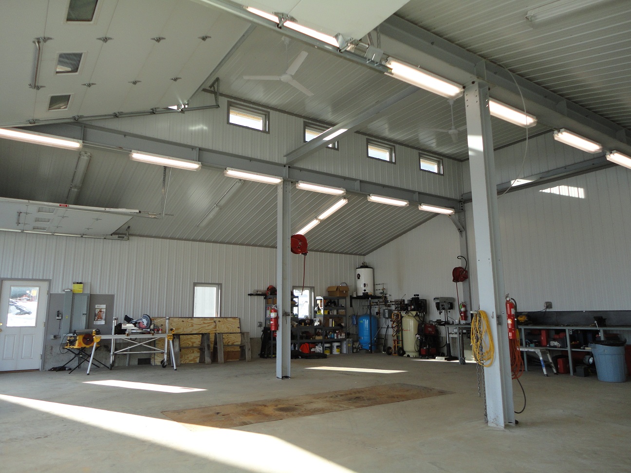

It cost a little more to build with the steel frame. The way I desigined my shop it would have had many more posts between the bays. With the steel frame I only have one post on each side in the middle and the building is much stronger. May put in a overhead cran system latter.
I have nothing bad to say about the steel frame, it worked and has come out just as I planned.

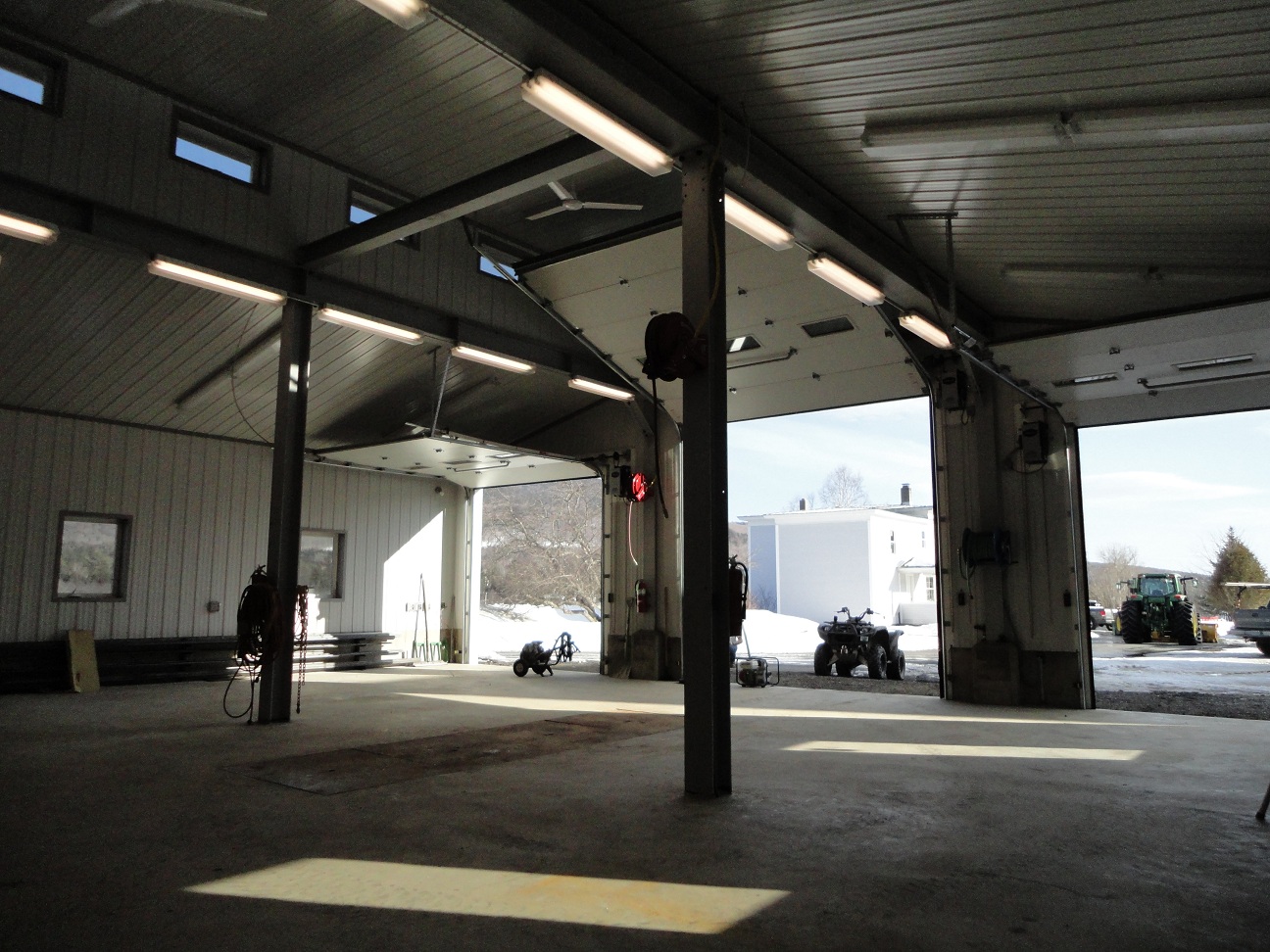

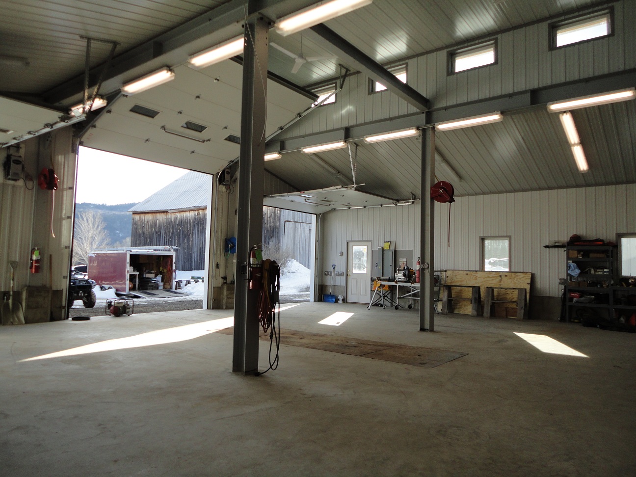

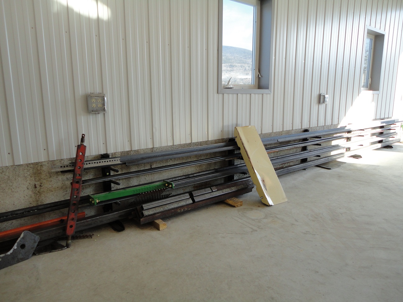

had a warm day and got the new shop all cleaned out.
Got the bench all done with a pull out welding table and racks for full lenght steel.

I like the clerestory windows and the metal paneling inside. Sure makes for a bright well lit shop area.
