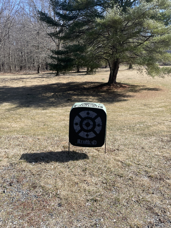

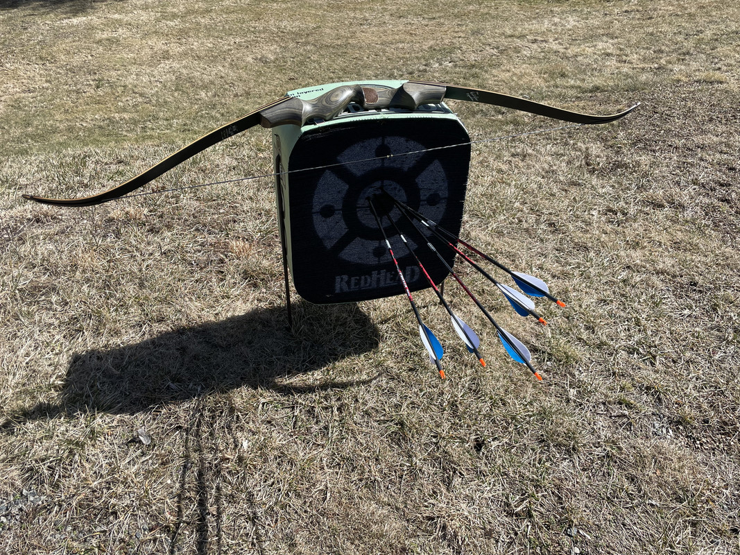

Quick and dirty project
After shooting the recurve today w the target on the ground, it was time to take (make) a stand.
1) light/minimalist/ few
Parts but sturdy
2) durable/weather- able
3) quick setup
I have a bunch of titanium rod kicking around. I haven’t used a piece in the 10 years it has been sitting there.
So 1/2 x6’ piece cut in 2, sharpened and 5” bend at one end.
Stick it in sides of target and lean on target to set.
Worked perfect for what I needed.

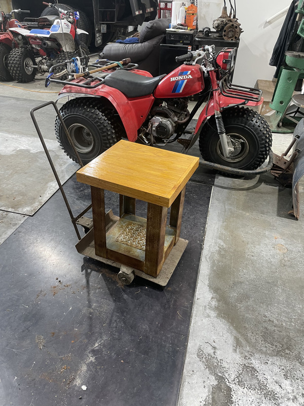

It is a bit of an upgrade from my 200??lb Peter wright
I think I posted the redone stand, if not, here it is 2”lamanated oak top over 3/8 plate. It did well for the 200 lb. I liked the patina so I just clear coated the base. I will have to affix it somehow once I see how loud it “rings”
