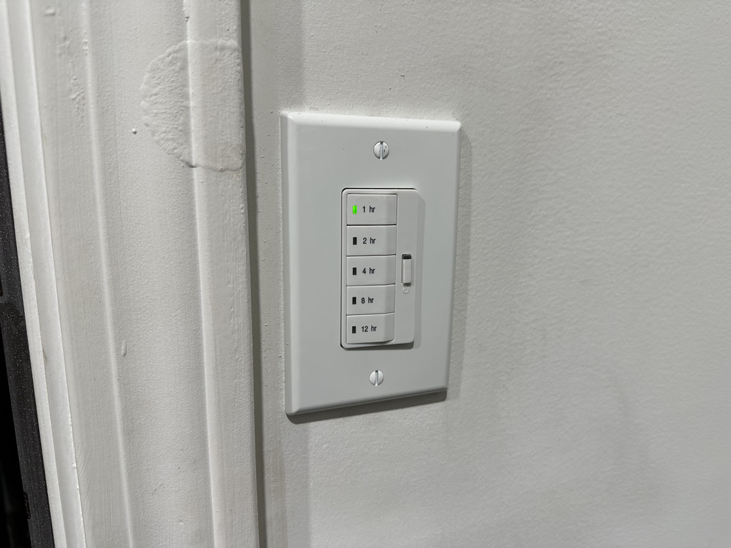

I need to figure out what sort of timer would control 220v, 30??amp
@plastikosmd - I've installed a few different versions of timers / remotes for my brothers shop -
Both used 2-pole 240V 40 Amp Contactors with 120v coils (similar to this Contactor). Then for the timer circuit I just used a 120v 2hr - 12hr push button timer (similar to this Timer) to control the Contactor. Basically press the timer button from 2 - 12hr it energizes the coil in the Contactor & the compressor is only powered for that amount of time.
His other compressor is installed in a separate room so for that one I used the same contactor with a wireless remote switch / relay (similar to this wireless unit) to control the Contactor. So, this does not have the timer feature like above but we installed the remote switch right next to the light switches in his shop, so it easy to remember & he has control over the unit without walking all the way around the shop (Bonus was I didn't have to run any additional wire:))
Oh, I know they say the wireless units are rated for 30Amps but I was more worried about the start-up inrush amps the compressor required, so for the couple of dollars the Contactor cost, I felt it was worth it.

Thx guys, dlctcg = that may work for me
