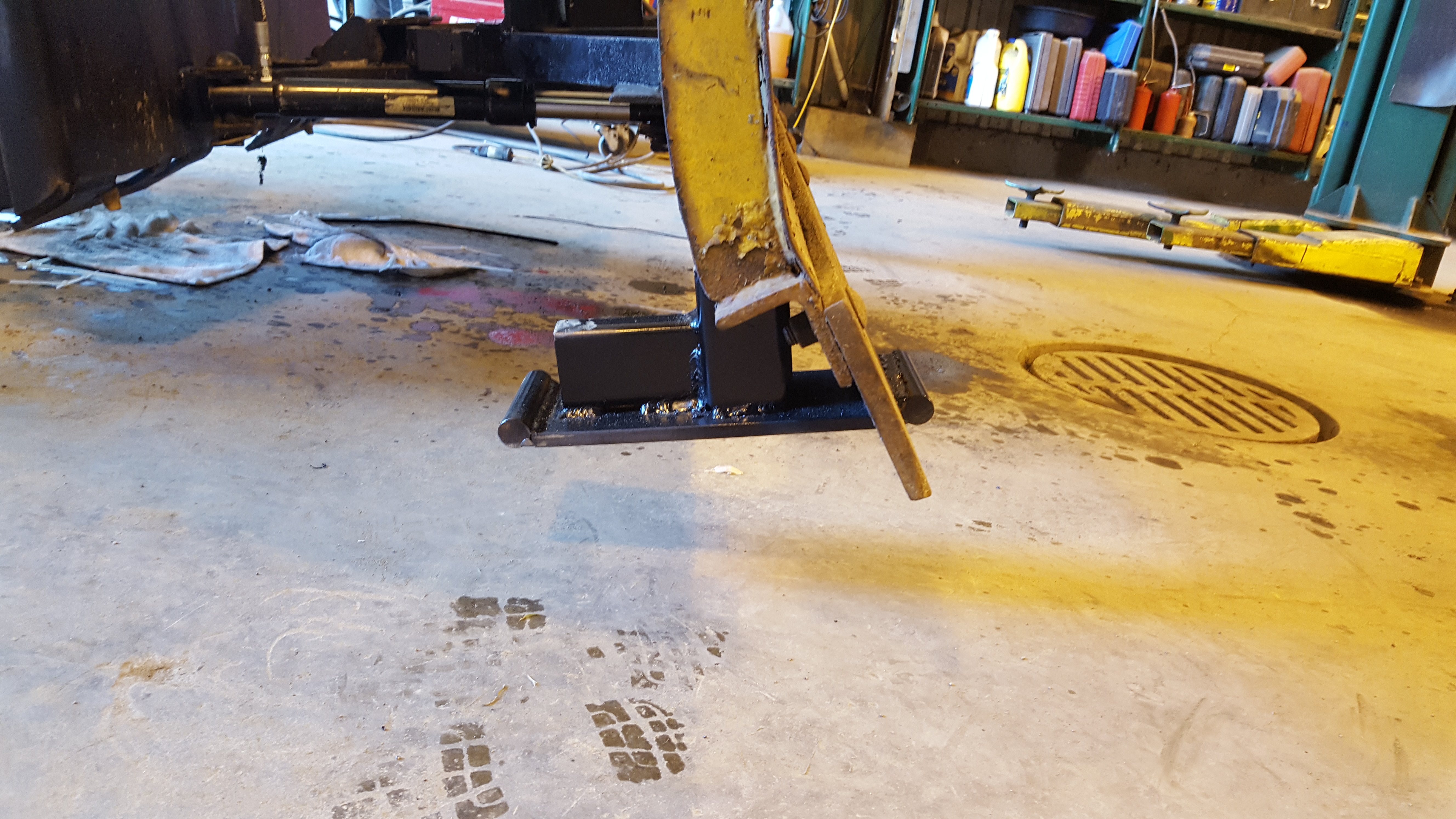

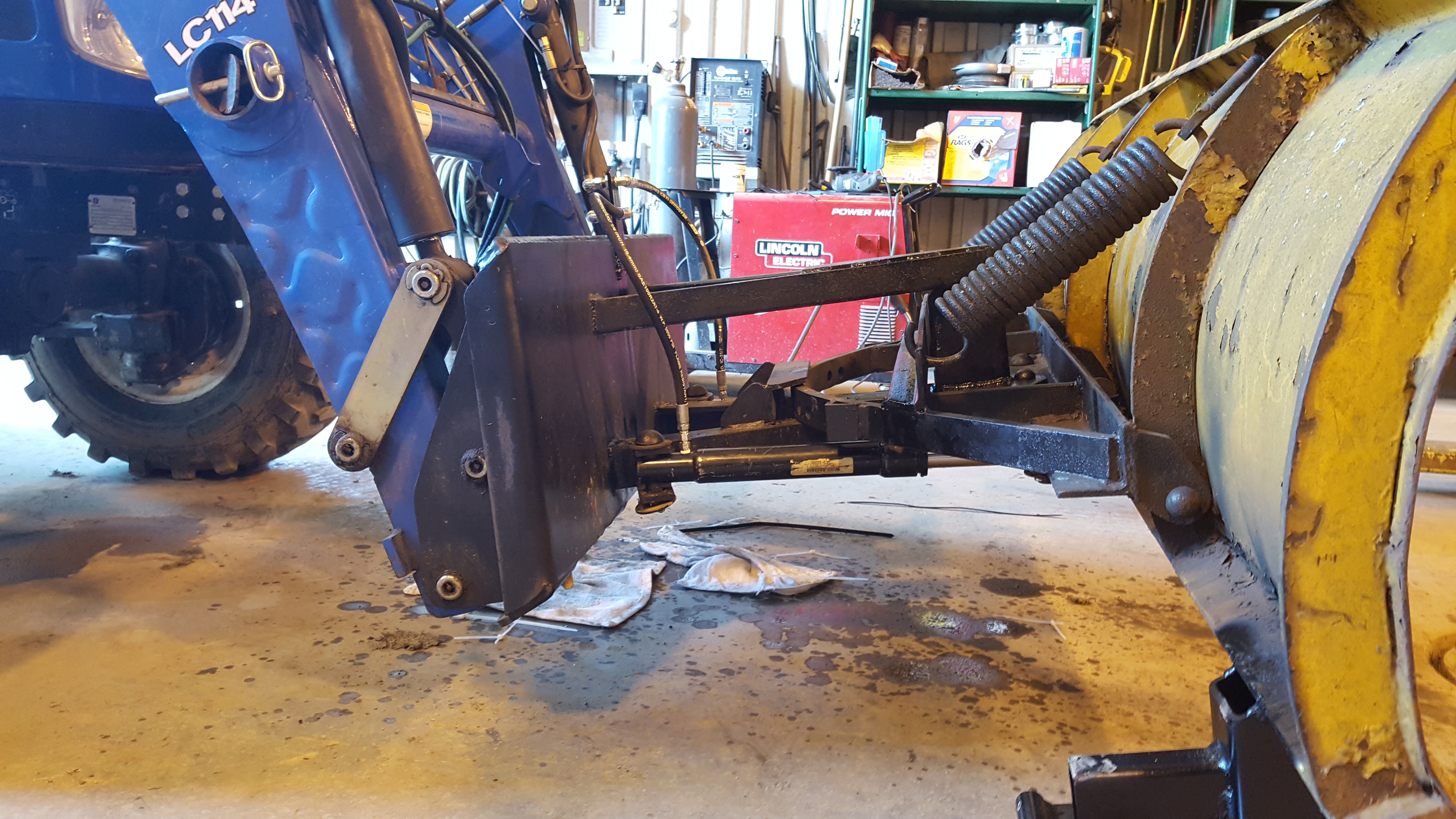

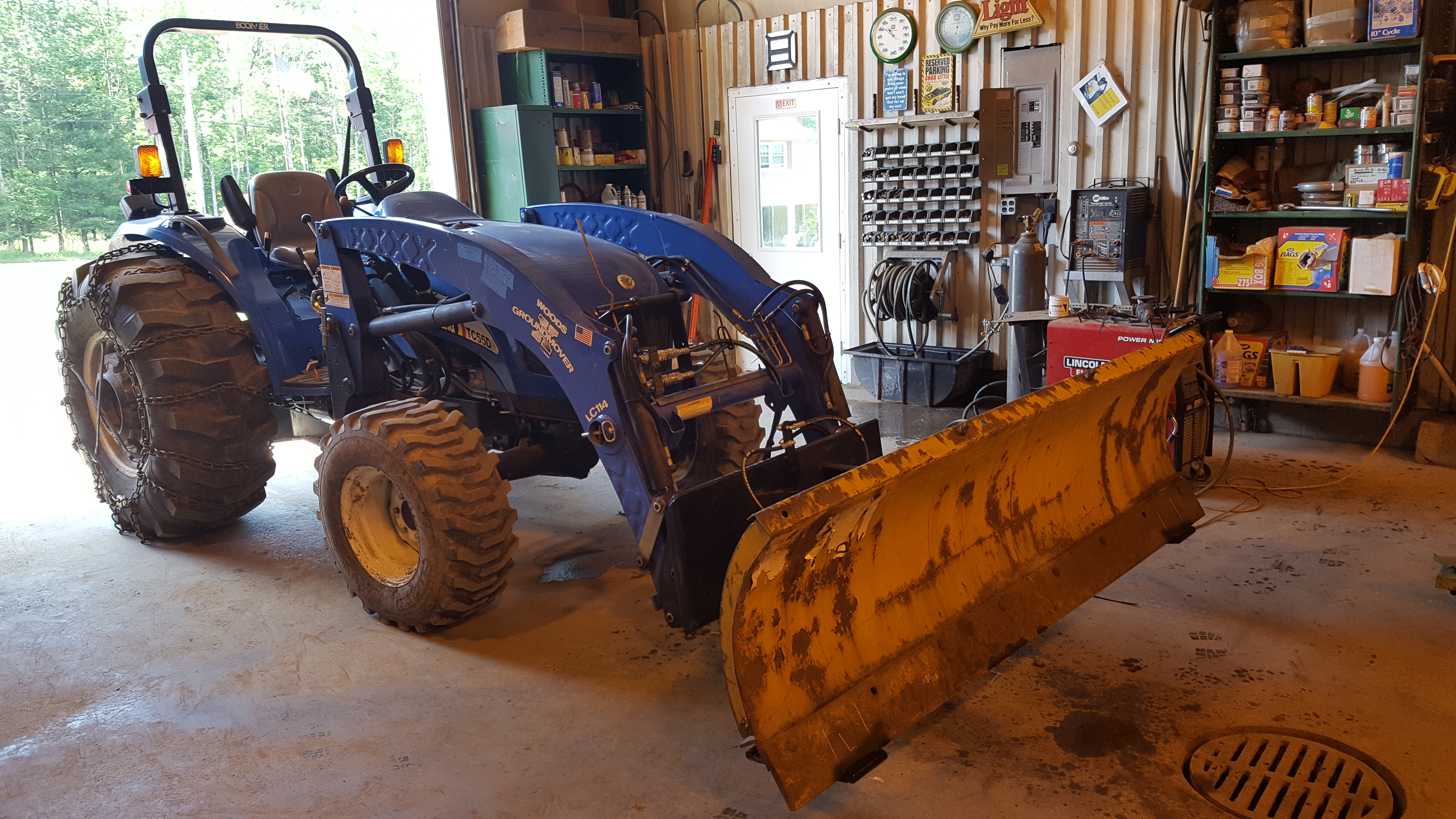

Roy, I didn't think I had any pictures of my friends snow plow that I mounted last year. I do have some and here they are. He brought it back this spring and I mounted the larger shoes on the blade. They were approx 8" round before. He has gravel driveways. Just for reference.
