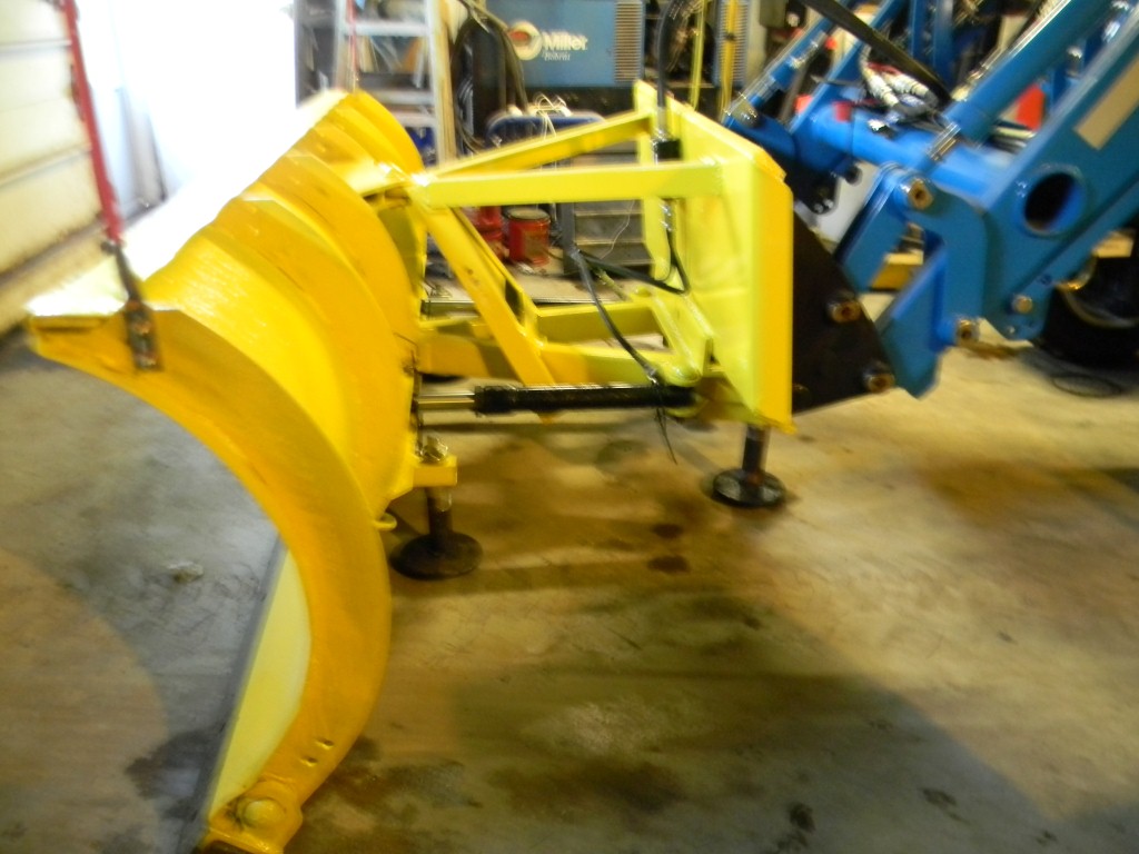

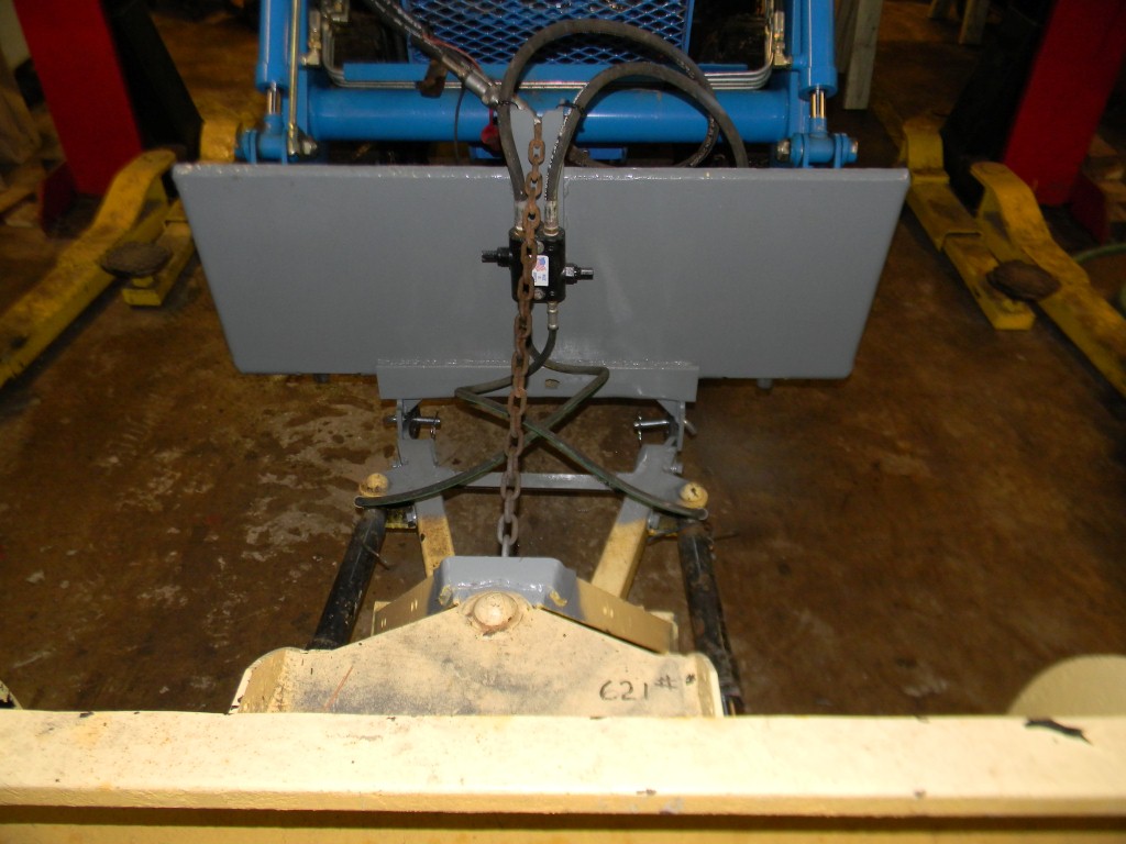

So i bought this new snowplow for my Kubota 2650 skid steer attach.. it is an Erskine 7 footer.. NO OSCILLATIOIN when you turn it full left or right the opposite side digs in.. i know im gonna hear 'buyer beware" but i thought there would be some give an take....i have rough surfaces to plow and it is stiff as an old goat. Any suggestions?? Has anyone seen any type of skid steer adaptor that would allow oscillation?? thanks
/ new snow plow #2
The A-frame of the plow frame must be level. If not, the blade cutting edge will be lower on one side when angled. Adjust the curl function to get the A-frame level then the blade should swing left / right with the cutting edge even with the ground. Also, does the blade float meaning does it hang from a chain like it would on a truck. Here's a pic of mine. I recently changed mine from fixed / welded to the QA plate to a floating type like on a truck. The pic painted yellow was how I originally built it. The gray painted plate is how it is now showing it hangs under the plate on pins and can float with slack in the chain. The side view shows the A-frame is level. This will keep the cutting edge even with the ground when angling. Post a pic of what you have.

ok, my problem is not tripping..it is how the plow rides over rough surfaces...it does not rise up or drop down from left to right because it is rigid...no oscillation capability.
/ new snow plow #6
MOST plows do not oscillate.
A-frame level and plow will stay level when angled. But uneven terrain side to side....if you want a plow that compensates for that, you need a plow that does have the oscillate feature.

Are you floating the FEL? I have an uneven road and use feet without issue when it's frozen. Trying to figure out what surface would have so much side to side changes relative to the back axle that is causing the problems. I realize it's not tripping. The link had good insight in feet.
