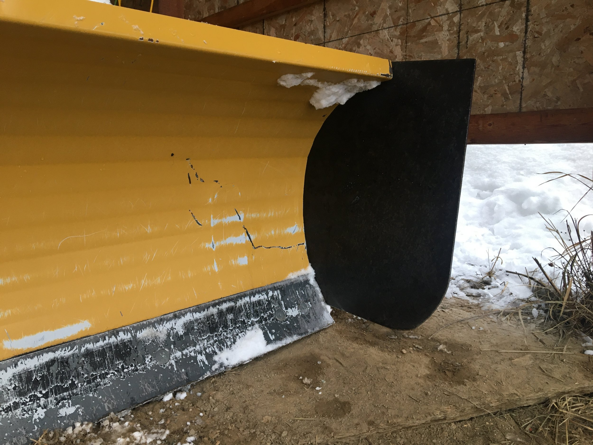

Any chance you could post some photos and info about those side plates on the HLA (?) plow?

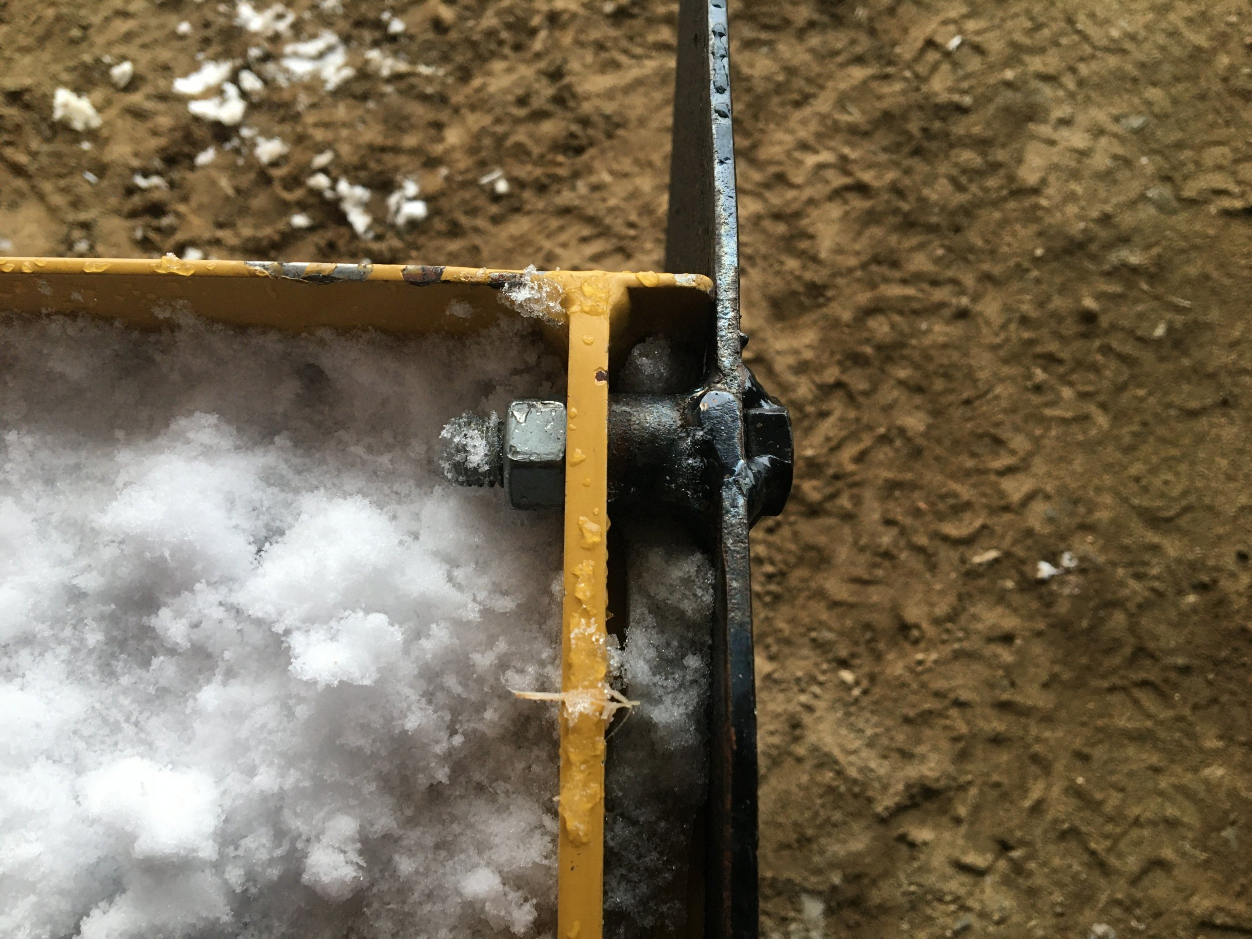

The plow is a 96" HLA 2000 as you guessed. The side plates are something I made to help contain the snow. They work better than expected but I never knew until I took some videos. I couldn't really see how they worked from the seat in the tractor. I think they are 3/16" plate that I cut to suit and just made some spacers to fit between the plate and the ribs on the back of the plow. Then welded some bolts to the plates that just bolt to the plow. It takes a few minutes to put them on or take them off. I've been thinking of making some sort of permanent mount so they just swing out of the way when I don't want to use the plow as a pusher.
Here are some pics.

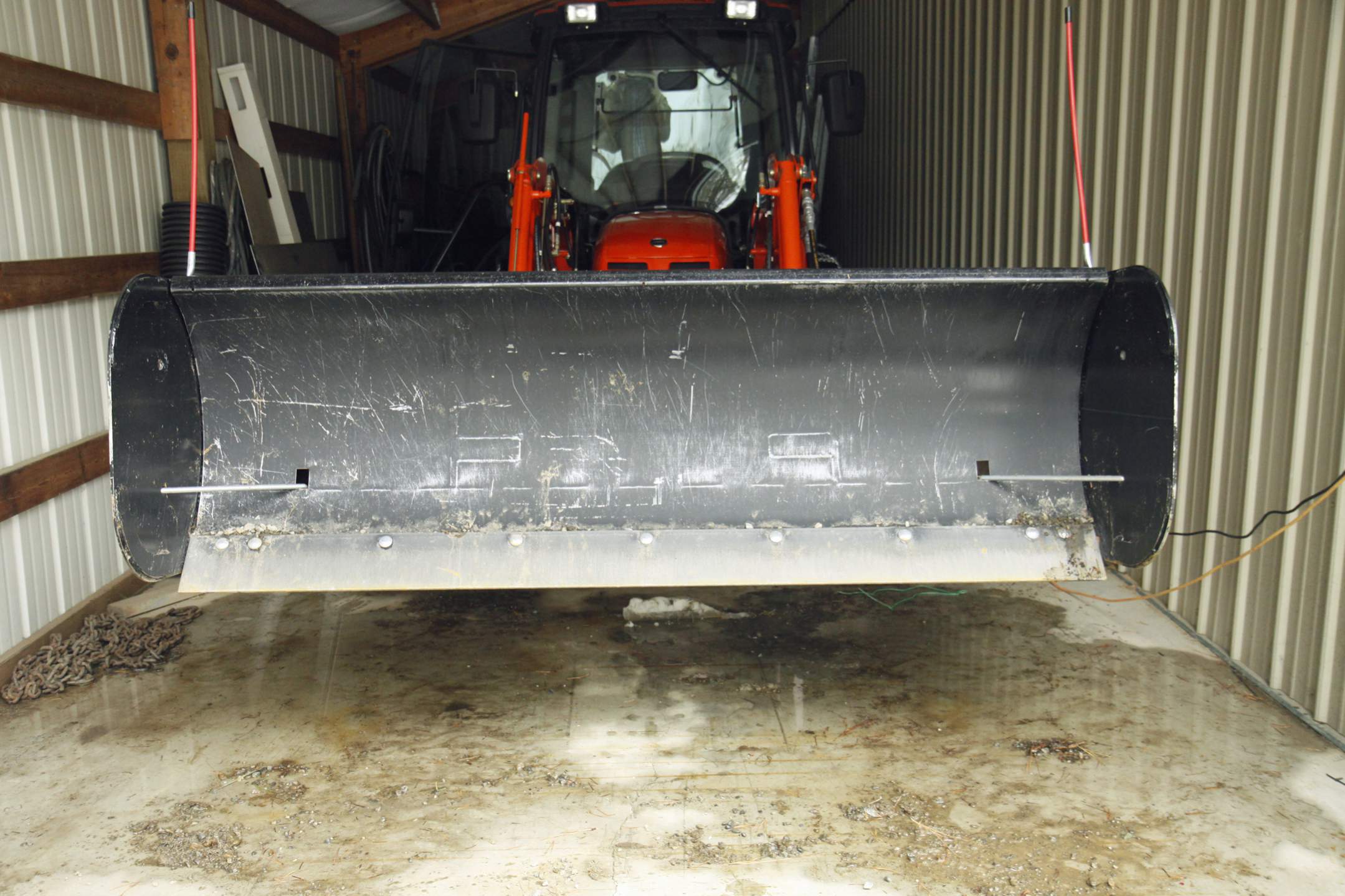

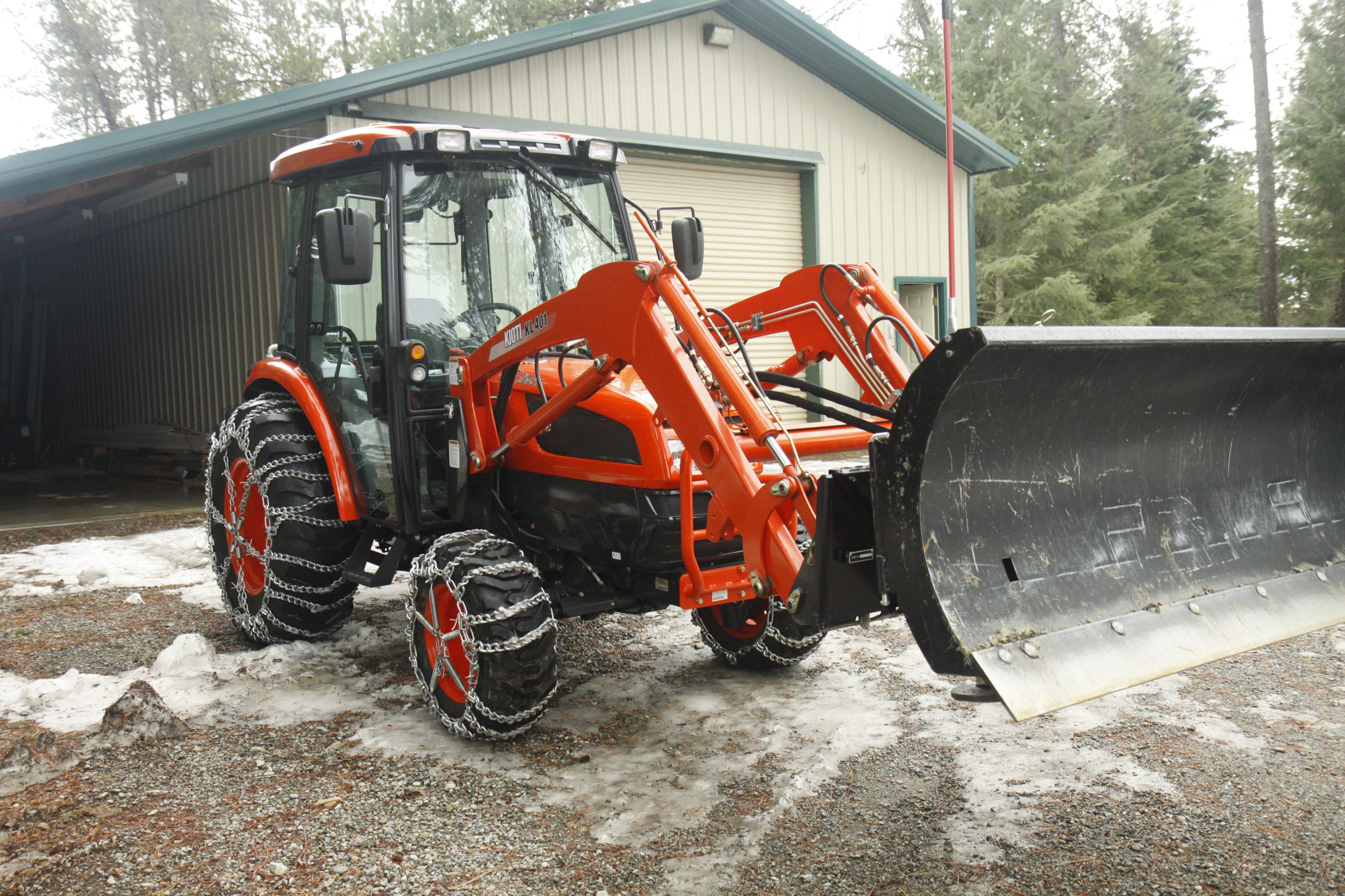

Mine swing out when not wanted. They are pined back most of the time, but come in handy when needed.

Thanks for the pics. Do you have any of the back, showing how it latches out of the way?
