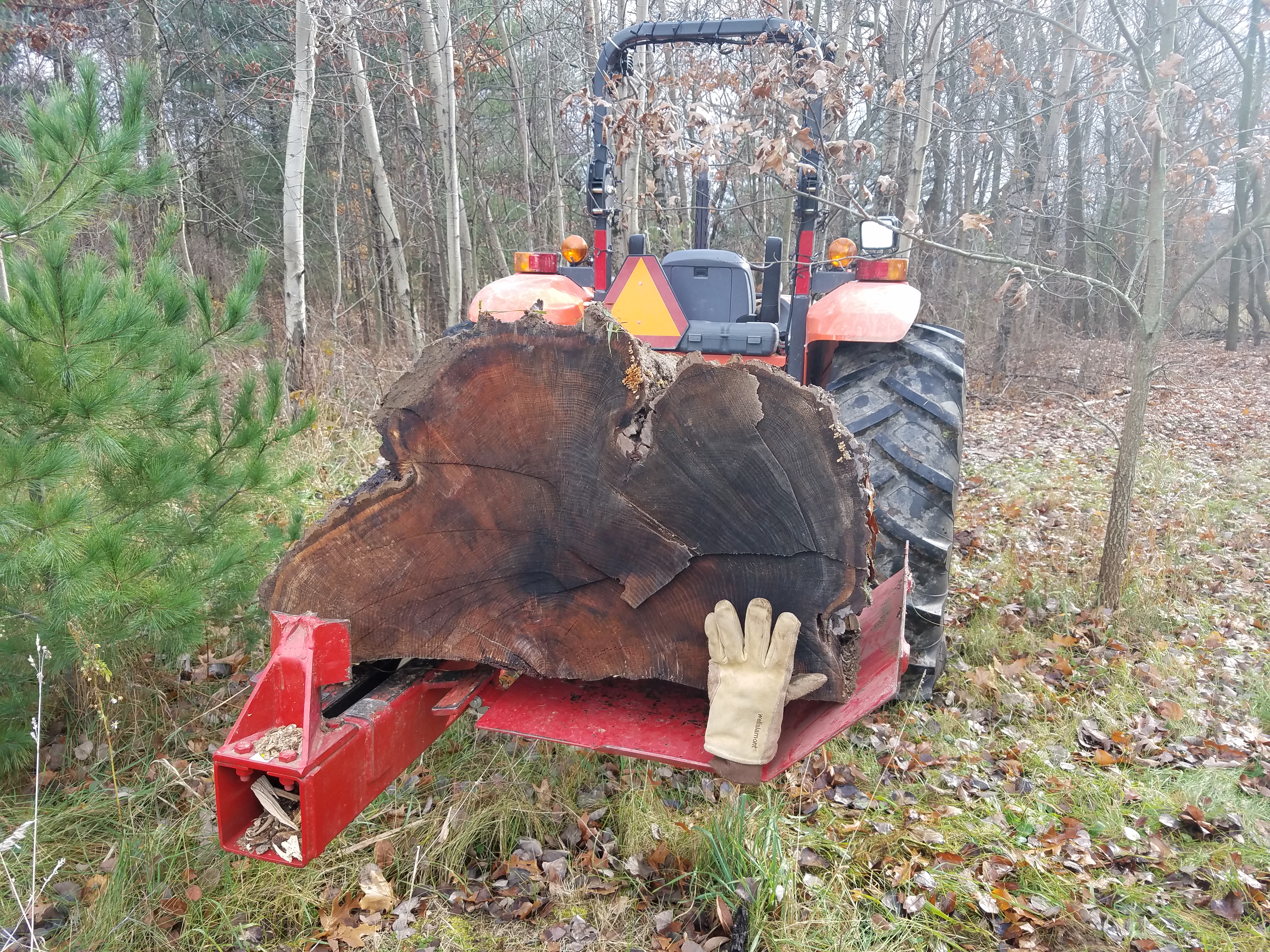

Lift works great and will easily lift and split 30-36" diameter this piece was over 42" round. Insplit it inhalf on the ground
