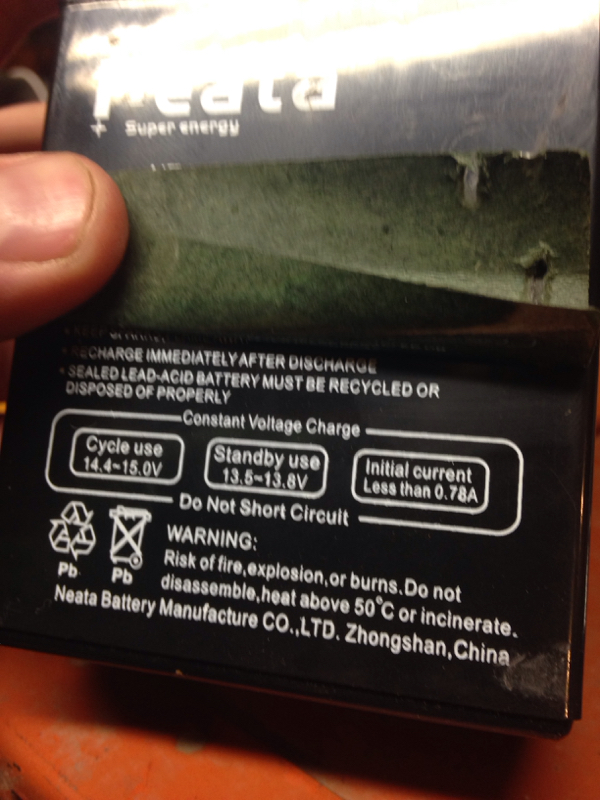

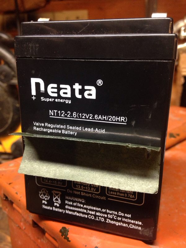

No more looking for a new light, I went back with the attitude that since it didn't work anyway I was being too gentle trying to get the battery out. Turns out it was just dust that had the battery stuck, not corrosion. Digging around everything inside looked good. Not sure what I expected but was surprised to find it used a H3 bulb.
Next I tested the 12v plug and it was bad. Took it apart and found a broken wire. Soldered it up and it's working now.
All it took was 15 minutes of tinkering and I've saved at least $50.

   / New Spotlight
Eddie, with the amount of other projects you have I can understand tossing something as cheap as a spot light.
The problem I have now is that the wall charger won't charge the battery. I've took the battery pack apart but haven't found a replacement yet.
Any ideas?
