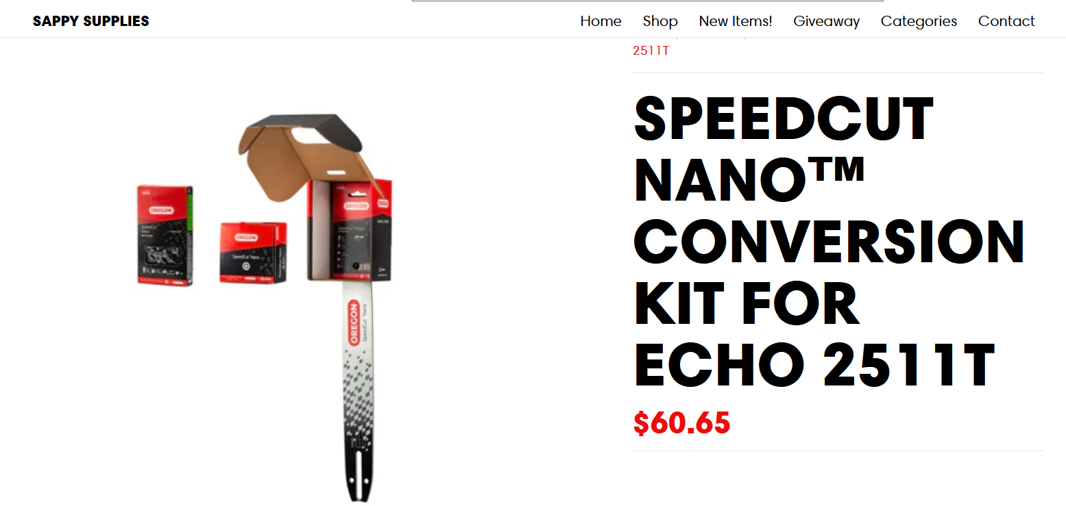

HomeDepot has a special right now but it's on the 0.050/⅜ chain version (DCS-2500T), not the 0.043/0.325 version (DCS-2500TN). Seems like a small saw like this is the perfect case for a nano chain, what's the downside?
I'm guessing the bigger chain version wasn't selling as well. The nano version is currently $160 more because the bigger chain one is on special... wondering if you can get a new bar & chain & sprocket to DIY a nano version for less.
If the 2511t is on sale for $160 less than the TN model that's a bargain. Usually the TN model is only $10 more. I have the TN Nano chain model, and it cuts faster and with less chatter than the stock chain.
You could buy the stock version and get teh Nano kit later if you wanted to.
