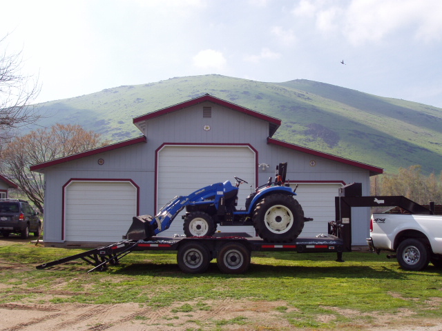

epete,
That's a nice looking home you have but your roof is not a shed design, it is basically a gable roof. A shed roof is half of a gable with no ridge line, as in the diagonal edge of a right triangle. A shed roof can either completly cover a structure from top plate to top plate with a single or multiple sections of full length mono pitch(s) or extend off of ninety degree walls. Probably other applications but these two are the most basic.
This is an example of an upper gable and two lower sheds.
