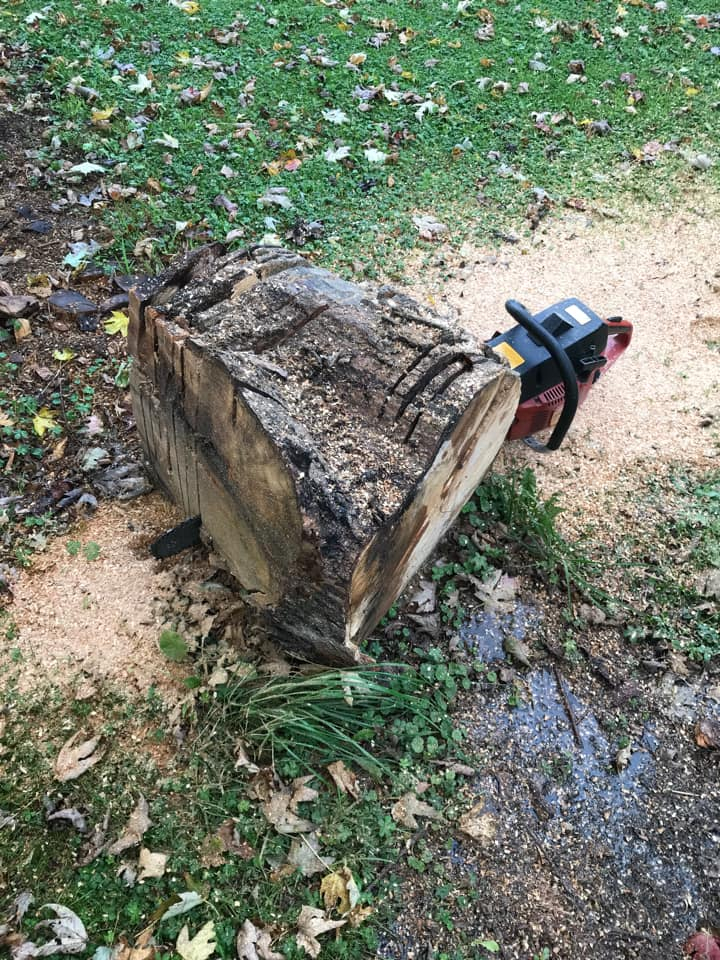

I have had 2 Stihl saws, a MS 250 and a newer MS 261. I have a 18 inch bar on both. The 261 easily pulls an 18” bar, the 250 not nearly as well. I’m pretty sure a 261 would pull a 20” bar well also. If you need bigger than a 20” bar, than I’d step up to a bigger saw.
The pic is some “noodling” I did with my 261. With a sharp chain it cuts really well. I noodle the bigger stuff so I can lift it up on my splitter, it’s horizontal only.
