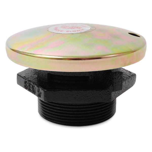

The cap on my bulk tank is a round one that looks like a giant gas cap and, if I recall correctly has a 3 or 4 psi thing built in to provide a degree of tank pressure. It was $10 or so and I've had it for years so it works.
Looks like this but this pic has the screw-in tank adaptor attached.
I see them at farm stores all the time and never gave it a thought for this thread.
