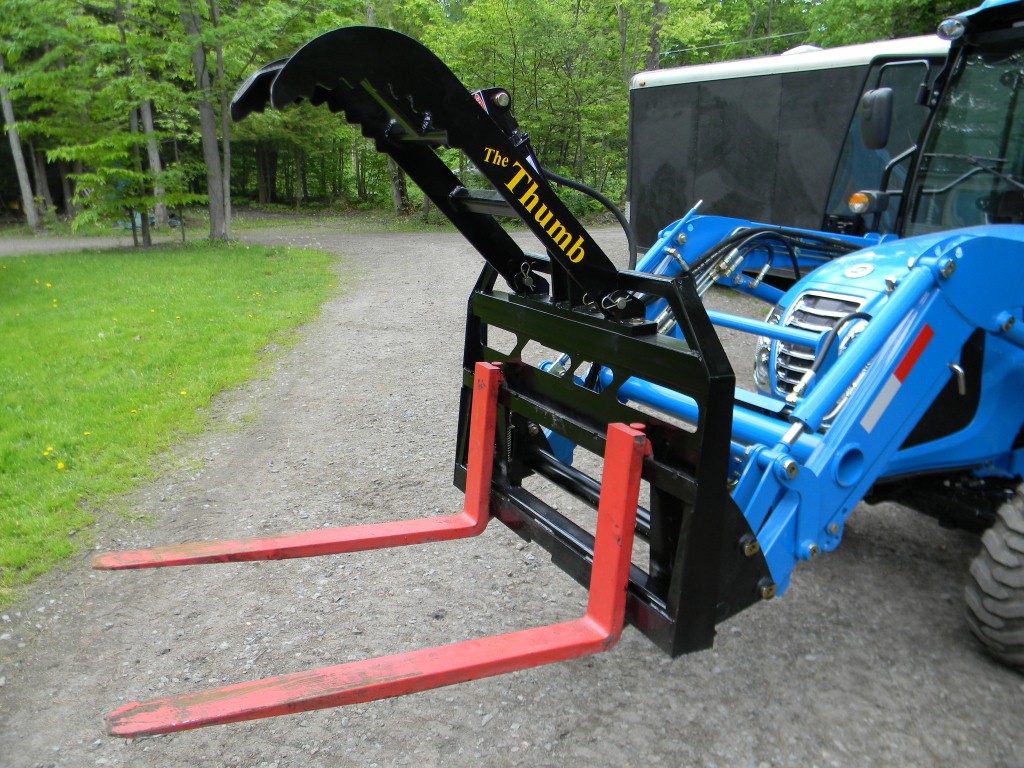

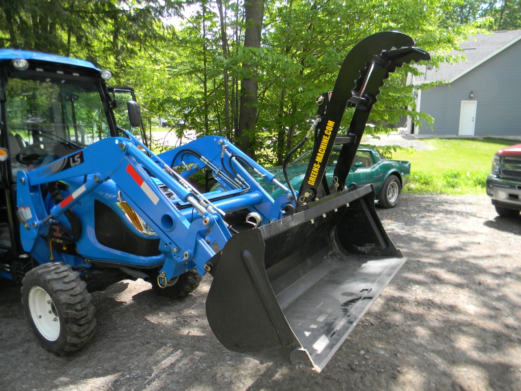

Finished installing my thumb.
See all the pics in the Attachments thread post Added a thumb.

Very cool...looks super handy. Did you add the reflective strips to your loader arms? That's a really good idea I'm going to have to copy. R,

Yes I added the tape to this tractor and my previous one. Makes it easier to see. I have reflective tape on the side of the cab below the back side windows too. Picked it up fairly cheap at HF. I use it on all my trailers too. I like to be seen and not hurt. You can't have enough lights and reflective tape.

Very cool George! I just showed it to my Wife, she said "GET IT". Hope you don't mind but could you answer a few questions? Looks like the 36" ? Does it go compleatly verticle when retracted? And if you could describe how much travel from retracted to fully open? Thanks :thumbsup:

Look at the pics I posted. They show the thumb fully up and down on both the forks and bucket as installed. Hard to get more movement with a cylinder that only has a 6" stroke. The problem with a 6" stroke is you can't get the thumb fully vertical and close enough to touch the bucket or forks. I did get the 36" mainly for use on the forks. I am going to change the thumb mount angle on the bucket so it will close more.

No, a longer cylinder would make it close more but open less. The only way to make it open and close more would be to change the pin position where the cylinder mounts. I am going to look at that tomorrow to see if I can drill holes lower on the bucket thumb mount bracket to move the cyl. down.

Very nice George2615. I installed "The Thumb" on my R3039 last year also but had to modify the bucket to in order to get the correct angle.
I like the idea of mounting the thumb on pallet forks as well. Did you buy an extra mounting plate or just swap the entire unit out when changing over?

Ball Ground, I did buy the extra mount plate. It would be easy to swap the entire unit by unbolting the 4 - 5/8" bolts but about 25-30 lbs. heavier. With the extra plate I don't need any tools to swap it and it's a little lighter than with the base plate.
