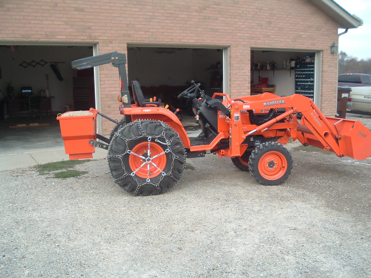

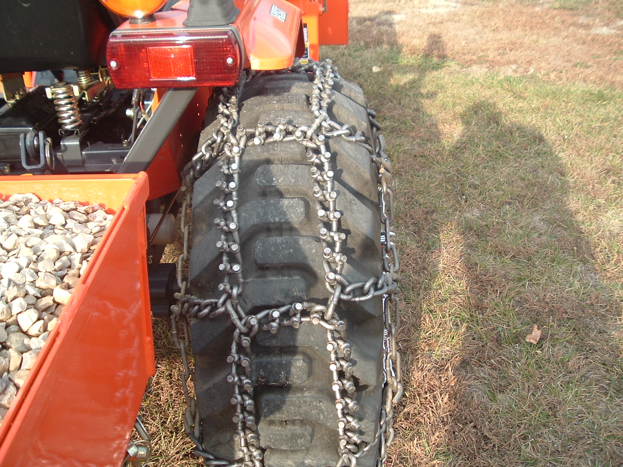

Once you have tried chains you will never go back. I like the tensioners. I like things snug and tight and not rattling around.
   / new tires or chains? #30
Hi Whistlepig, how's the ride with those chains of yours? Do you ever drive on a paved road with them? I live on a paved road and I would think that style of chain would produce an extremely rough ride. What are your thoughts?
