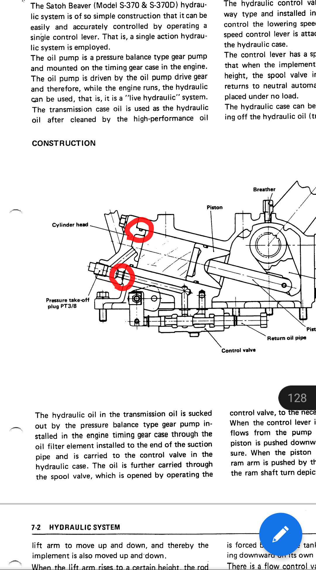

Hi all, I picked up a new to me Satoh S370D a month ago. It wouldn't start so I pulled the head and found a cracked rear piston and seized rings on the front piston.
I replaced both pistons and rings after lightly honing the cylinder bores. It started right up after and seems to run great and everything works.
It came with a Woods RM48 finish mower and 48 inch Berco snow blower, FEL and custom cab.
I do have a hydraulic leak coming from the 3 point piston cylinder head. I'm thinking it's likely the o-ring. Anyone happen to know the size?
Thanks
Jeff
Thanks
JeffView attachment 759403
At the top of this section is a pinned topic. Download the helpful PDF there for your machine.
As for o-rings, Buna-N or Neoprene are the two for hydraulic use. Other materials will fail due to not being fluid compatible.
Japan tractors are made to JIS standards, not SAE. With this stated, the o-rings are metric.
