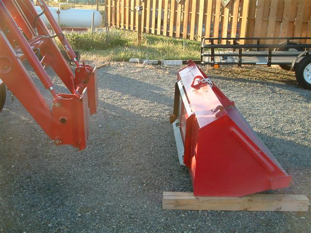

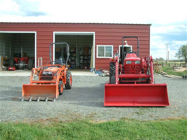

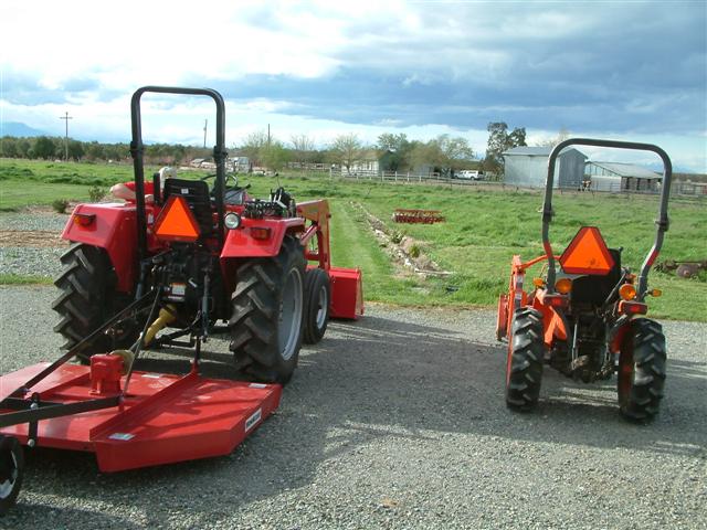

Here's what I use on my 10 acres (6 acre hayfield). It's a 2008 Mahindra 5525 (54 hp diesel engine, 45 hp pto, 2WD, gear tranny 8F/2R, power steering, triple rear hydraulic remotes) with the ML250 FEL (6-ft wide bucket, 2950 lb lift to 10.5 ft height, three chain hooks welded to the bucket by the dealer at no charge, skid steer quick attach option on the FEL arms). Cost: about $19K new.
The little tractor is a 2005 Kubota B7510HST (21 hp engine, 17 hp pto 4WD
hydrostatic tranny, power steering) with the LA302 FEL (4-ft wide bucket, 800 lb lift to about 7 ft height). You can see the size difference.
The mower on the 5525 is a Hawkline 6-ft wide rotary mower (aka bush hog, brush hog, shredder, slasher). The little B7510 could barely handle a 4-ft wide brush hog in 3-ft tall weeds without lugging the engine.
DSCF0061 (Small).JPGDSCF0062 (Small).JPGDSCF0067 (Small).JPGDSCF0110 (Small).JPG
