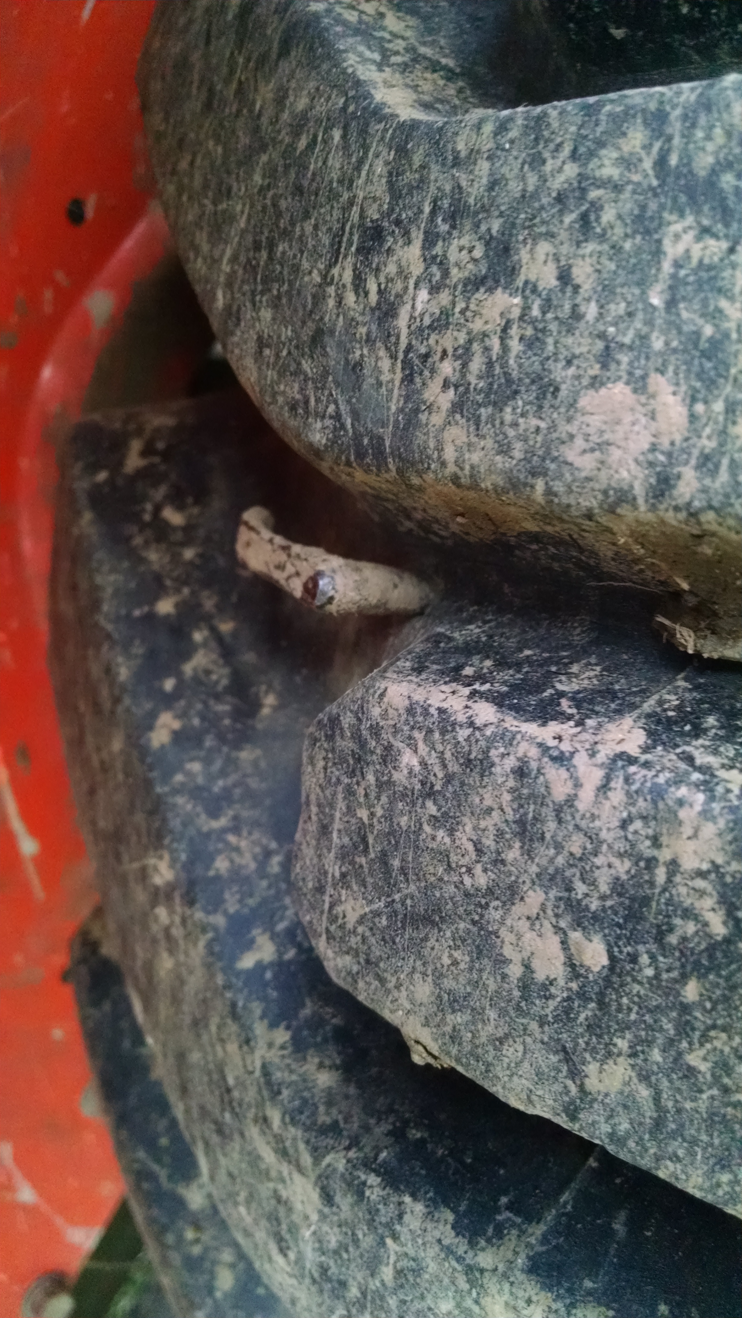

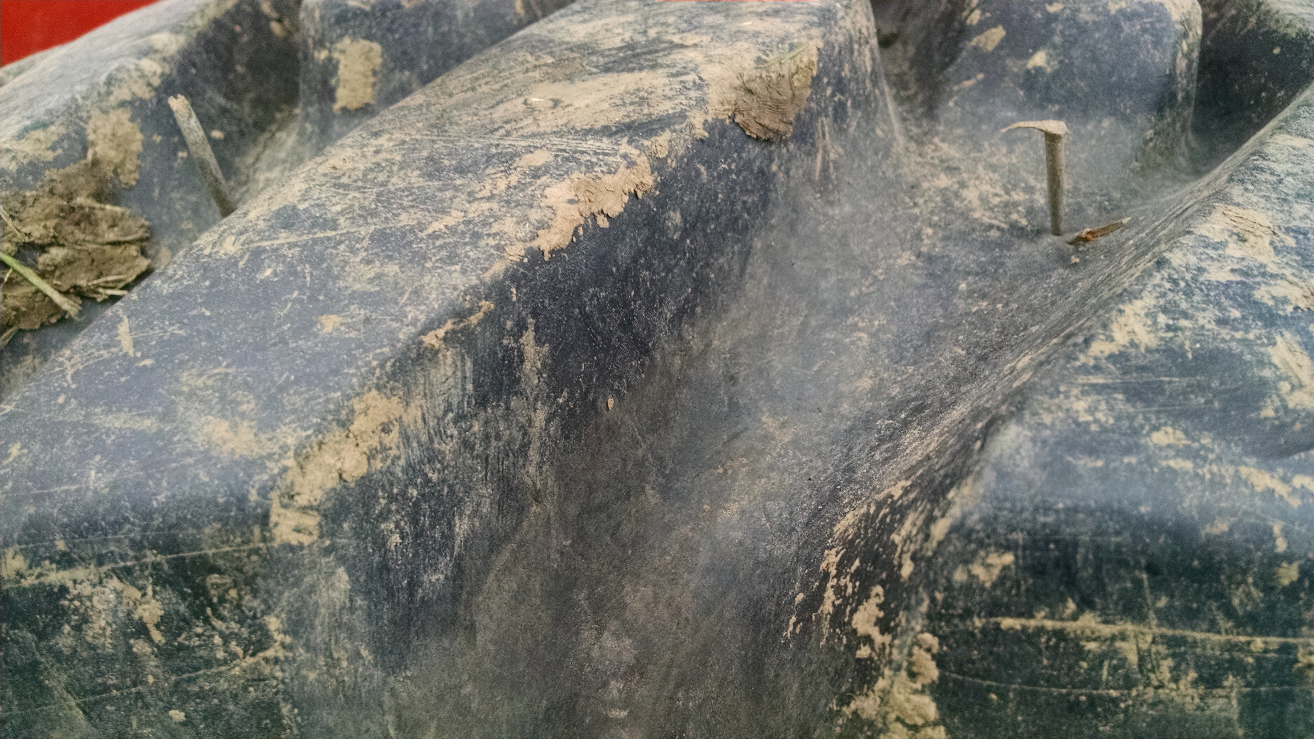

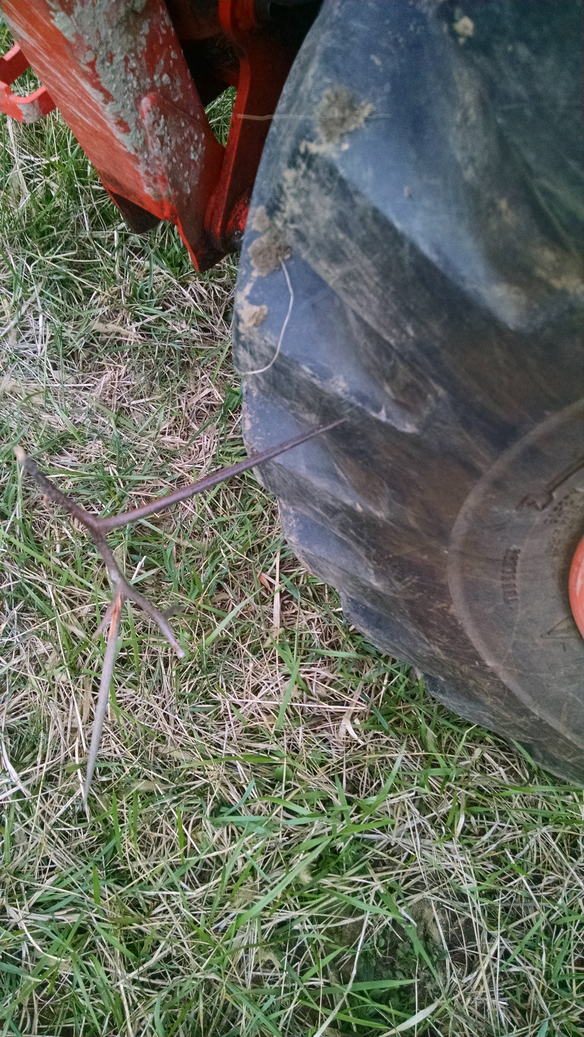

1458595041780.jpg1458595077978.jpg1458595102450.jpg another reason for foam filled tires
