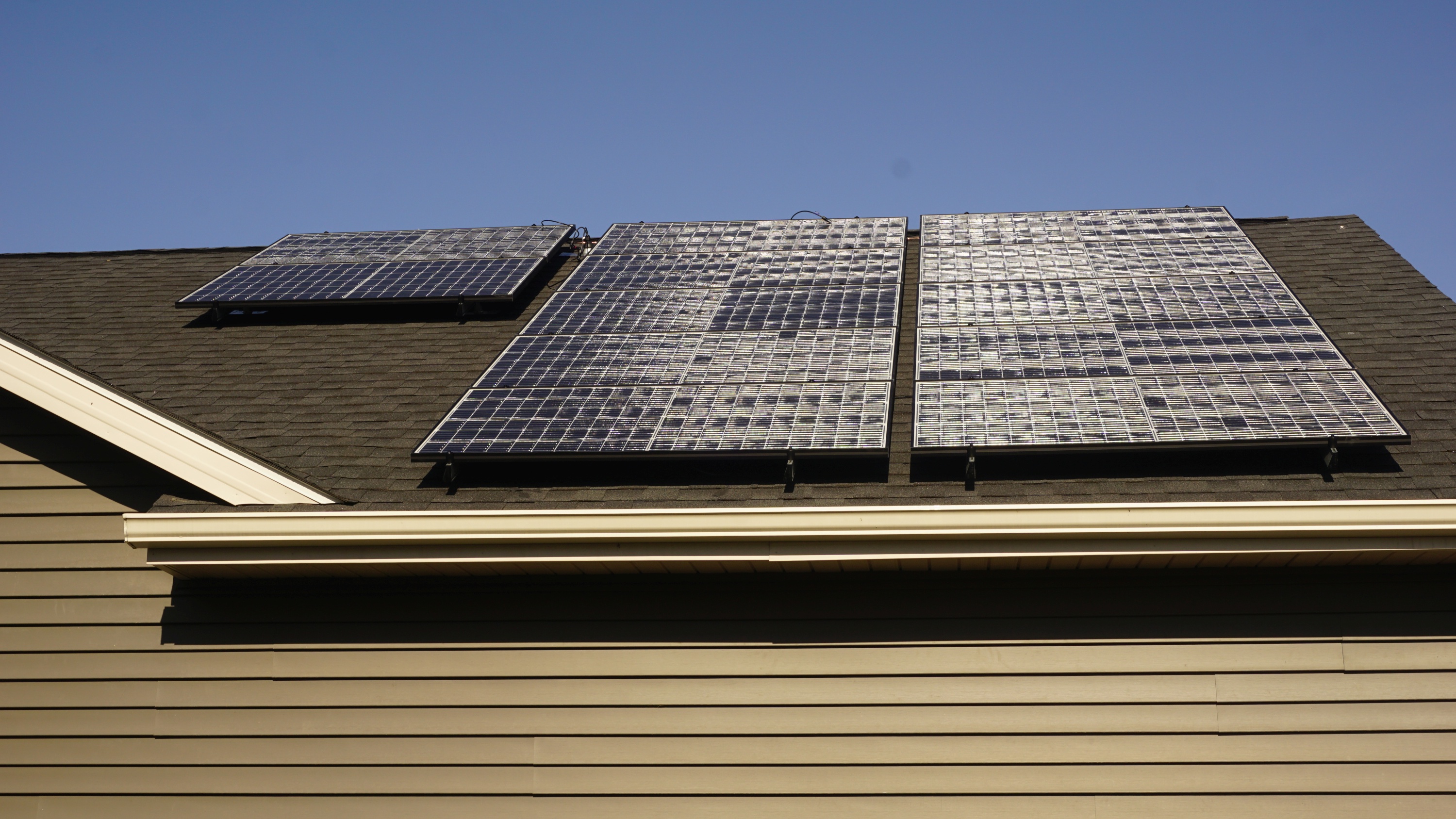

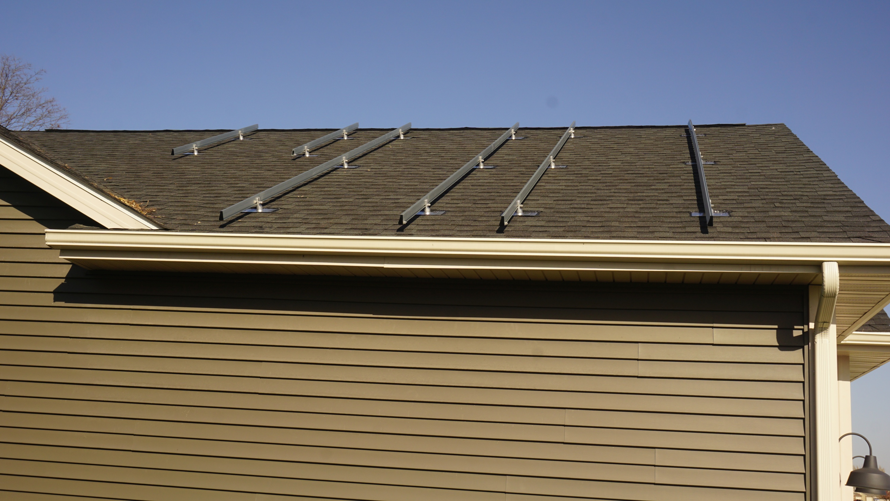

I just put 3.84 kW of solar panels on a house we bought in town. 12 320 W panels to fill whole south facing roof. But I bought 7.7 kW inverter because I see electric car in our future. So we could add another 6 kW on the east facing roof. The total investment in hardware before tax credit was 6940 USD. Our utility allows DIY so I hired a helper (younger guy) for two days to help me with the installation on the roof. The sweet spot of current cost of the solar panels is 320W for 205 USD or 64 cents/W or about $1.65/W (before tax credit) including the, rapid shutdown modules, wiring, racking, breakers, disconnect switch and 5 kW inverter. Tax credit for 2020 is 26%. It drops to 22% in 2021. Estimated break even point (assuming constant cost of electric power) about 7 years.
