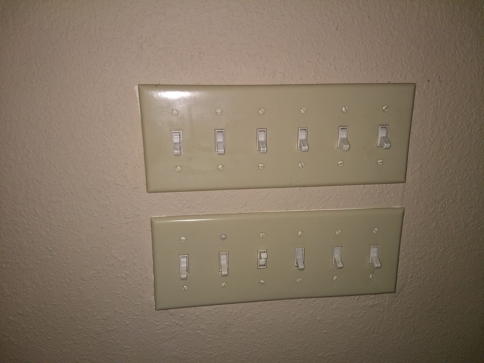

Here is a picture of the wall switches at the front door, one of the 3 irrigation manifolds and a shot of the kWh from the Invertor.

Ultrarunner, that is a TON of irrigation valves. Looks like some irrigation maintenance workload to me!!!
