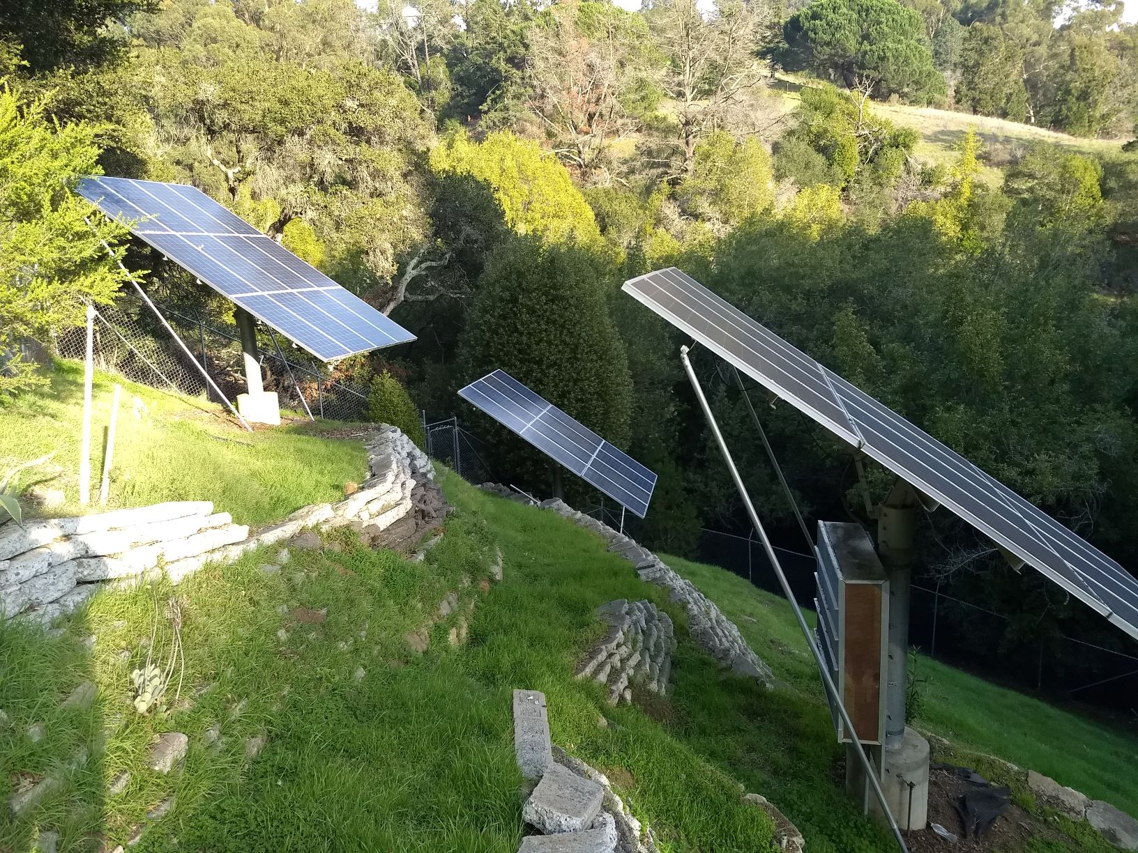

Houston... I might have a problem as the 6 kW array is made up of 30 165W panels and 6 170W panels totaling 5970 Watts.
Did not know all panels should be the same in a String system...
Replacing 36 panels with 300W would put me at 10,800 Watts.
The panels are subject to some shading late in the day...

The 165w vs 170w is a small difference which would not have much of a negative effect on the system, but the 170's are limited to 165 in all likelihood. Based on a total of 36 panels, you most likely will have 2 strings (2 x 18 in series)
As for washing them, water perhaps with some soap is fine. Do not use a pressure washer which could force water through edge seals and cause problems with the panels.
Your shading issue could be a factor is only a few panels are shaded. In that case the string associated with the shaded panels will be effected. If the shading affects the larger array, then you don't have many options. If the shading is confined to a few, then micro inverters will help by allowing all of the unshaded to still produce at a higher level. You would need to weigh the change against the cost of the micro inverters and a bunch of rewiring versus the payback of the additional power gains. If the shading occurs early or later in the day, when output is significantly reduced, then the benefit is likely not worth the investment in any case.

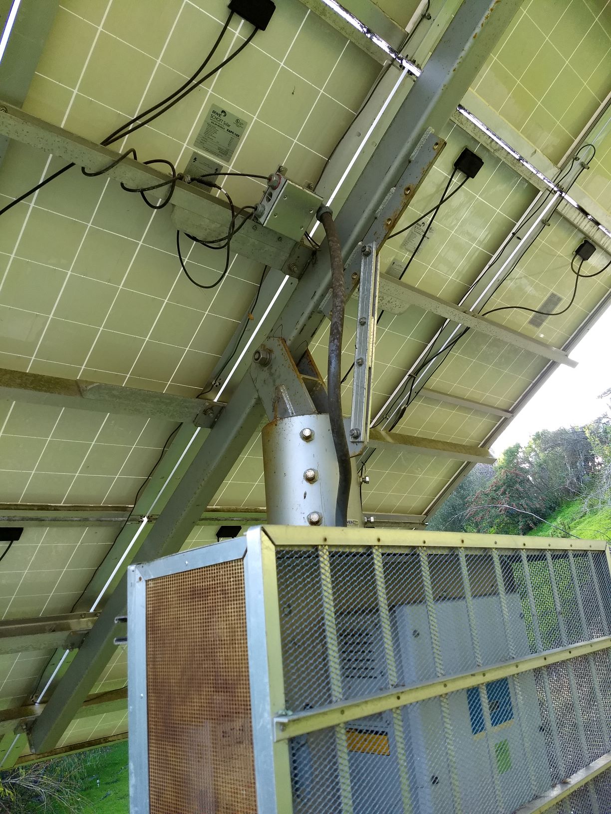

The panels appear to be in good shape but I know a tree limb put a slight bend in one of the panels... it must have caught the leading top edge of the middle panel... that panel has slight bend to it.
The bend is not apparent in the attached picture...
The panels are ground mount in 3 arrays...
Picture late on a January Day...
