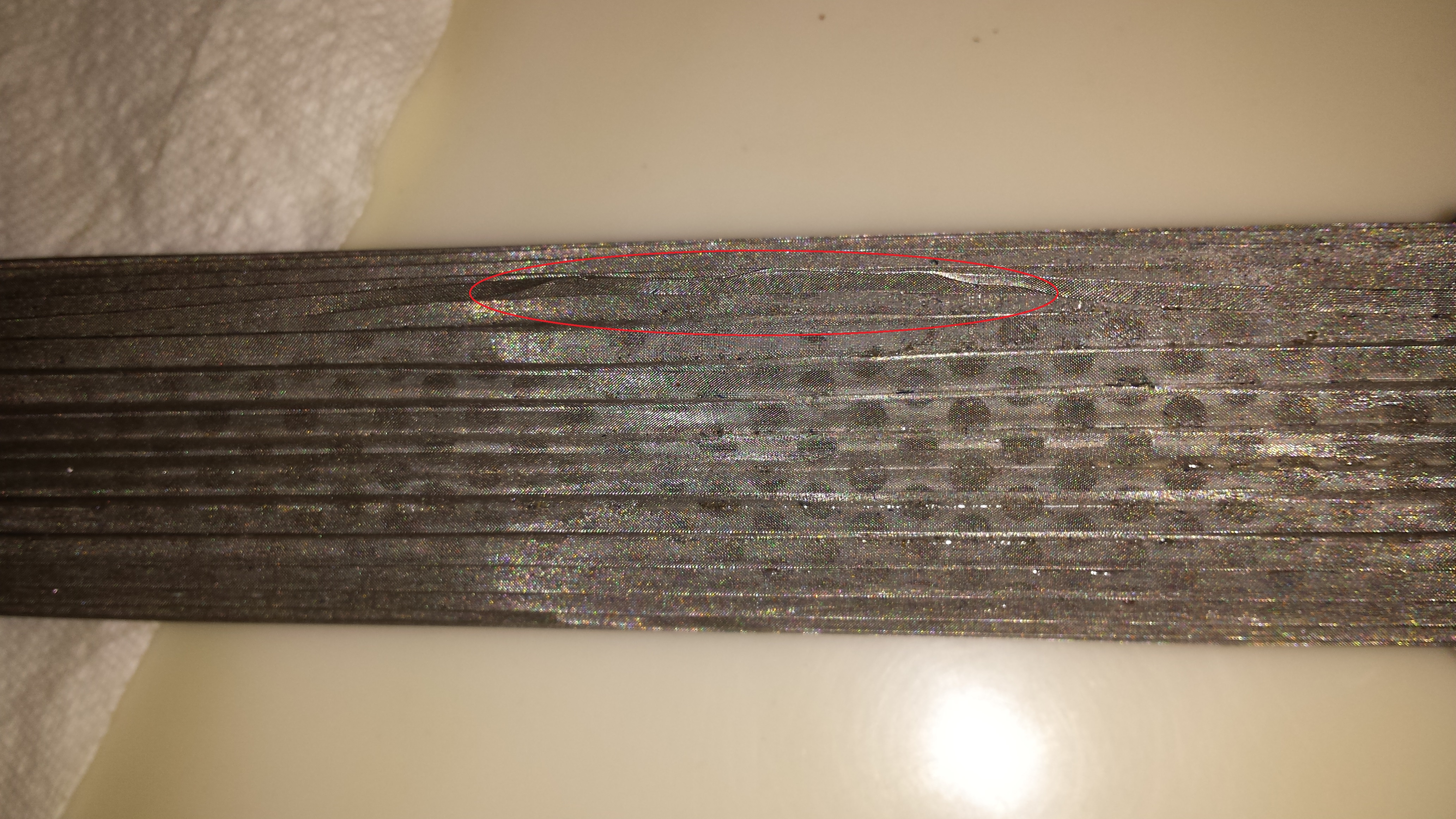

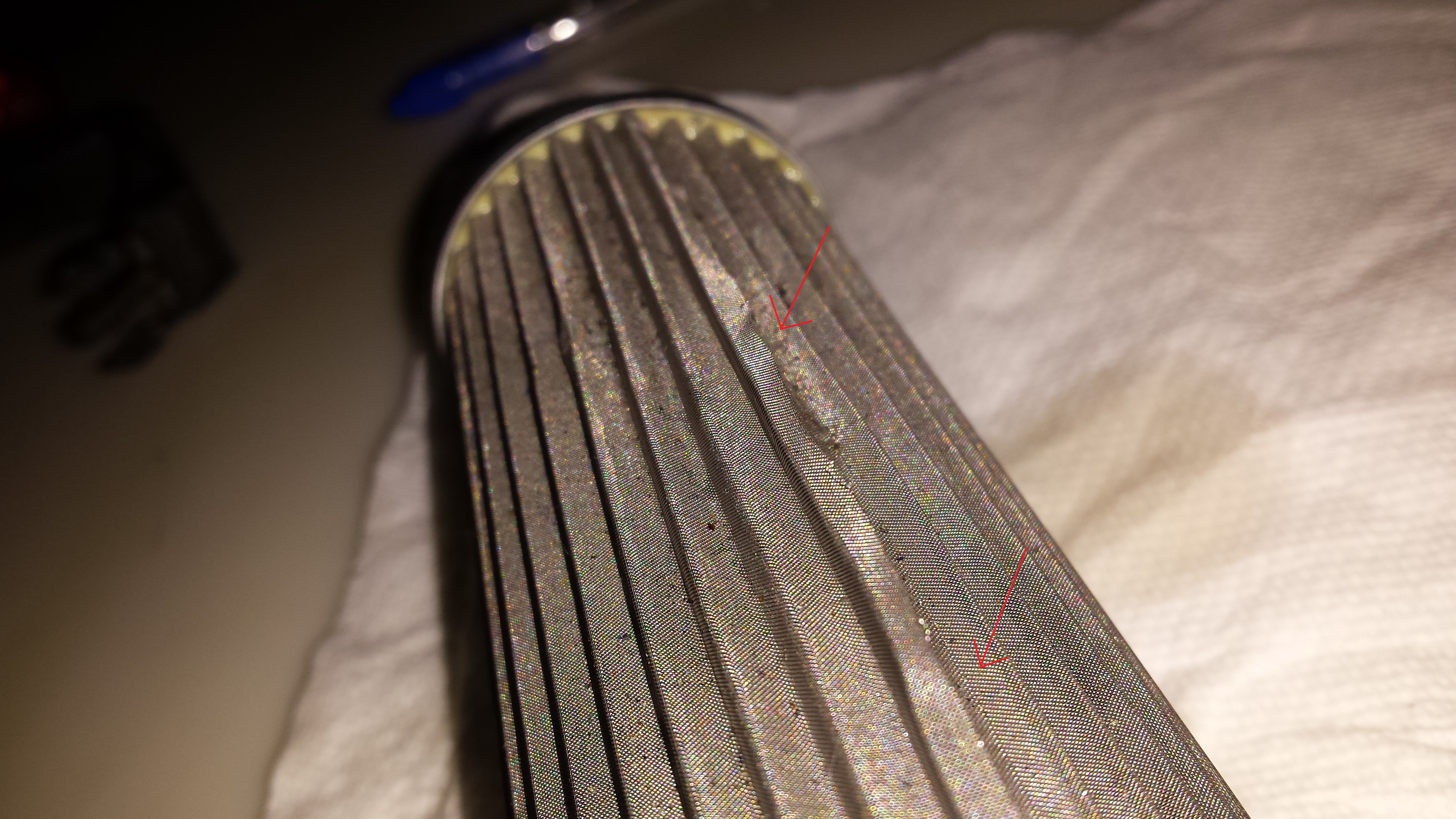

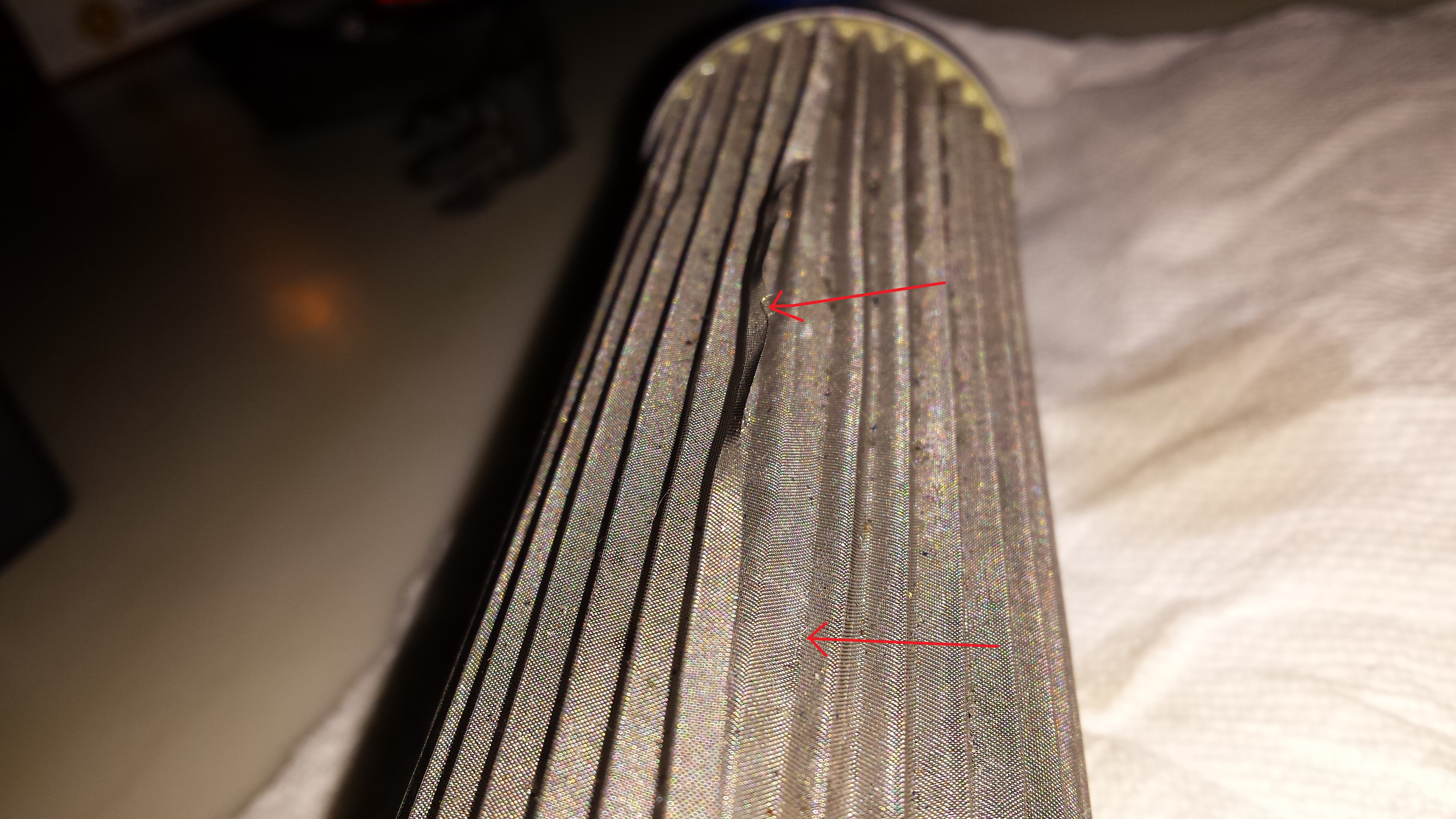

Does anyone happen to know the part numbers for the suction screen (#54) and O-ring (#59) found in the Deere online Parts Catalog under drawing MP6166 (Alphabetical Listing "S": "Screen,Suction, Transaxle Housing and Rear Cover"? The parts list only covers items up to item #40 and I've waded through lots of posts that reference the suction screen but no part number. I'm changing transmission fluid as part of regular maintenance and found the two spin-off filters but didn't know about the suction screen until recently. Since I'm the 3rd/4th owner, I think it's past time I check it but would like to have a new suction screen and O-ring on hand just in case the original is defective. Thanks in advance.....
Be careful when you remove the suction screen , I damaged mine as I was remove it. Sorry I don't have the part numbers

Jenkinsph & DocDryden: Initially I was concerned because someone raised the question of how to clean the screen filter without damaging it leading me to believe it may not be a very strong or made from a reuseable material. I also saw a picture of a screen filter removed from a 4610 loaded with metal filings and that seems not to be out of the ordinary. Once I saw it was metal screen material, I was less inclined to buy a spare. Due to the price of the screen filter, I think I will heed both of your recommendations....ie becareful handling and save some money for other things! Thanks to you both for your comments!
