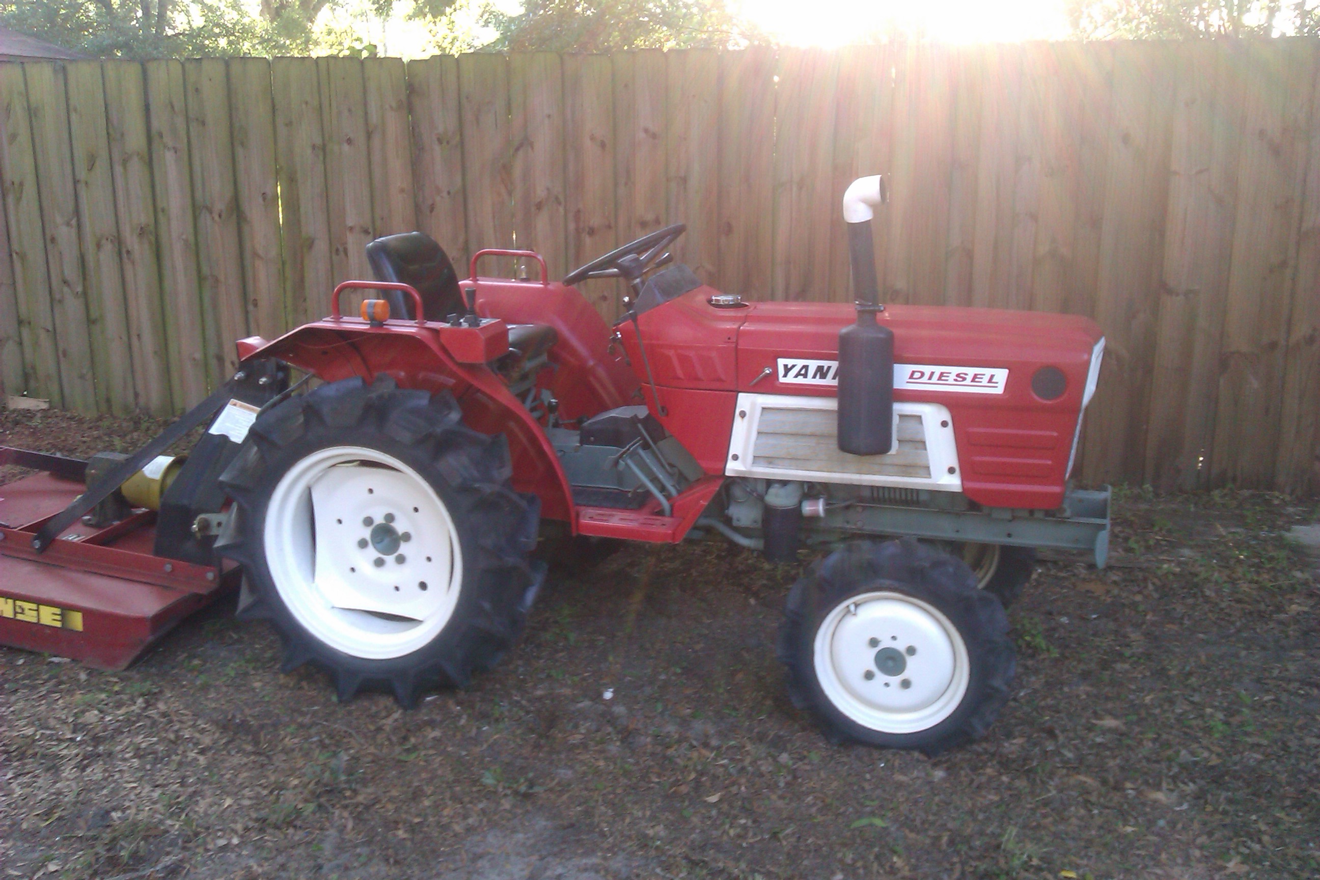

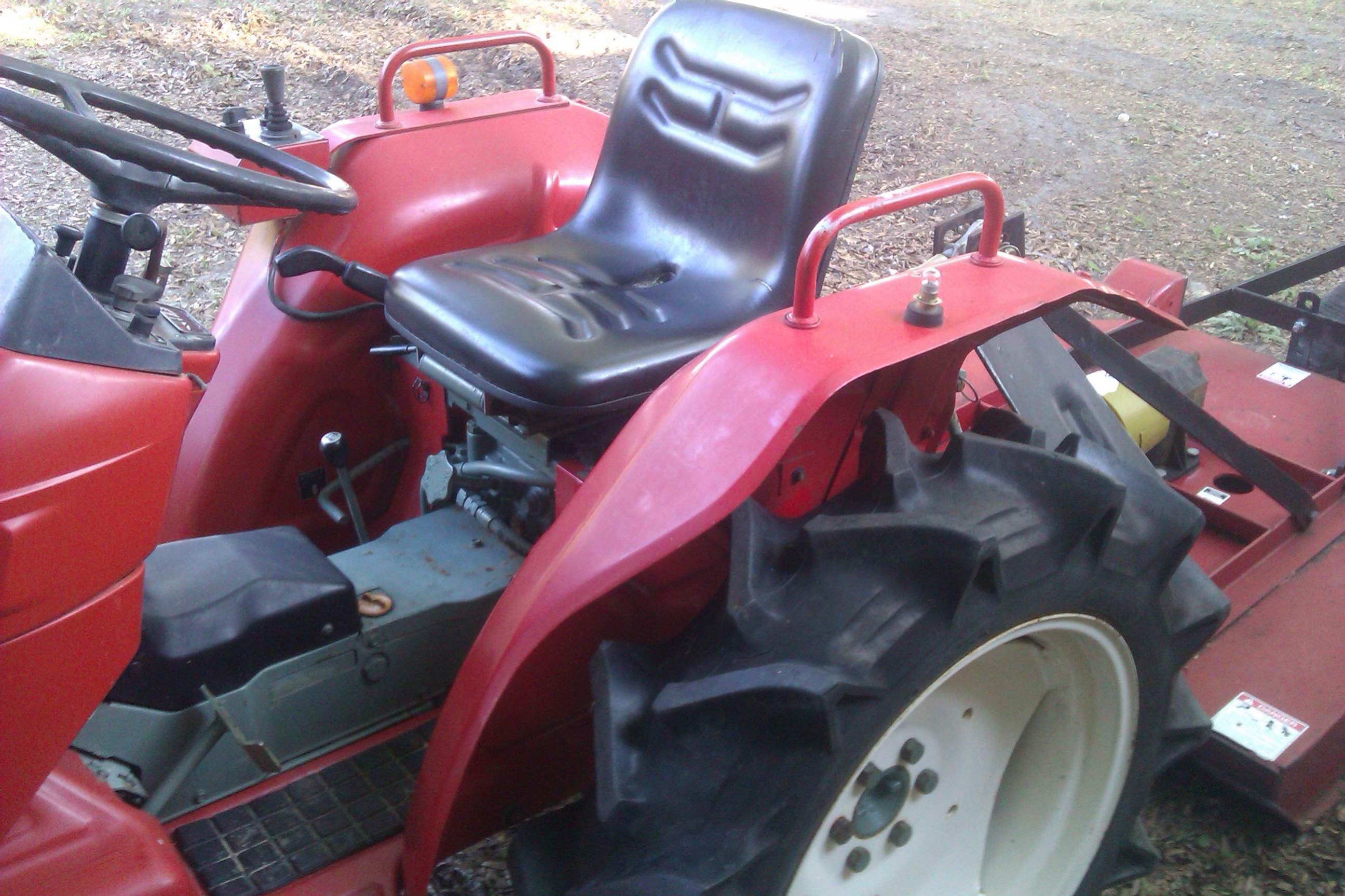

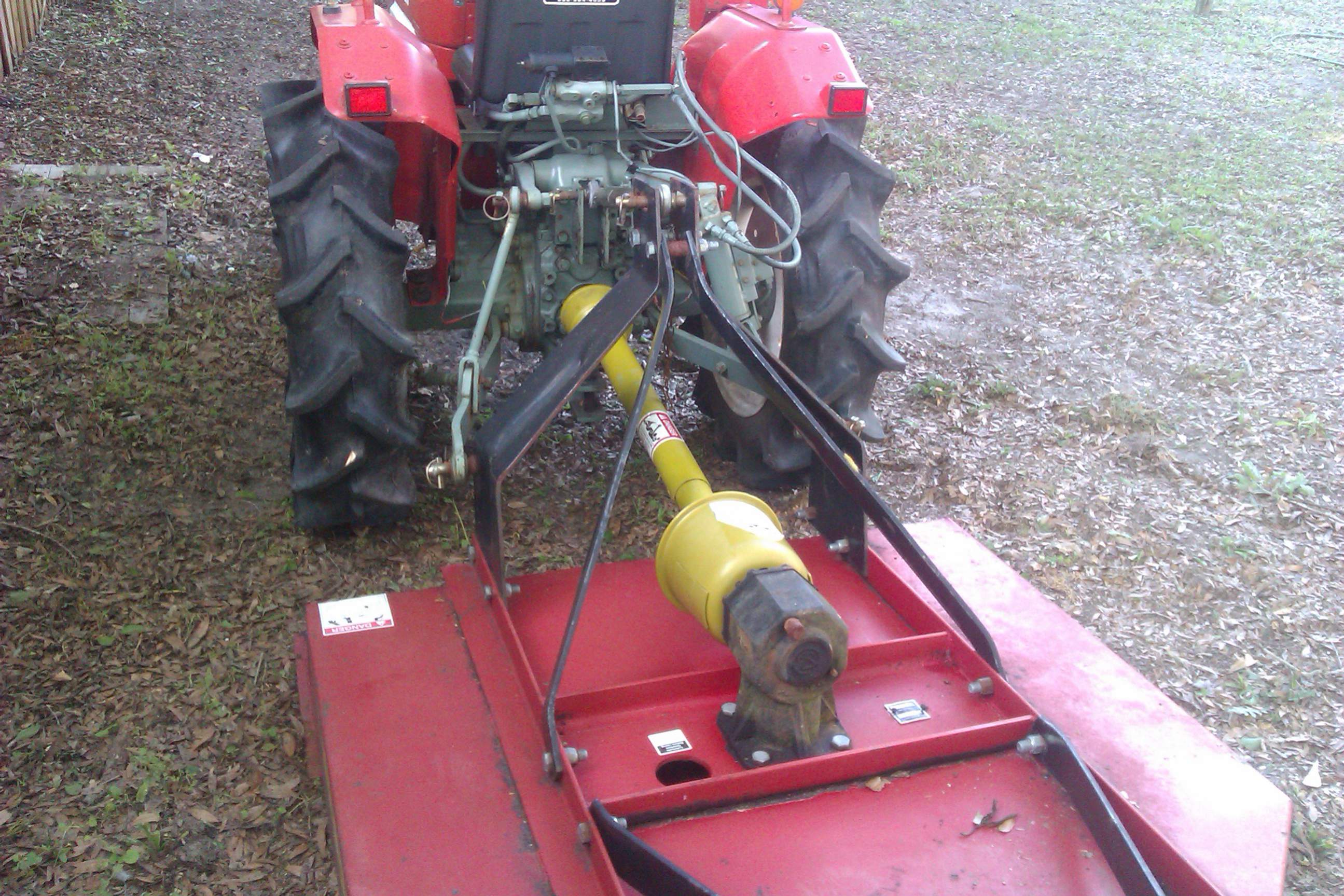

Pics : ) IMAG0084.jpg
   / New to me 1720D #15
Nice tractor.:thumbsup: What is that mounted behind the seat ? Also, looks like it has rear remotes ??
   / New to me 1720D
#16
It the valve for the tilt on the 3pt hitch. Kinda like rear remotes been thinking about putting some quick connects on it to use it with other things :thumbsup:
