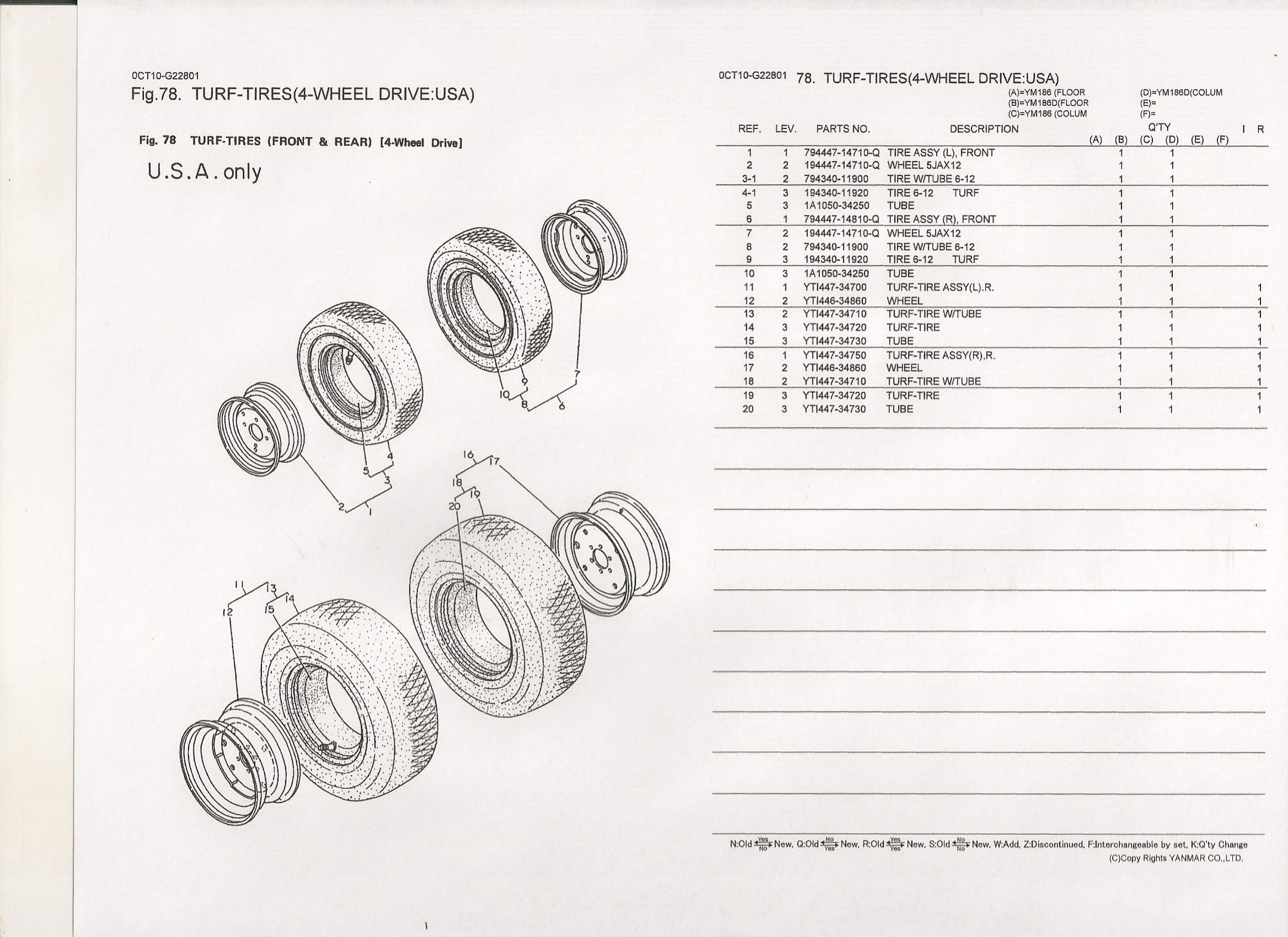

Getting lots of bugs worked out of the tractor and lots left to go. Wondering now about the tire size, it has 31x15.5 -15 on rear and 6 - 12 on front, you can definitely feel a little binding when in 4wd. checked front axle over and everything seems fine. Is this the right size tire combination for turfs?
   / new to me 186d #13
Page out of parts manual.

#14
seems the 6-12 front is right but doesn't give a rear tire size to match

#16
seen that one but it is for ag tires, believe I found it in another post it should have bigger front tires to go with the large rears
   / new to me 186d #17
Description:
18 hp.3 cylinder diesel 4wd. tractor,9x3 transmission with 60" mower deck drives off the rear pto,20.5x8-10 front,31x15.5-15 rear turf tires, front weight, 771 original hours
Turf Tires!
   / new to me 186d
#18
Description:
Turf Tires!
thanks, that is what I was looking for :thumbsup:
