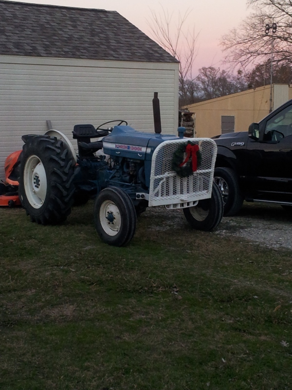

Hey guys and gals,
I recently picked up a fairly nice Ford 3000, 8sp, live PTO, gasser. Everything works except the gauge cluster. The 3pt is slow and jerky to lift. My first plan is to replace all fluids & filters and give it a good tuneup with new plugs, wires, points, etc. I have the parts and service manuals along with an owners manual. Few questions? 1) What type/brand fluids should I be looking at? 2) coolant.... any specifics? 3) Anyone used any of the aftermarket gauge clusters? This particular one has an alternator instead of the generator.

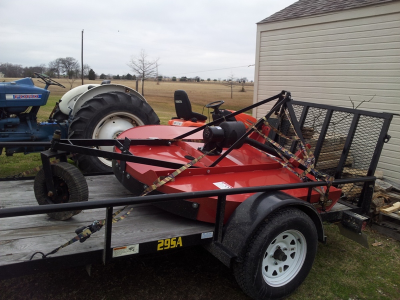

Picked up this new 5ft Landmark shredder last weekend. Found a guy that after 38 years of business, he decided it was time to retire. This came with the slip clutch and was priced just a bit over half of msrp.... All the used ones I was looking at were shear pins and were about the same price as this one. Had to drive 2 hrs each way to get it, but feel it was worth it. Now I'm looking for a good box blade, not new unless the same type of deal happens. Would a 6ft box blade be too big for this tractor? I believe the width of the rear tires would be just at the edge of a 5ft blade. brushhog.jpeg
