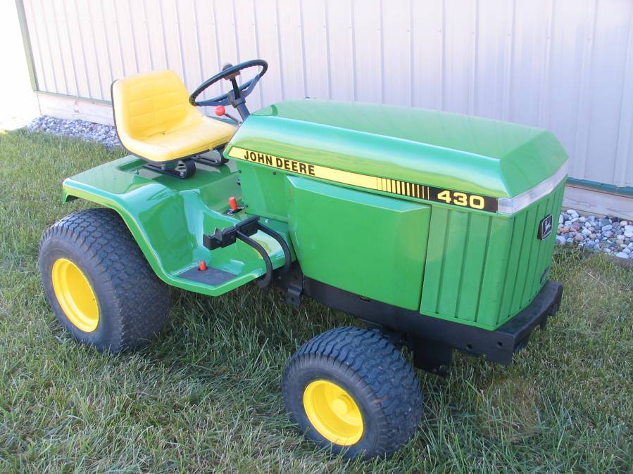

Yesterday, I picked up my John Deere 430 Garden tractor!
Happy to have it home, I pulled it off the trailer and immediately mowed my lawn!
1400hrs with the 60" deck and 6 suitcase weights.
Needs:
-1 new front tire
-Deck repair: dolly/caster wheels and assembly need replacement/rebuilding and the chute needs repair
-new set of blades
-Drain fuel tank
-HYD service
-2 front bulb sockets
-1 rear bulb socket
-and a little paint and a lot of cleaning!
I need to drain the fuel tank for two reasons, at least thats what I believe... 1) there is a foreign object in there. The previous owner said he thinks that they lost part of a funnel or filler can down there. 2) the annunciator light with the gas pump that says "H2O" under it is illuminating intermittently. I don't have an owners manual, but I'm assuming that there is a sensor that reads water in the fuel? And I must have a high water content in my fuel? Thoughts?
Wants (in somewhat of an order):
-3pt Hitch: Ruegg looks like they have a nice product, any other suggestions?
-Box blade
-JD Rototiller
-Dump cart
-Snow Blower
-4-in-1 scoop
I know shes one heck of a tractor, but any other experience, suggestions or cautions are more than welcomed!

Looks great, that's quite the wish list :)
Only suggestion is don't leave the weights on for lawn mowing.
You may of just put them on for the picture.
Does that tractor have power steering? what engine is in there?
I have a 320, with a 48" deck but just use it for lawn mowing and snow plowing.

I put the weights on the front just for moving it. I did leave them on for mowing that little patch, pre-picture, but they are off now.
It has hydraulic power steering, hyd lift and 2 front remotes. It also has the rear PTO.
The engine is a 3cyl 20hp Yanmar diesel, that purrs like a kitten.
The wish list is a bit extensive... I will be mostly mowing with it, but I also hope to do some landscaping in some more delicate or finished areas where the larger tractors would ruin more than they fixed, hence the hitch, blade, tiller and cart. Though I suppose the tiller isn't paramount...
