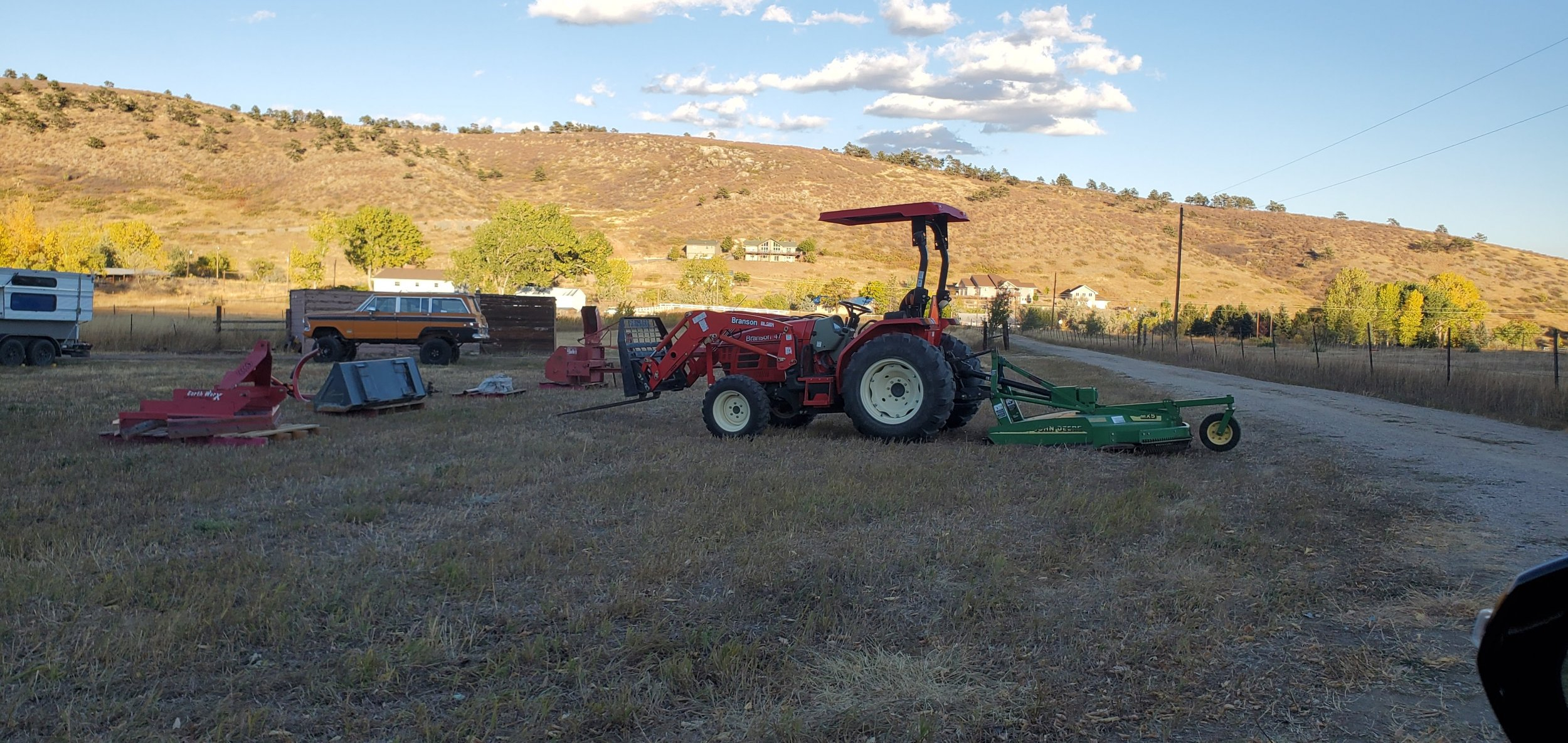

finally sold the property and received the tractor. Its kinda hard to change the ranges, do I just need to lube up the hydro pedal linkages? the hydro pedals also stick a bit, do not return to center when you let off. makes using the forks precisely hard.

The range trans on my 4 year old 3725 is also stiff. It's loosened up some since new. I think Branson uses tight gear clearances which makes for less noise but more difficult shifting.
The HST pedals have exposed linkage under the floor. I'd first clean that off then check vs the shop manual to make sure everything is in place. There's a return sping that some folks have had problems with.
   / new to me 4720H #6
for the range shifter linkage its connected to the shift lever via a roll pin style connection unfortunately there isn't really much that can be done to make that smoother, as for the pedals not returning to neutral there is a turnbuckle linkage just underneath the tractor where the pedals come under, if you adjust the turnbuckle it will adjust the pedals in or out depending on what you need and which way you need to go with the travel, as for the return on the pedals more often that not the neutral return spring will be worn out and can be replaced quite easily with a new one as its a pretty standard type of spring, this spring is what brings the pedals back to the neutral position once you let your foot off the pedals, if this is slow to return or "sticks" this spring is your likely culprit.
