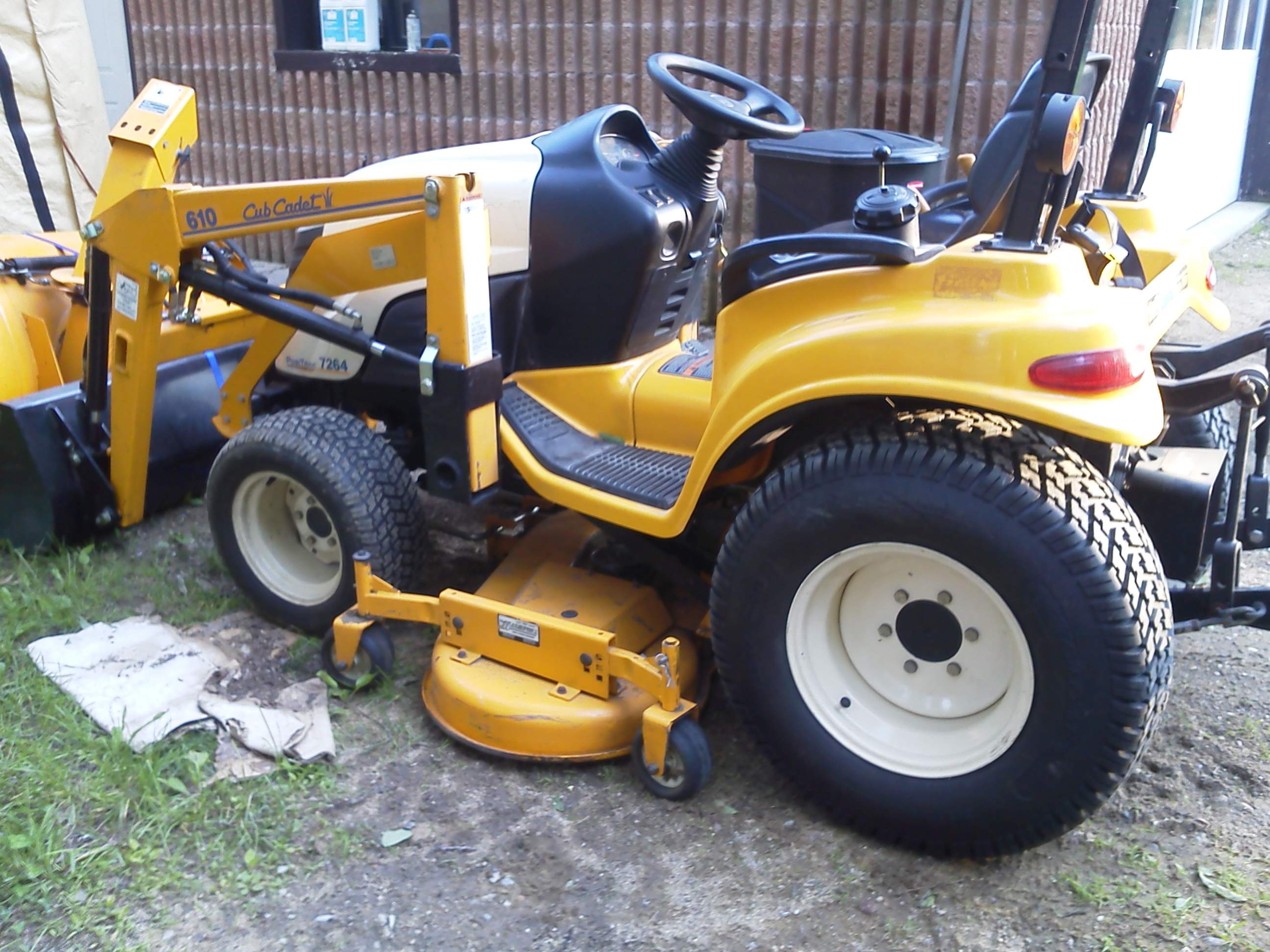

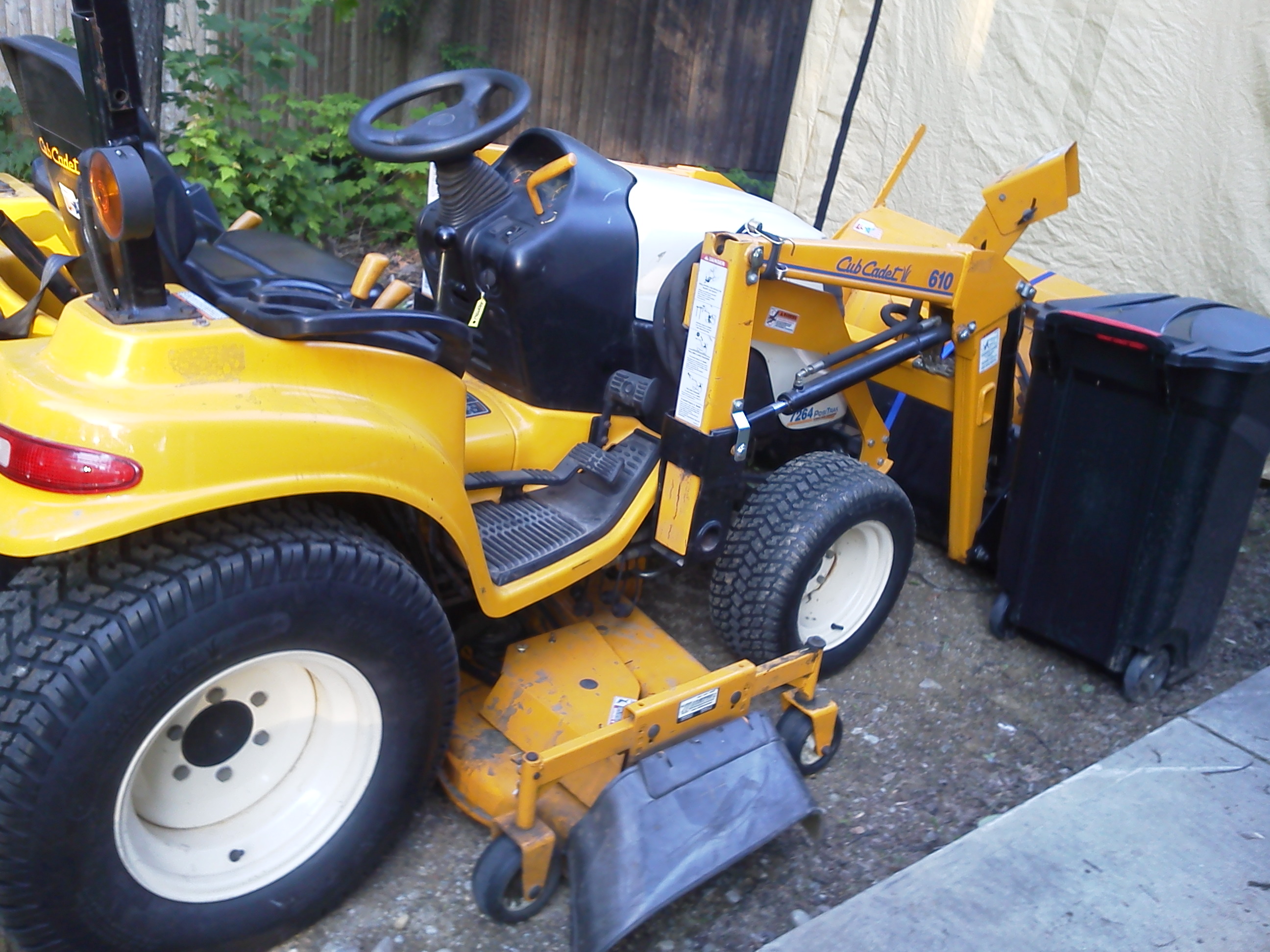

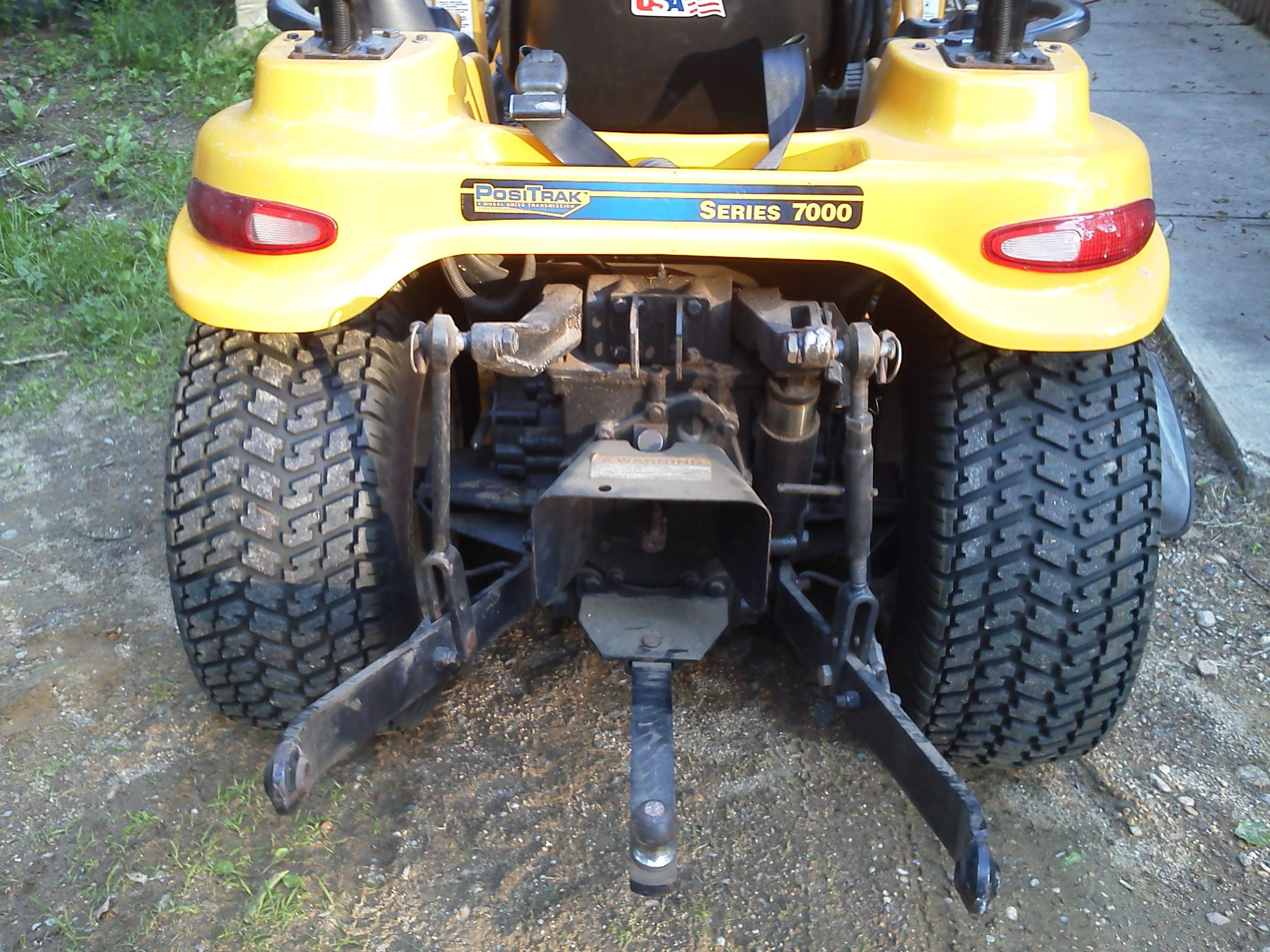

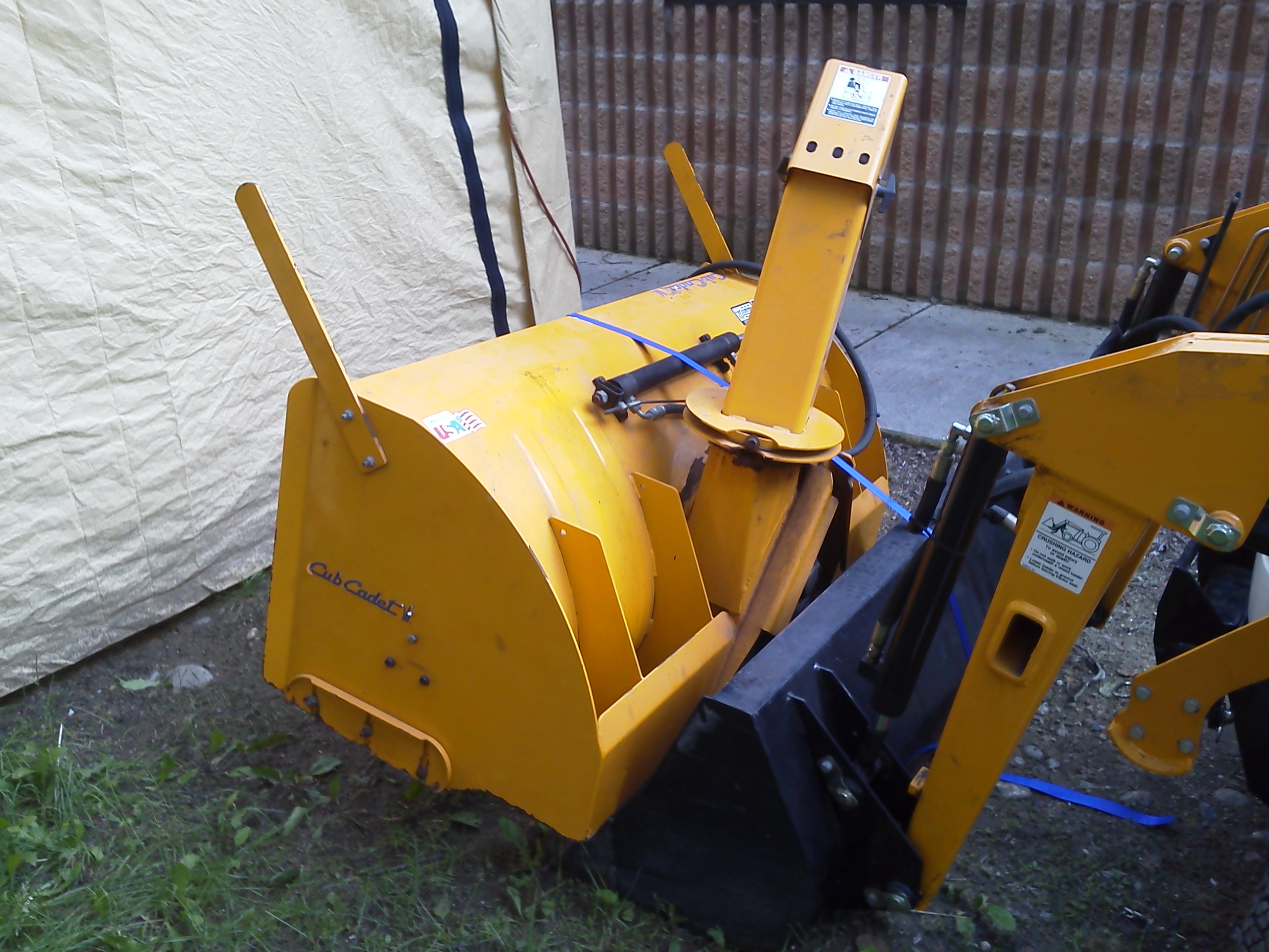

Hello all. I just sold my Satoh Beaver S370D and purchased a Cub Cadet 7264 with the front snowblower and loader for what I hope is a reasonable price. I was wondering if any knew about adding aux. hydraulics to these tractors? I had a grapple bucket for my other tractor and it was my go to attachment. Also I was wondering if anyone knew if there was a quick attach setup that bolted right to the 610 loader that the tractor came with?
Thanks for your help. new cub pic 1.jpgnew cub pic 2.jpgnew cub pic 3.jpgnew cub pic 4.jpgnew cub pic 5.jpg

Looks like a real nice rig! What was reasonable price if you dont mind me asking? Looks like it's in great shape, well taken care of, or not used very much?
I'm assuming you also have the front hitch to mount the blower, and long driveshaft? There are kits to add aux hydraulics, I think everything attachments which is an advertiser here has them.
There is no quick hitch for the blower to attach to the loader - too much weight up front, and you have to get the driveshaft back to the mid PTO.
Any other questions ask away!

Good info. I didn't know I could do that. thank you. I looked at the everything attachments and I can't believe the prices. I found a place called WR Long, which after doing a quick search in the forums isn't new to anyone. Their prices are much more reasonable however. Since no one makes a "bolt on" kit for this tractor I'm going to order the electric over hydraulic valve kit, base plate and possibly the handle with rocker switch in it. Should be around $350 and then I'll have to have all of the hoses made.
