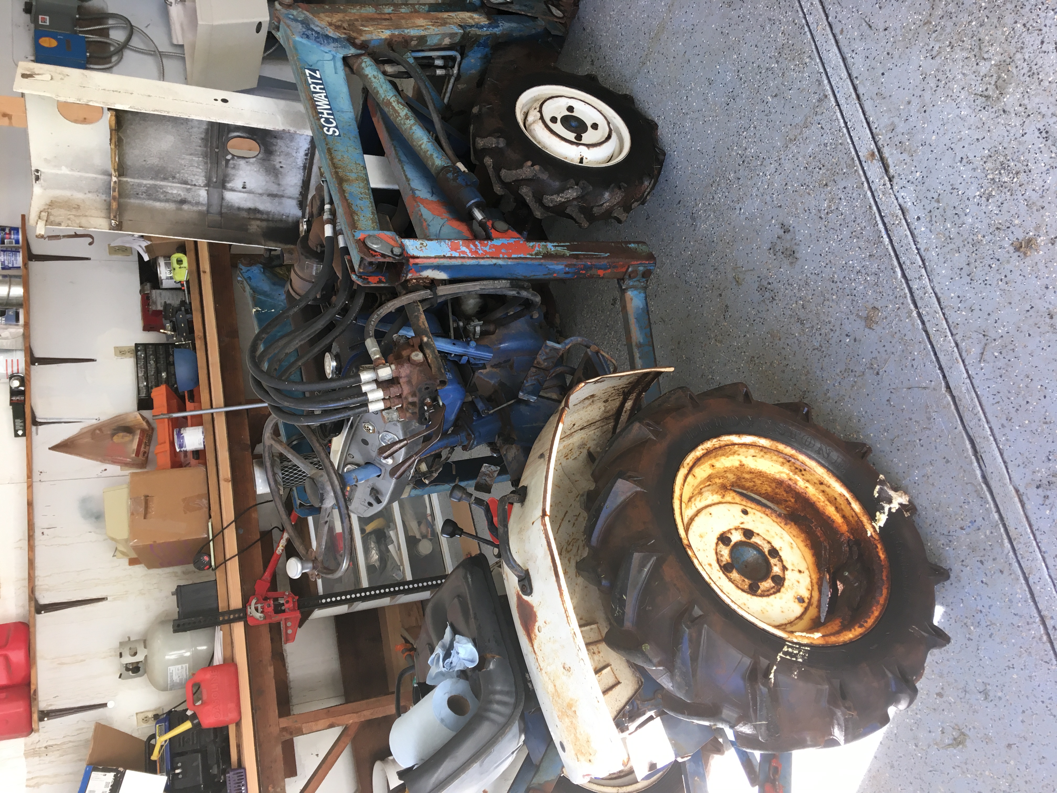

Filled it with new hydraulic fluid last night. I cleaned the filter, which did have some metal "sludge" build up, but nothing really bad. The tractor started nicely after sitting for a while and front loader works great. I then re-checked the hydralic fluid level (taking out the little check level nut) and was suprised that the level was still in good shape, just needed a little top off! Next stop, oil change, filter change and getting one rotten rim fixed. I also topped off the radiator fluid which was definitely low side. Keeping an eye out for leaks anywhere I can find them, but nothing obvious I can see for now. I will be cleaning and de-greasing areas off next. (and greasing fittings)
Hosed off the bucket and rims today.
These are neat little tractors, just seems like it is hard to find parts...no luck on finding a 16" rim, so going to have it repaired. I am concerned if something goes wrong that finding the parts will be next to impossible.
The only thing not working is the 3pt arms will NOT lower. They are stuck in up position. I adjusted the flow control valve under the seat, but no luck. Could it be a stuck piston?
