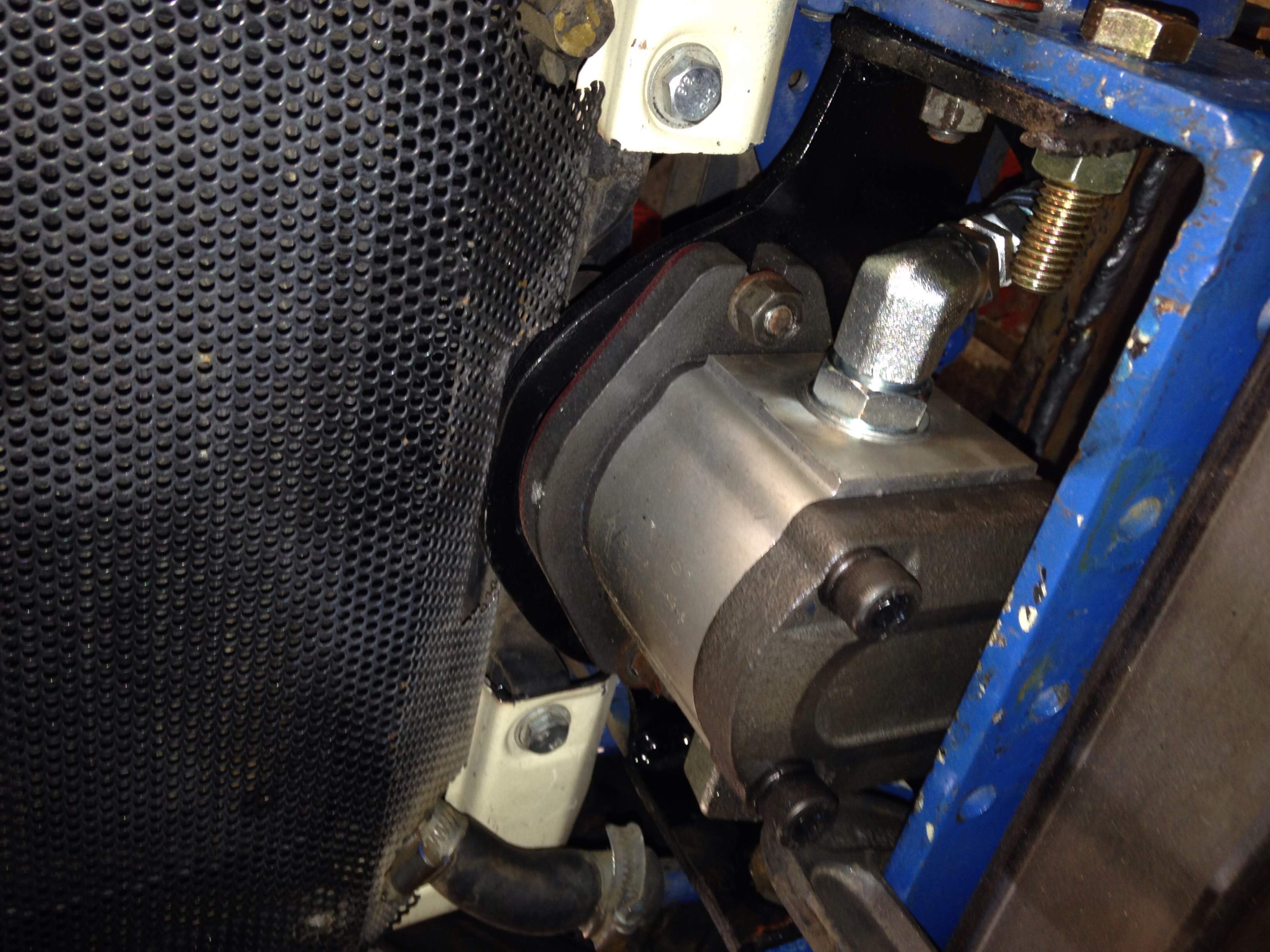

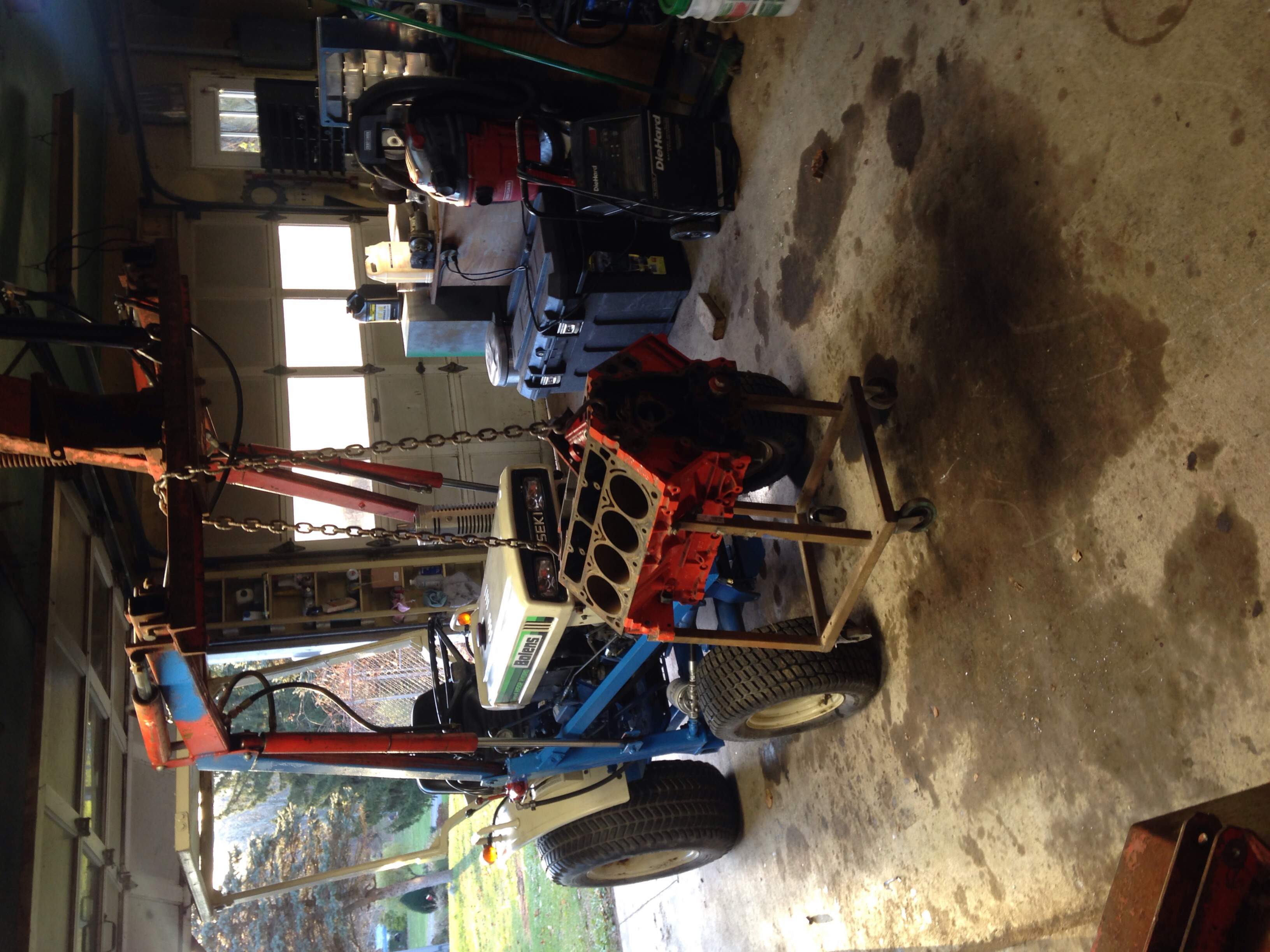

image.jpgimage.jpgimage.jpgMy rad screen is clean. I have since changed all the fluids engine oil/antifreeze/trans and rearend fluid and all filters were cleaned and strainers were cleaned. They all looked good. I have to Grease the entire tractor now and thought should get it all up to date on services. I also have installed an older ark 500 loader I had from another machine. i direct drove a seperate pump of the crank just for the loader. I have been in a hurry to finish before we get snow. The loader had a plow with it I never really used it because it was now power angle. So I mounted a cylinder to it so I don't have to get my lazy but off the machine
