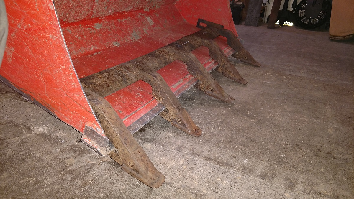

First thing I would do is check the flimsy hydro fan since you went through all those saplings. A stick will take out the blades on the plastic fan. Aftermarket guards are available to keep this from happening. You would love a Piranha tooth bar for the front bucket. These things are sharp and really will blaze a trail and help with digging to. A thumb for the backhoe is also a nice option.

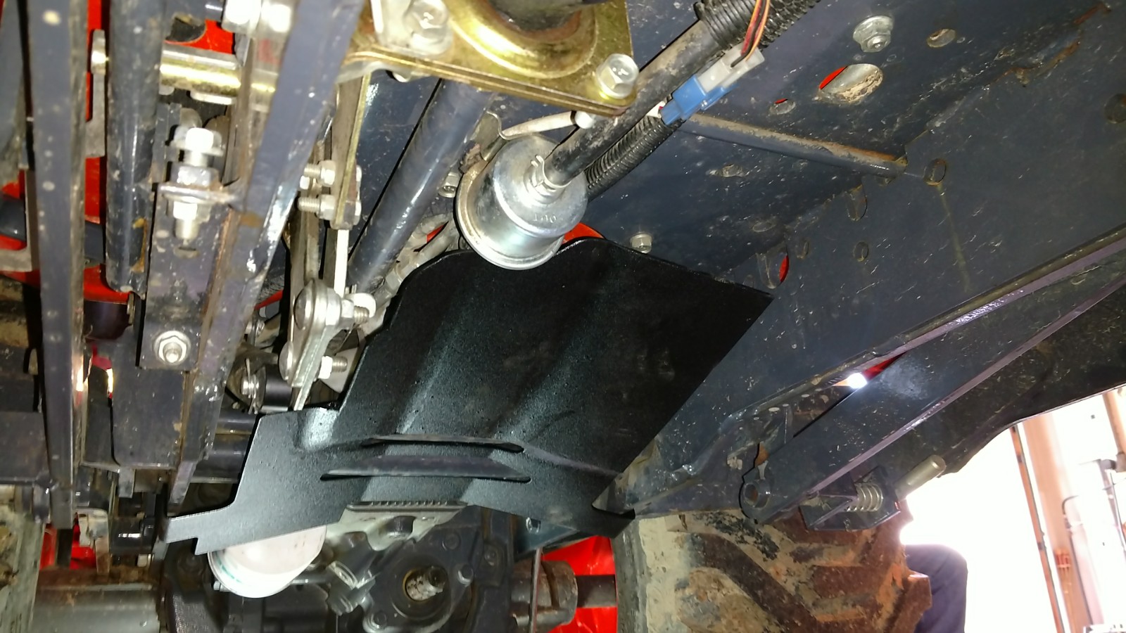

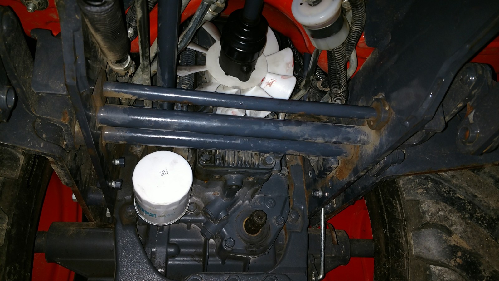

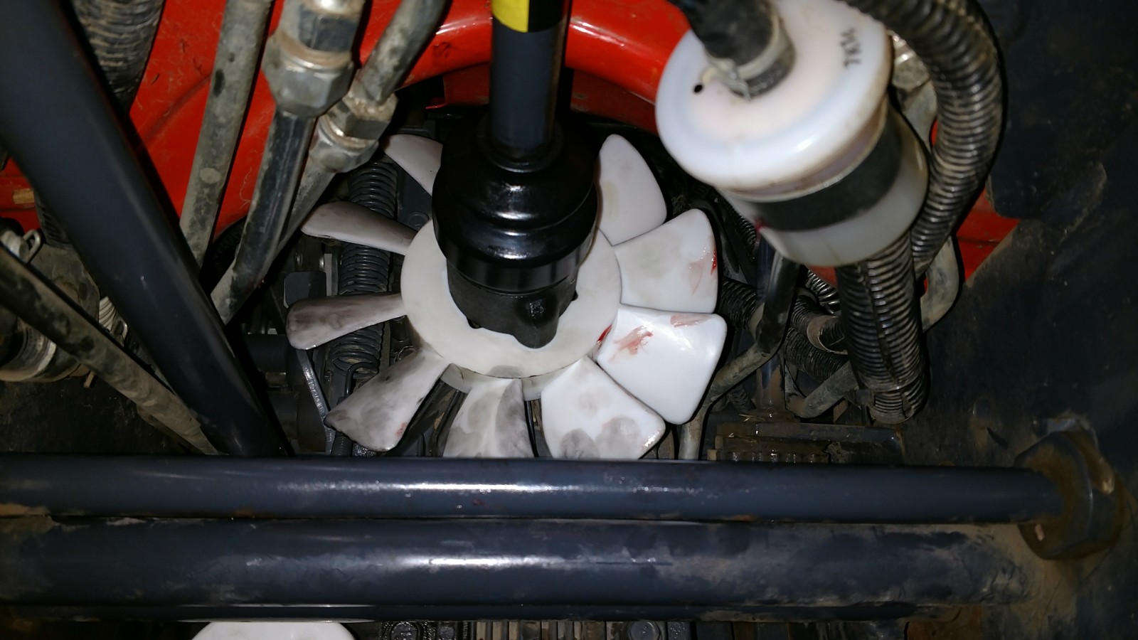

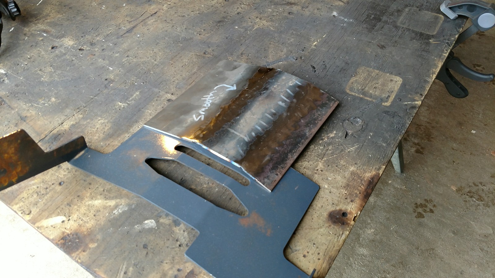

The rubber boots on the hydraulic steering ends are known to age and crack apart quickly.
The CV boots on the driveshafts can also start to come apart.

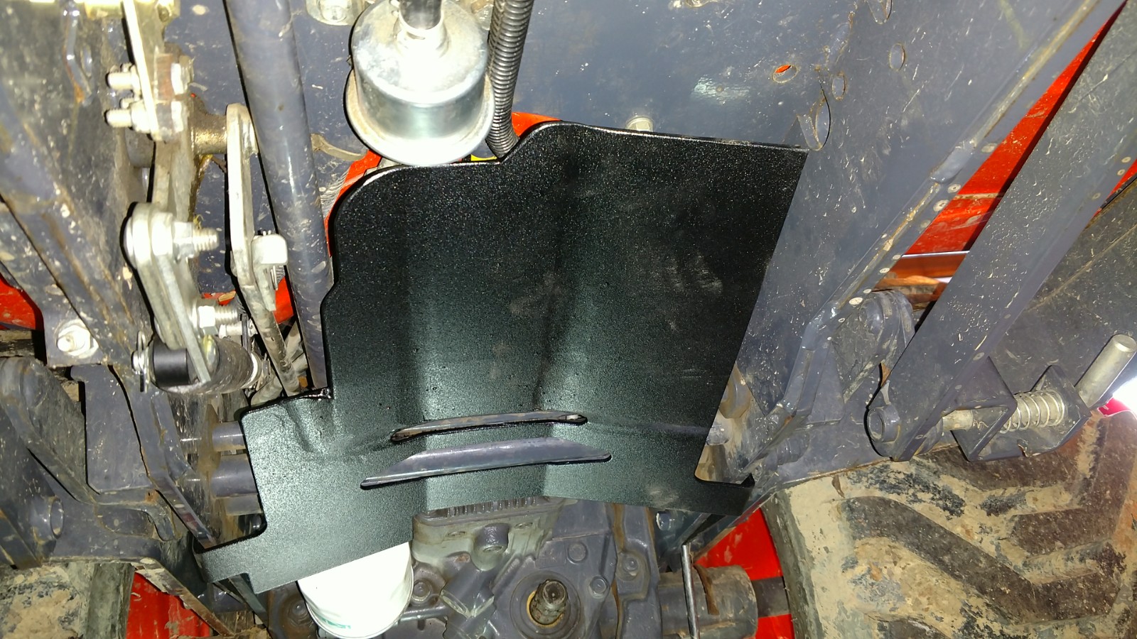

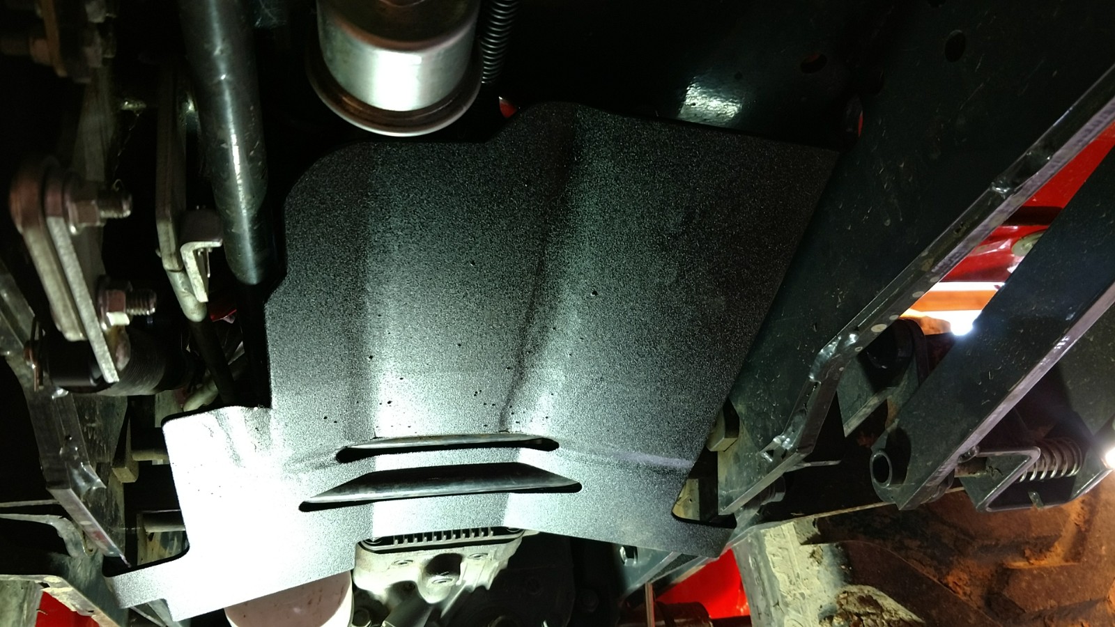

The HST cooling fan is potentially not with fan blades any longer after your demolition banzi run, that fan is on the rear end of the rear driveshaft at the entry point to your rear axle. You can easily weld up a shield in an afternoon with scrap steel.
There are some photos attached to help you out. Also, check YouTube for more.

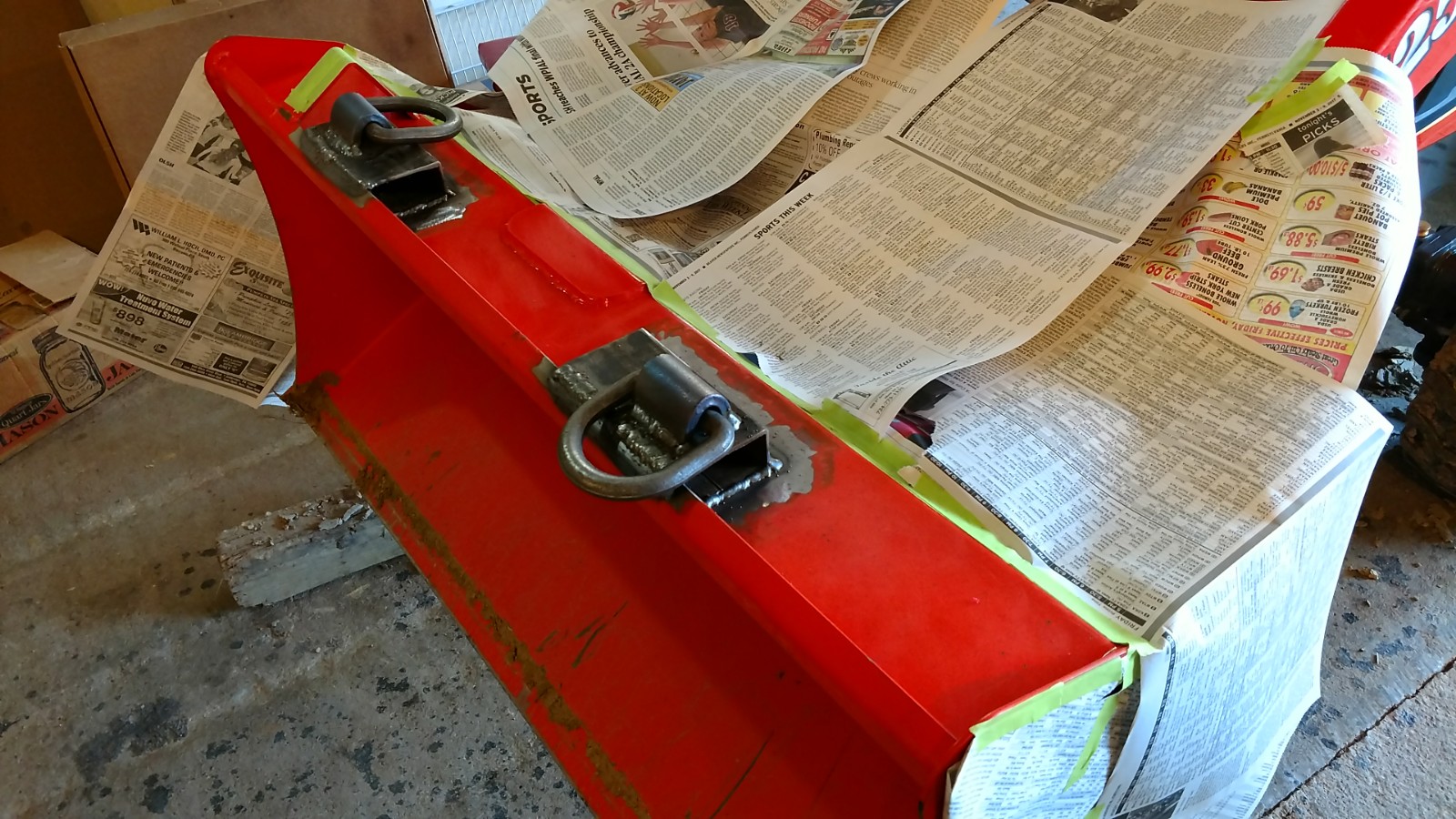

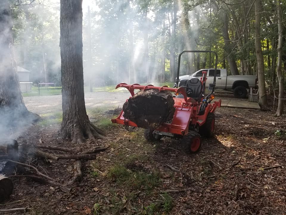

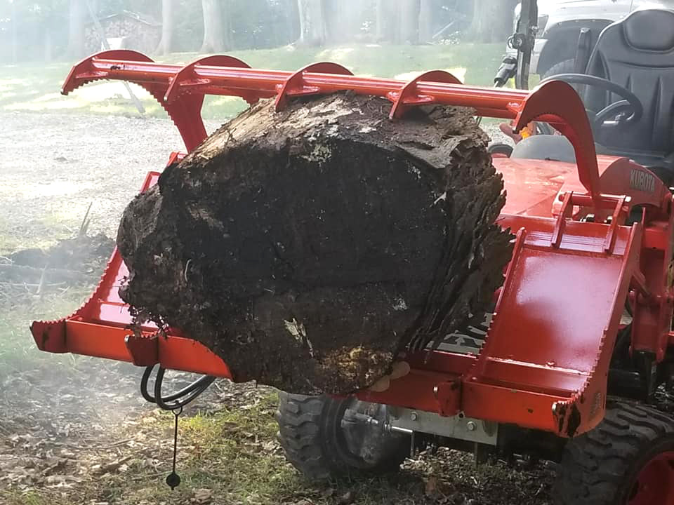

Grapple is the best attachment after that.

Rock Crawler I am unable to see the photos you posted.
Yes on the hydraulic steering boot deteriation, noticed that when I crawled under to remove the belly mower.
Are you in the Tapatalk program? I use that forum application to serve photos and access forums.

Not using Tapatalk, that makes sense. Odd though.
Great photos and detail, thank you for the link. I'll have to crawl under and look. I may have to copy your D-ring concept on the bucket.
