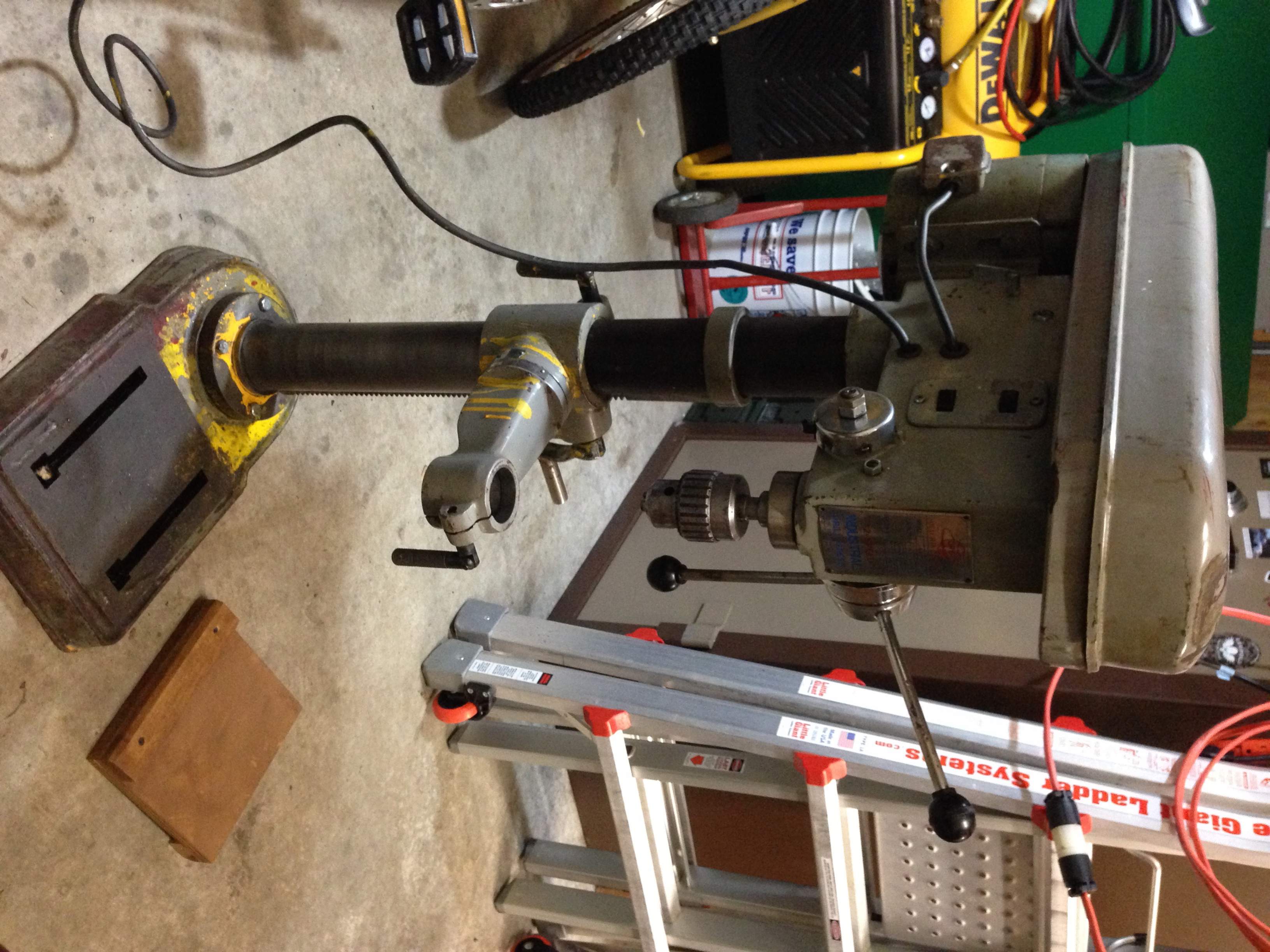

Iplayfarmer,
Thanks for the reply.
If you get a chance, can you explain how you adjust the belt for different RPMs and confirm the name and functions of the controls needed to do that. Are the screws with the tap on the right and left side called "bar knobs"? The one on the right side is rusted shut. The opposite one on the left side turns in and out freely. Can just having the left side moves good enough to loosening what ever I need to loosen to adjust the pulley or belts for RPM adjustments. The chromed handle next to the rusted "bar knob" moves, but I'm not sure how it should be moved. I believe this is called the "tension adjuster". Does it move the motor closer to the housing to loosen the belts on the pulleys? Pull or push towards the motor? Guess I just need to get back into the garage and play with that thing and see what moves what...but any help from your end would be appreciated.
Second question is regarding the two black colored switches on the left side. I'm guessing they are power switches. The one on top will turn on the motor. What is the function of the lower one?
I have a manual for a Jet Model JDP-17MF. It appears very similar to our machine and is using it to learn the nomenclature of the various parts of this machine. Do you have a source for the one we have or one more similar for me to learn the guts and function of this machine?
I also noticed you had disassembled your drill press to clean and be serviced. I'm in the process doing that this weekend. I'm going to check the electrical components.
Any advice on what specifically to look for or to check? The belts have a few nicks and cracks on them. What size will I need if they are to be replaced?
I'm excited to refurbish this machine and start in on some drilling practices (homework for my machinist classes).
Thanks again for reviving this thread.
Bob

Hi David,
Will look for the light. The top rocker switch is marked with an embossed "M" and the lower rocker switch is marked with "L". So can I guess, M is for motor, and L is for light? Thanks...

Yep! Pays to do a 360 look around your machine from top and bottom view....found the bulb socket. The switches are marked for the functions. "M" for motor and "L" for light. Still working on getting it cleaned and adjusted.
I also got the rusted screw loosened and the pulley torsion handle to move the motor. The motor was resting on two rusted bolts...now cleaned and loosened. Everything is moving freely now. Took some prompting from you folks. Thanks for getting me oriented. Learning more each day.
