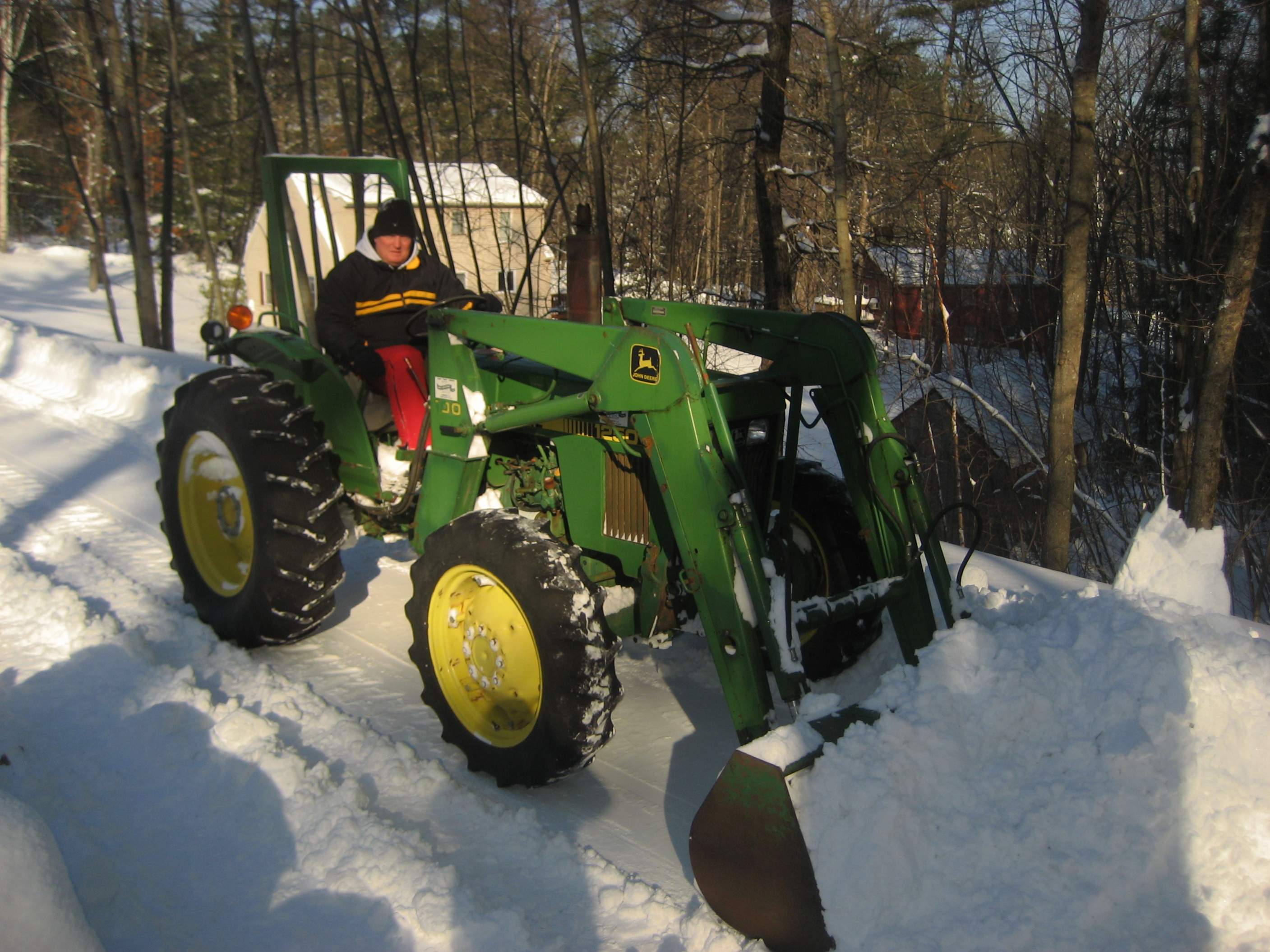

JD 1250s are great machines . I had a problem with using a non JD filter on the Hydrolic filter under your left foot . Put a JD on it and everything was fine .
If the Hydrolic screen in the rear axel plug is rusted get a new one .
