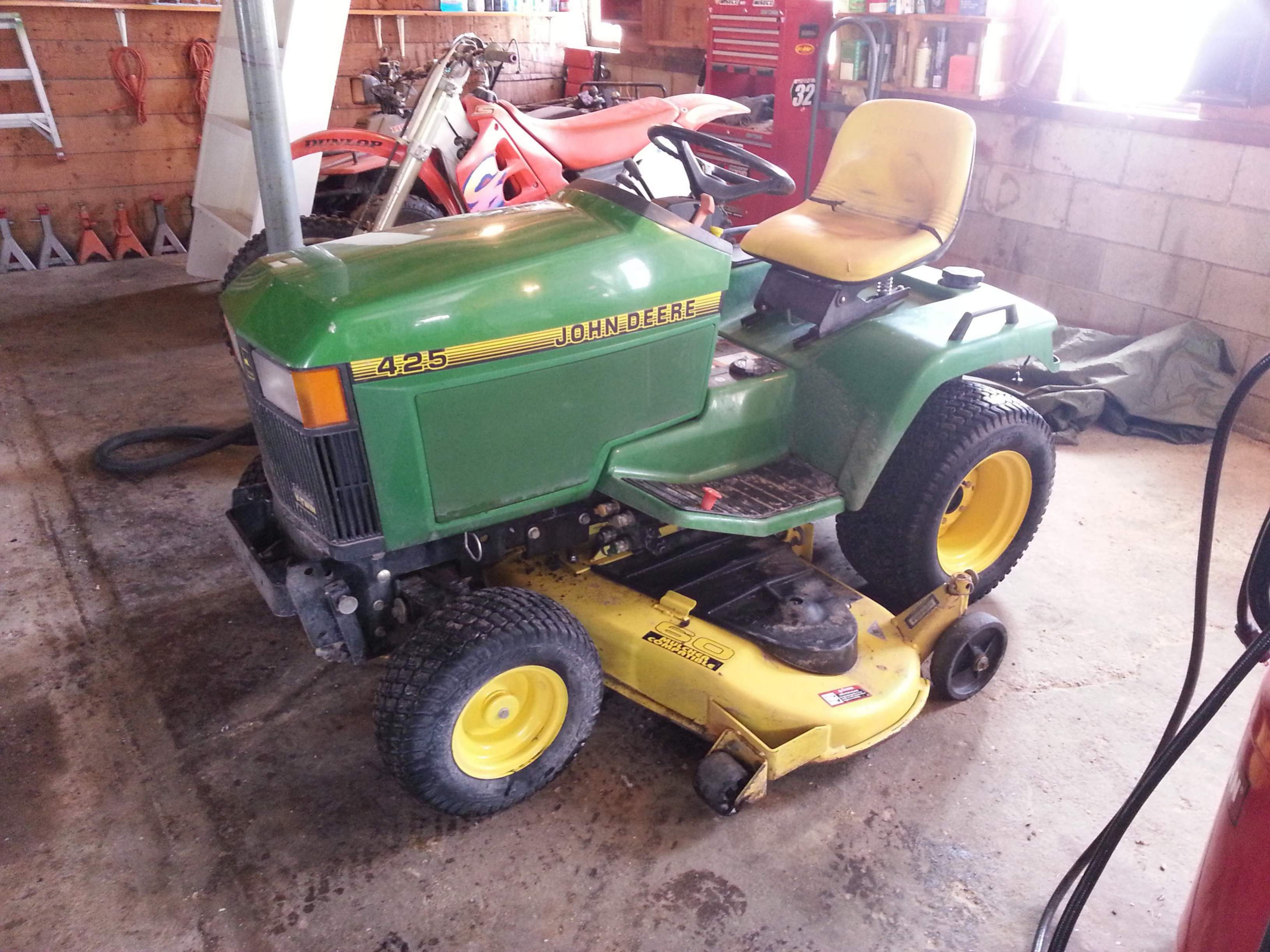

Thanks! All is well and the 425 is home. And holy cow this mower is built like a brick talk about heavy duty construction .
Its in the shop now thawing out so I can get all the snirt off it and get it cleans.
Now its a 97 with 605 hours . Dealer said 1000 hours change the hydro fluid. I'm wondering if I should just change it now. Anyone know how many gal it holds?
If it only holds lets say 2 gals that's cheap piece of mind.

Well tonight me and the 425 became friends. I gave it a complete once over.
Really don't know a machine until you get greasy working on it.
I did.
Rear hydro/tranny fluid change an new filter.
Engine oil and filter change
Air box cleaning and new filter.
New spark plugs gapped and installed
New fuel filter
coolant flush
Greased every zerk.
After I finished and started it. It popped off and idled smooth as butter. Clogged air filter and dirty fuel filter and plug changed made it a whole new machine.

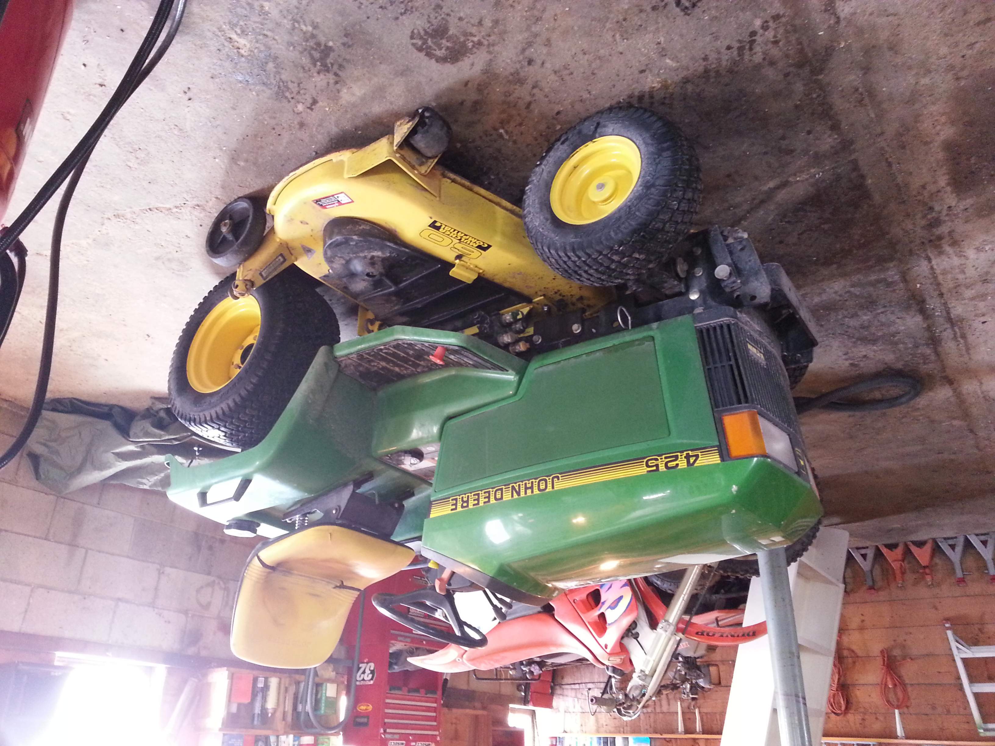

No idea why that posted upside down the image on the PC looked fine hmmm
   / new to me. jd 425
#20
Try this upload again.
