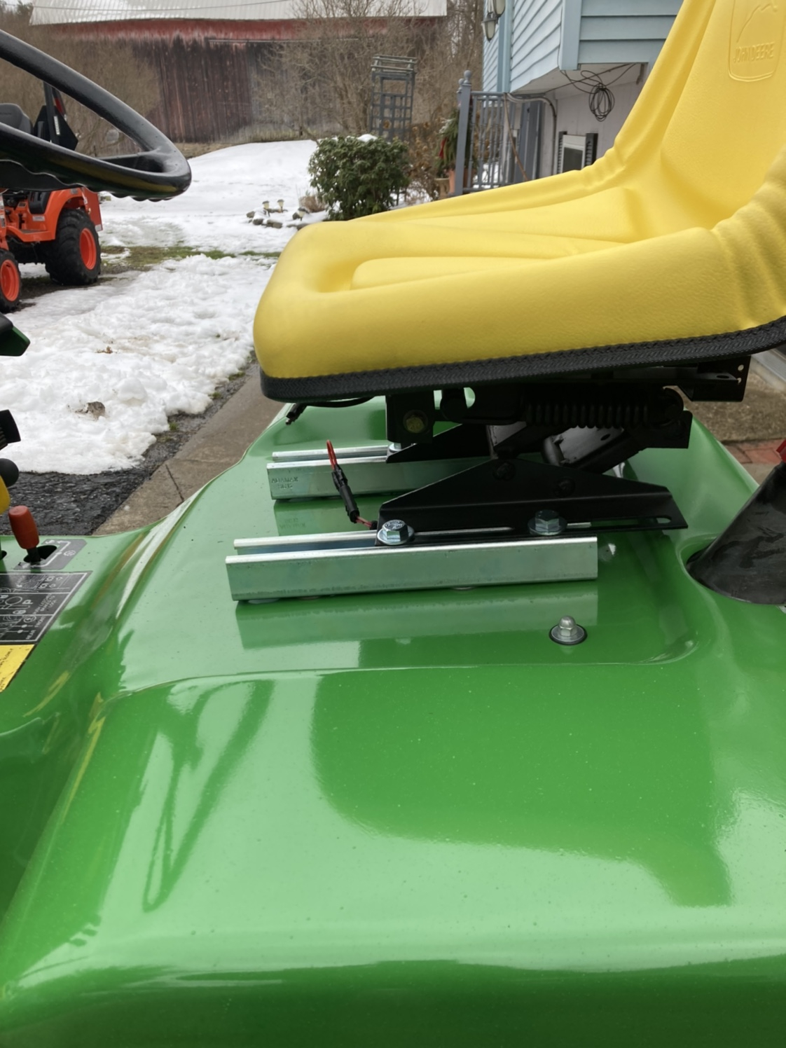

Did this mod today. Makes it MUCH easier to get on/off the tractor. 2’ strut section from Lowes for $9, cut in half, and a 5 pack of 1/2” spring nuts for under $5. I used 1/2” x 1” long bolts with flat washers to fasten seat base to struts…View attachment 781356

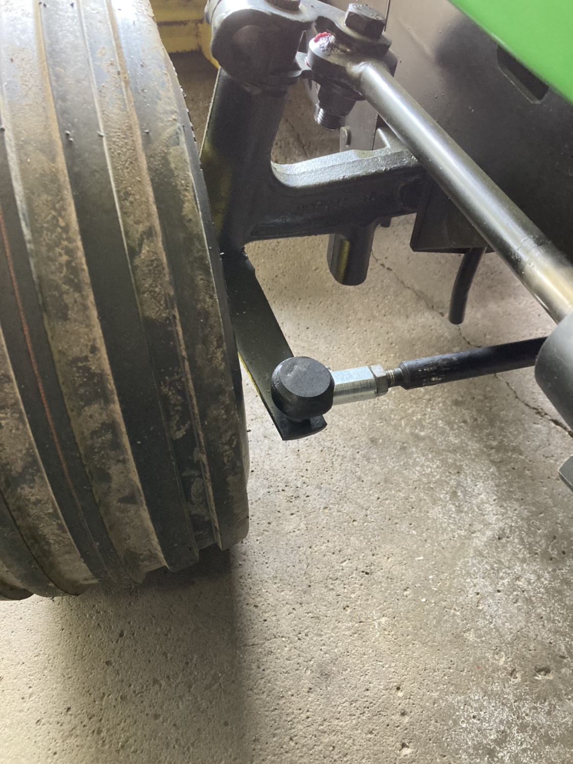

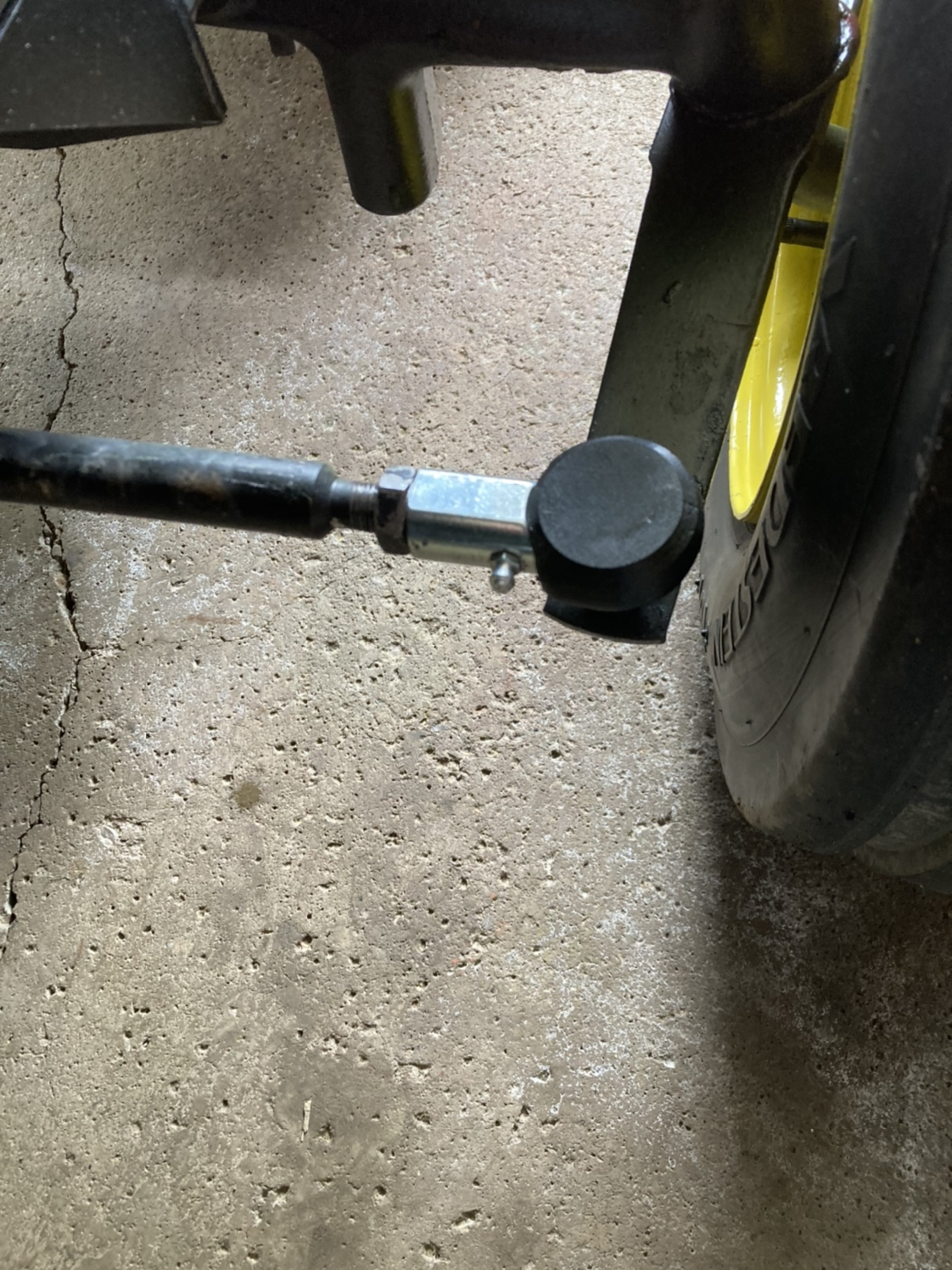

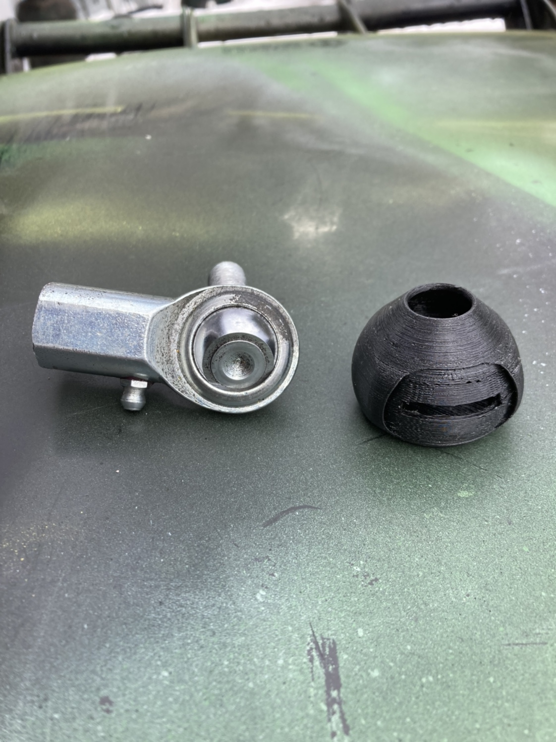

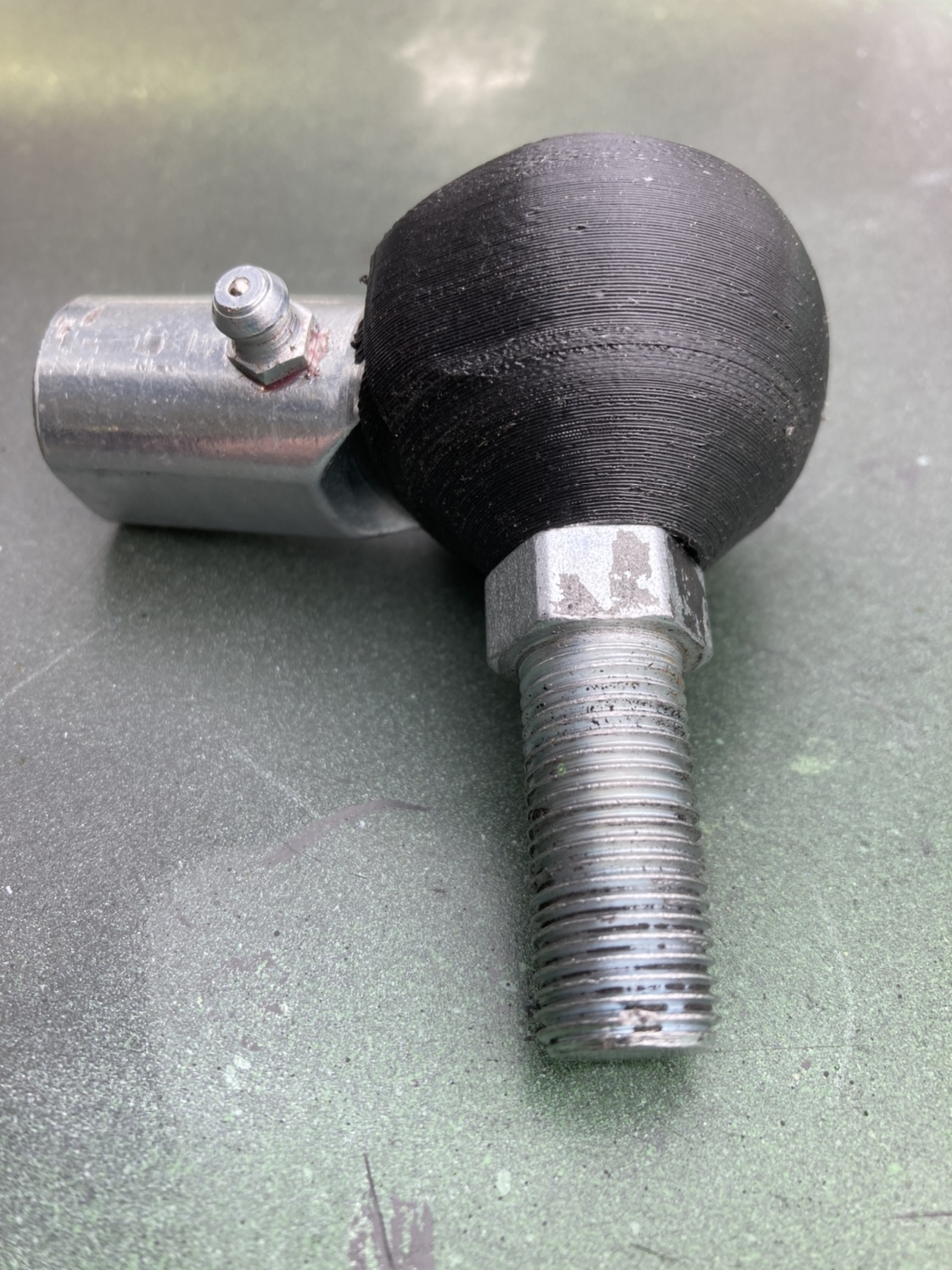

Also put these tie rod covers on. Saw a video on YouTube from Foxcan Farms about using Mcmaster Carr tie rod ends, and his son designed and 3D printed the covers. I bought a set when he listed them on eBay, but install didn’t go well. They made them better and install went smooth today

View attachment 781347Did this mod today. Makes it MUCH easier to get on/off the tractor. 2’ strut section from Lowes for $9, cut in half, and a 5 pack of 1/2” spring nuts for under $5. I used 1/2” x 1” long bolts with flat washers to fasten seat base to struts…View attachment 781356
Did adding the extra height to the seat make it uncomfortable when reaching for the steering wheel ?
   / New to me JD 430, 60” deck…
#37
No, just the brake pedals🤣🤣🤣. Might switch it back to normal because some people are saying it’ll crack the fender pan around bolt holes. Almost got the deck done, need to get a set of blades with correct center bore.Think I’m gonna sell it anyway

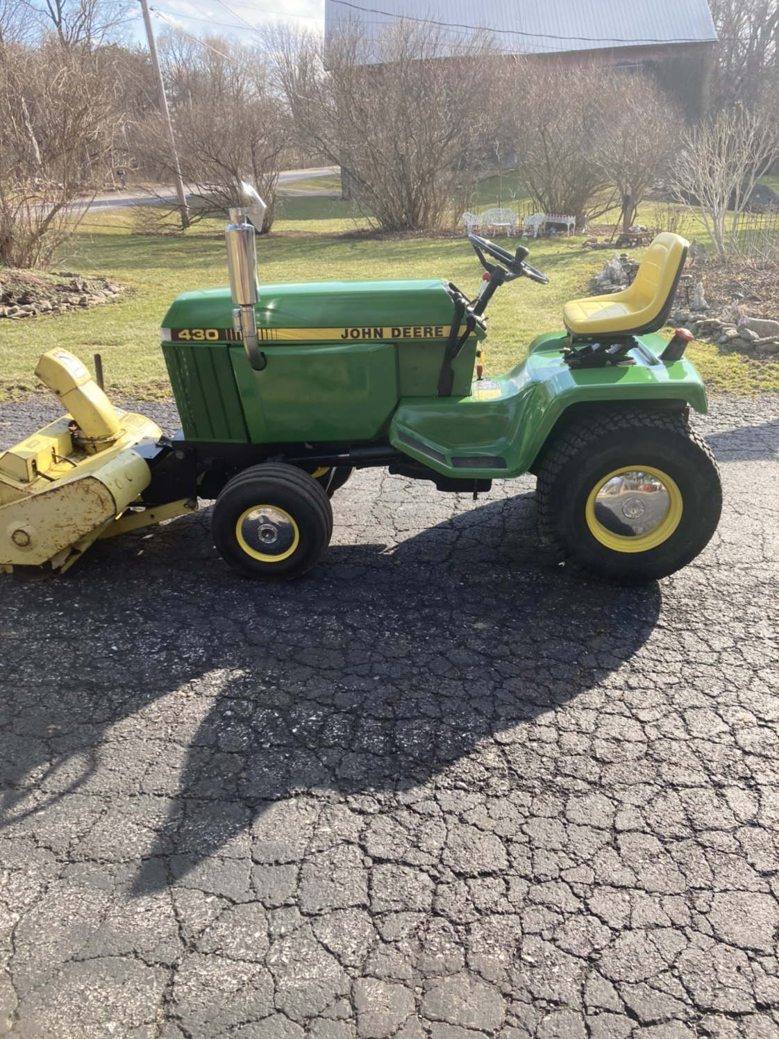

Finished the deck up last week, got some Gator blades with correct bore, but were a little thinner than blades that were on there. I added a washer so I could tighten blades up. I ordered a 2” chrome muffler that was 12” long, so I took 24” straight pipe off. I’d post video, but can’t figure it out. Guess I’ll order the correct seat for it that’s around $208 plus tax- the AM102953 for the non-flip adjustable seat base. The TY15863 isn’t correct, as the front bolt holes are 7” from front, not 5” like original. Once I get new seat I’ll see if I still need to keep the strut risers on that I added to get clearance….
#39
well, here it all finished except for putting a new neutral switch in. Got the correct seat on, took the strut risers off. Put the deck on pallet and put tarp on it for now. Probably should put it on tractor, don’t think we’ll be getting any measurable snow…
