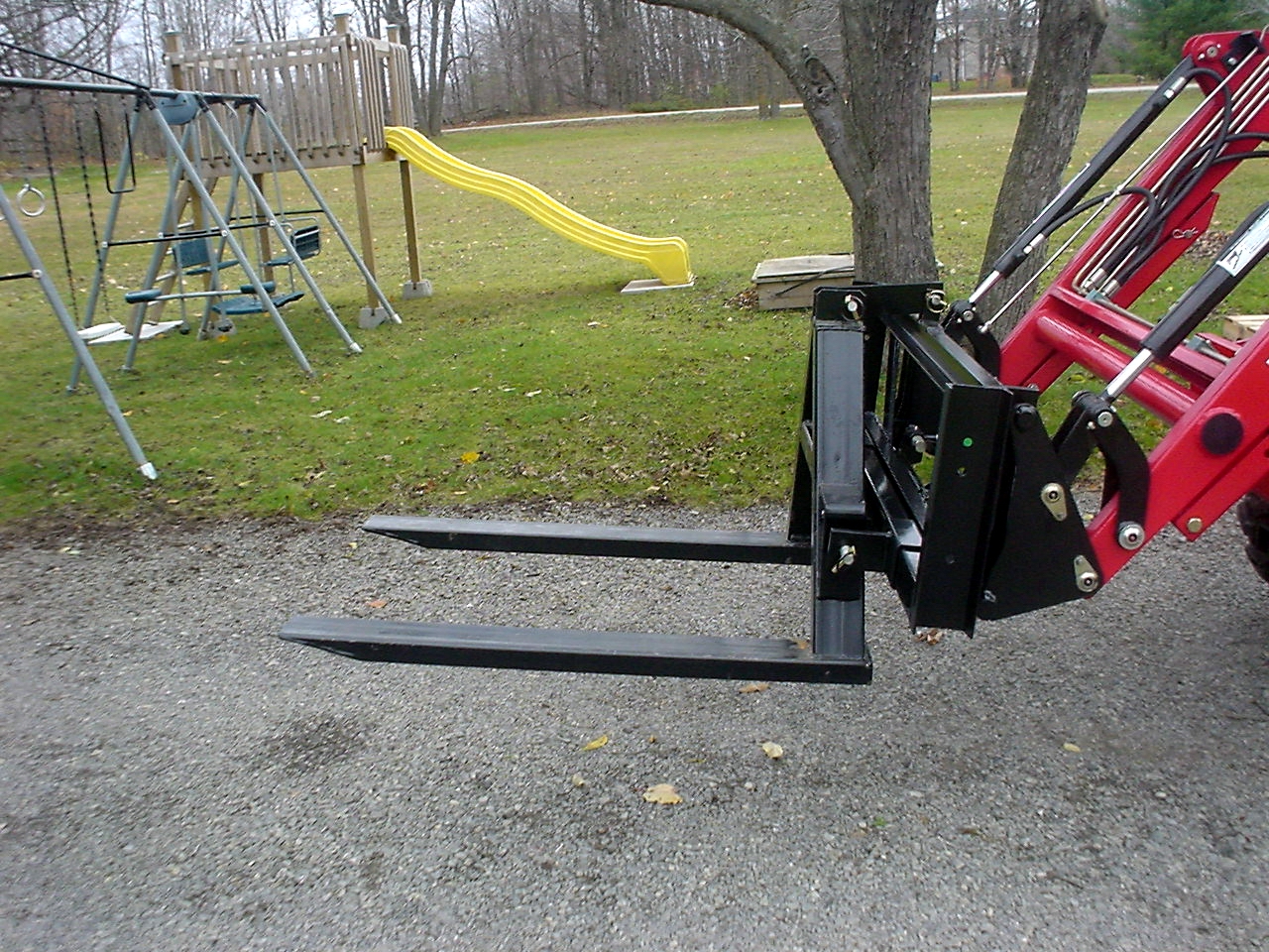

Surprised at how little this machine can lift with the loader though :( i got some pallet forks for it and it would not even lift a small pallet with two boulders on it. I was barely able to lift each boulder individually, and while i dont know the exact weight, i know two strong men can pick up these boulders.
On the other hand, it handled 600 pounds of concrete admirably, so maybe im vastly underestimating the weight of the boulders.

The other thing with the pallet forks you have is how far forward they sit. If you can remove the bucket and mount them back further they will work better. I did this with my DF254 and I can lift a fair bit.
any opinion on 3 point hitch forks? I can swing up and pick up a 3 point hitch pallet for set for 100 bucks locally.

I had to make up an adapter to mount them on the loader frame using the quick attach system that DF uses.
I have never tried them on the rear, should work good there especially if you have a hydraulic top link to tilt them.
Main problem with these forks is that the fork spacing is fixed making them hard to use for some pallets. A good back rest added would improve safety at the expense of visibility and slightly less load capacity due to the added weight.
I do not use these forks every day but they are sure handy when you need them.
