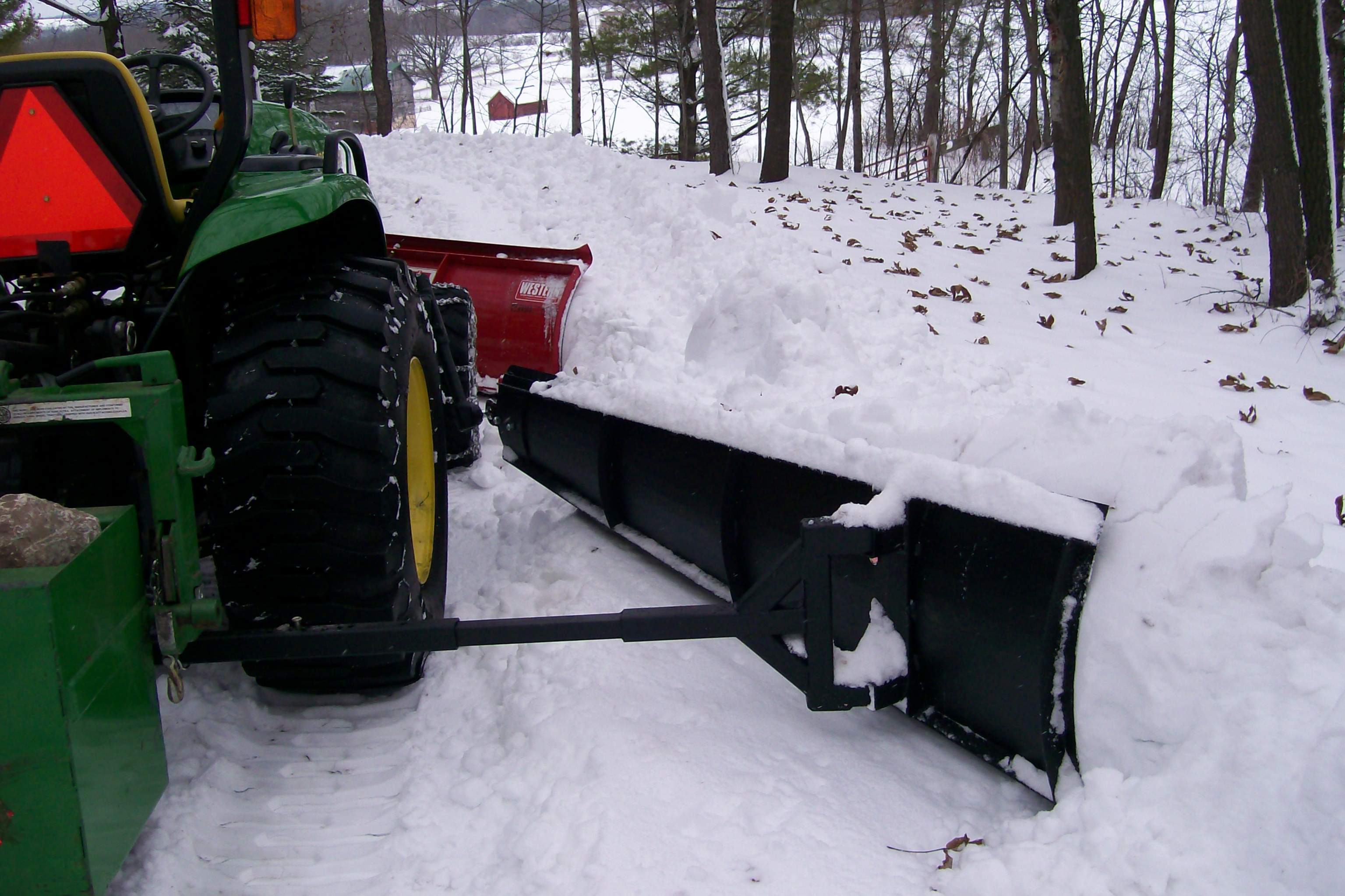

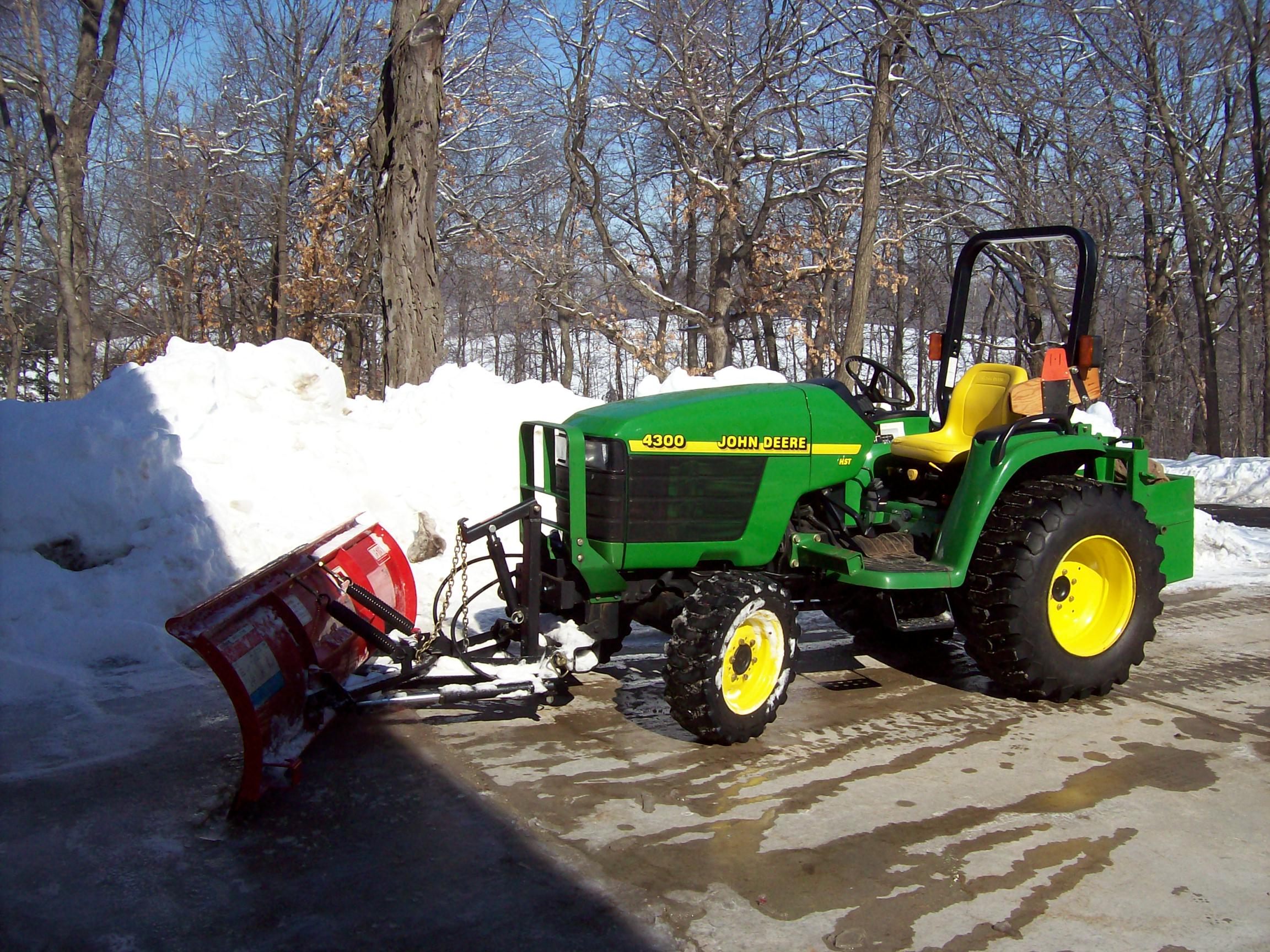

I put a Western 7' plow on mine and it is a snow monster. Especially so after adding a wing plow to it.
The Deere FEL's are very quick to add or drop. Except for connecting four hoses, all is done from the tractor seat.
The plow is quick-tach too, with just two 1/2" bolts through the weight bracket plate to lock it in place and attach three hoses.
The wing plow equally quick, as the front is held to a bracket that slides over the FEL frame post, and the rear is just a telescoping arm that goes to the drawbar with one pin holding it. The lift of the wing is with a short chain around the 3 ph lifting arm and the wing push arm. The wing will attach equally as well on either left or right side.

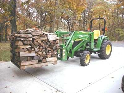

Here is a pic of my 4300 with the newer style 300X loader on it, the curved arms make it look much more modern and you may have better luck finding one of these. The forks on more then my bucket also. I have everthing on pallets outside so things can be moved or brought inside easily.tractor 1.JPG

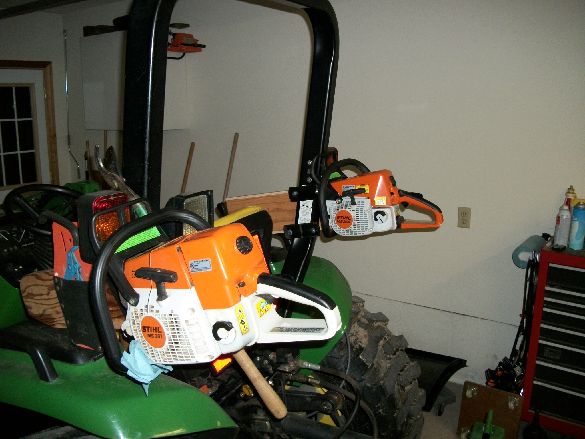

Could we get a close up of your chainsaw holder? Thank you.
   / New to me John Deere 4300 and looking for attachments #7
I'll do that. Have one on both sides. Handy to have when cutting firewood logs in the woods.
Just plywood with a spacer, and scrap metal to clamp to the ROPS.

I see one is a deluxe model with a rounded front corner. You must climb on and off that side. Beats buying something when you can make it. Very nice. Thank you.
