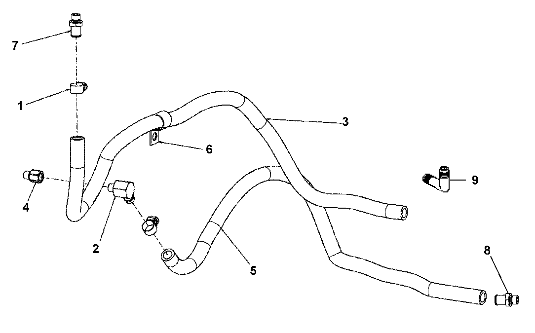

I'd recommend installing a manual heater hose cutoff valve. In Texas a tractor cab heater sees very limited service even in the Winter time.
   / New to me John Deere 5093E
#14
How and where?
I notice two rubber hoses under the door of the cab..Is that the heater hoses?
   / New to me John Deere 5093E #15
Any accessible place on heater hose will be fine
