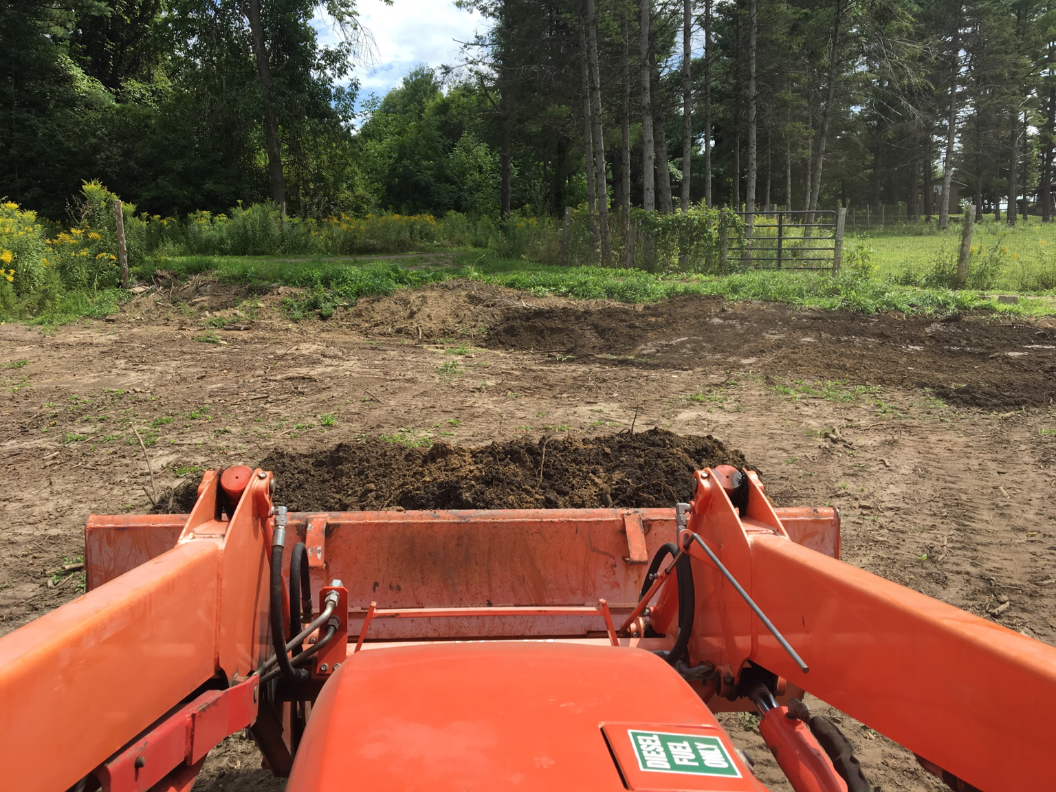

   / New to me Kubota M59
#63
Clean up time. Rocks everywhere!
Getting some dirt work done. The M59 really shines and enjoys this type of work.

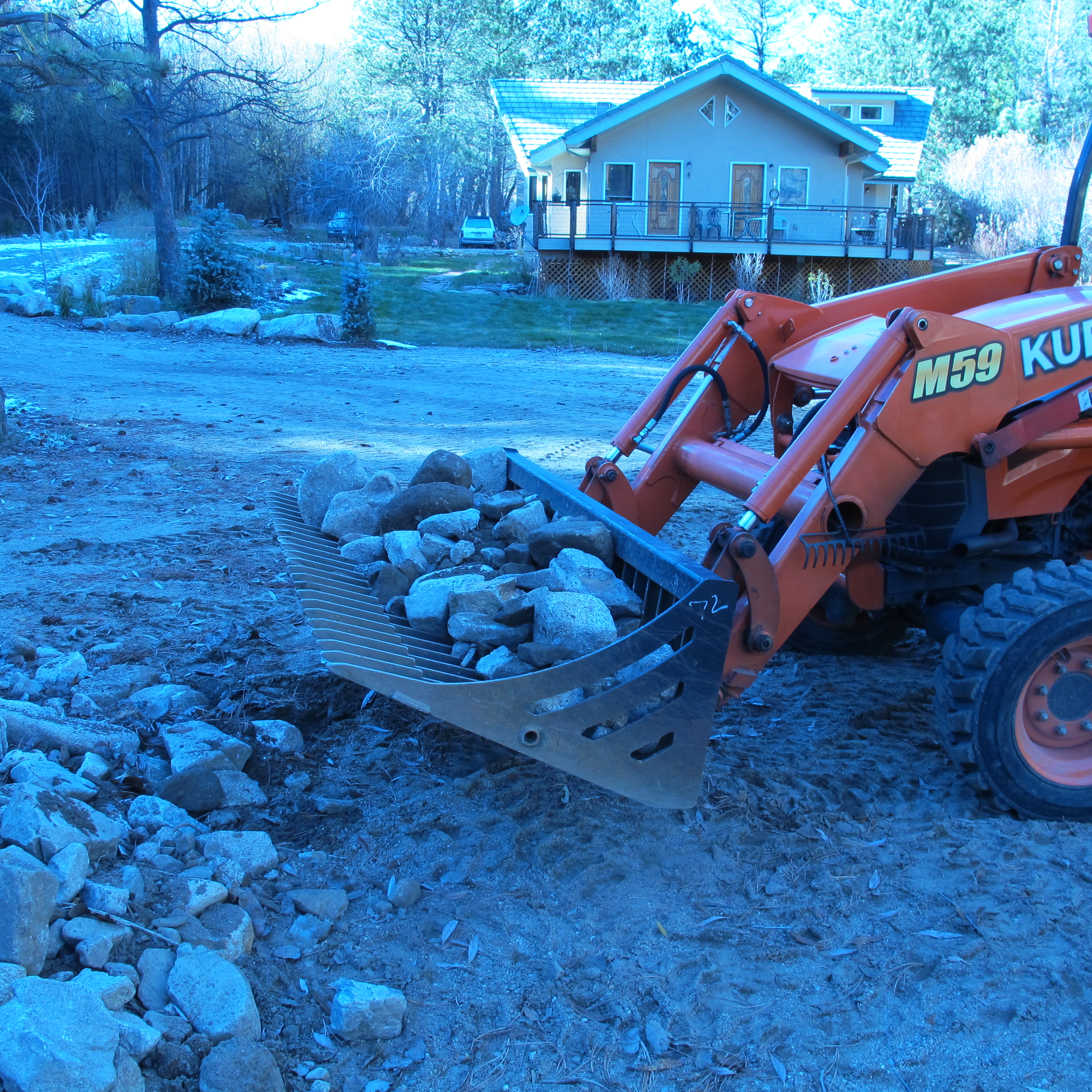

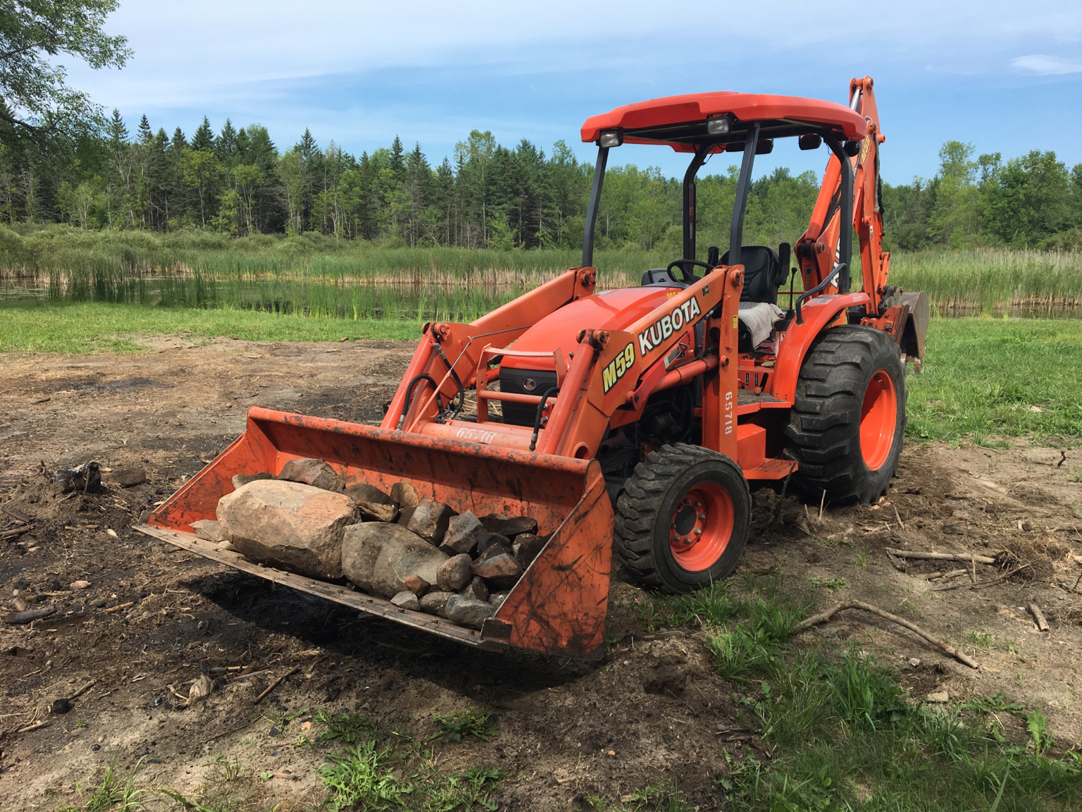

I bought a couple of rock buckets. Not expensive & very handy. One has about 3" spacing and the other 4". The trick to using them is to get the rocks on the front lip of the bucket and then slighly raise the bucket & tilt it to roll them to the back. That way the dirt falls out. It doesn't work to just dive into the ground expecting the dirt and rock to separate.
rScotty

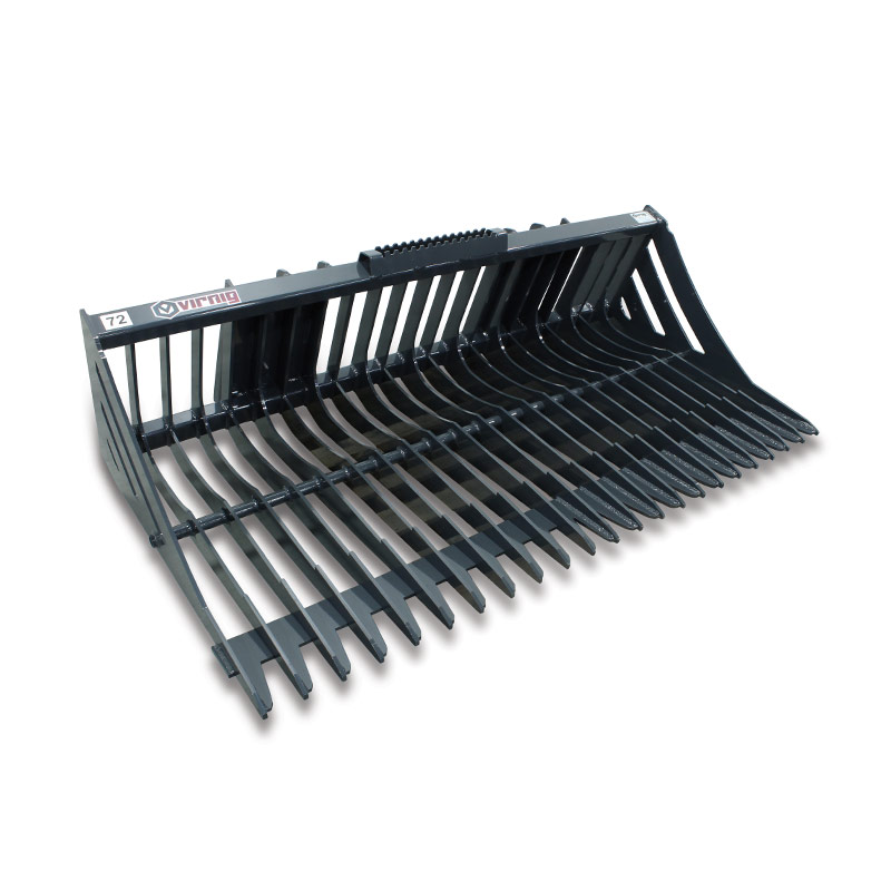

So my Land Pride Grapple never came in. The dealer told me again they were just trying to save me and them money on shipping. I had said okay to that several times. Then looked back and realized I had asked them to order it over seven weeks ago. I thanked him for what he did for me, making things right with the tractor, lending me a machine while I waited for them to get it right, and told him I appreciated it. Then I told them to cancel the order. I have a ton of work to do and just can’t wait any longer.
Then I went looking again and decided to order one of these.
Skid Steer Rock Grapple For Sale | Skid Pro Attachments
Should be good for many task. I have a lot of rocks and tree clean up on this property.
Can’t wait till it gets here.

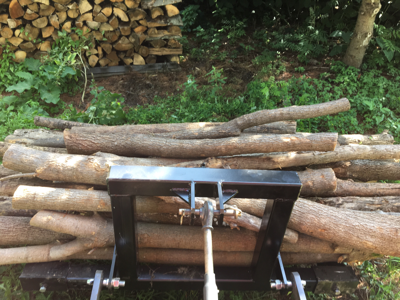

A little 3-Point hitch pallet fork work today. Moving some things around. IMG_4267.JPG
#70
Time for a little re-in forcing here. D’Oh!
My plan for these forks is to be a carry all for one or two two different work boxes I’m going to build.
