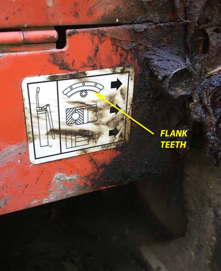

I'm totally lost on spinning carriage while greasing flank teeth. Where are the flank teeth? THX

656016d1589768537-new-me-kx033-4-a-flank-jpg
Cant see the (3) grease nipples under all that grease but you should have a similar greasing decal.
Owners manual says to grease the flank in 4 locations (Like North, East South West)
But you can spin the carriage while holding the trigger down on the 18v greasegun.
It's much more satisfying but my advice is to do it in private.
If anyone sees you having that much fun...... they will never understand and may judge harshly.
