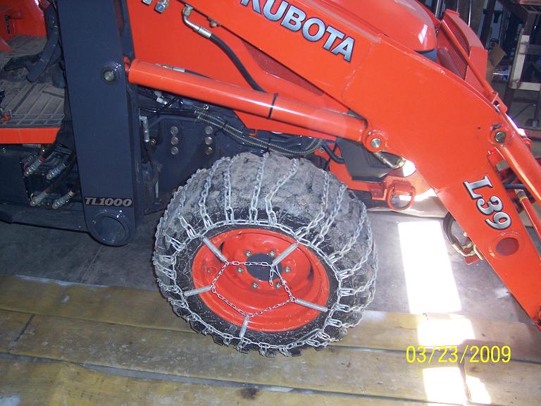

Thanks for the advice Walt. I should have thought of using the brakes to steer but i guess this is all part of the learning curve. Knowing that your using back chains with no problems I will order a set. How do your front chains work? Don't they hit the metal pice that guards the exast pipe when you turn right? I will search for your pictures. Thanks again.

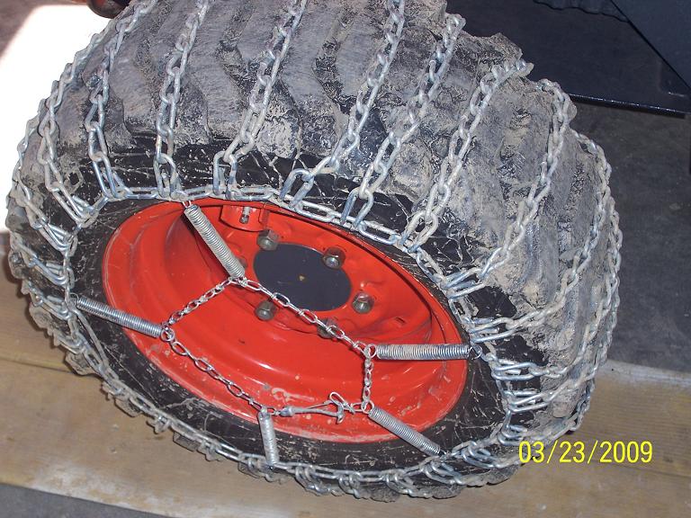

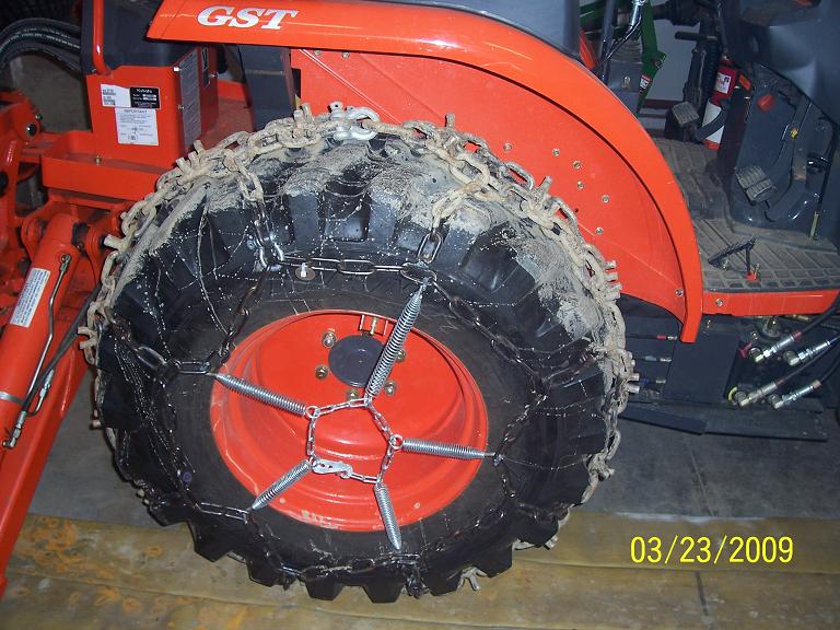

mbradey;
The front chains are 2 link but don't provide much for traction as previously stated but I have them so I use them. The rear chains provide the traction for me.
If you're not driving on pavement, the forestry type chains are far superior to the ladder chains. They take some time to install, but I put them on in November and remove them in April, once a year. If all my driving was off pavement, I would leave them on year round.
I attached 4 pictures of the front & rear chains installed. I have not had the clearance issue on the front chains as you stated.
The key is to keep the chains tight so the no loose or slack chain can contact anything.
A friend of mine related a story of his buddy running loose chains for 5 minutes until both his rear fenders were tore off. I don't remember the type/model of tractor.
By the time you know the chains have caught, its too late. Remember that this is a 7000 lb machine, with that momentum bad things can happen quickly.
As this is your first tractor, take it slow to develop a feel for the machine, especially when using the loader. I try to always keep my hand on the loader joystick when I have something in the bucket/grapple, ready to drop it if needed. Also be in 4WD as a full bucket load shifts your weight from the rear axle (brakes) to the front axle. (no brakes)
