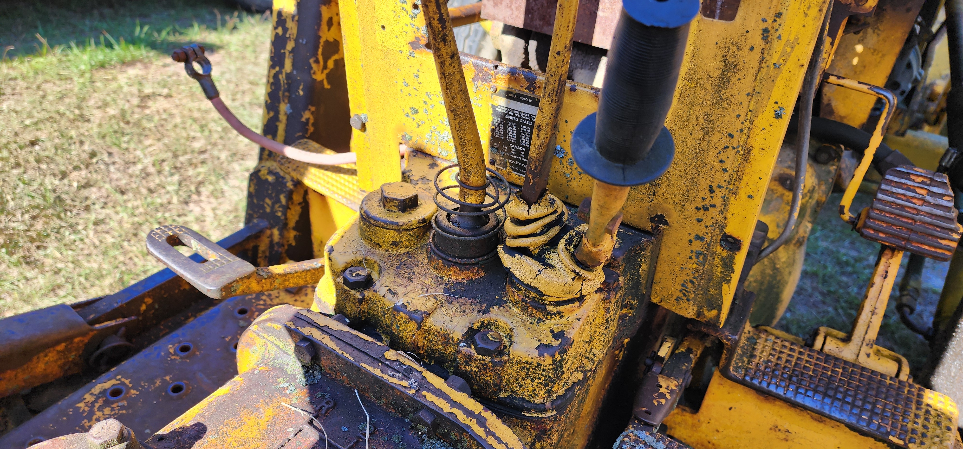

I have a few questions about this tractor. The shift boots are non-existent, are replacements available?

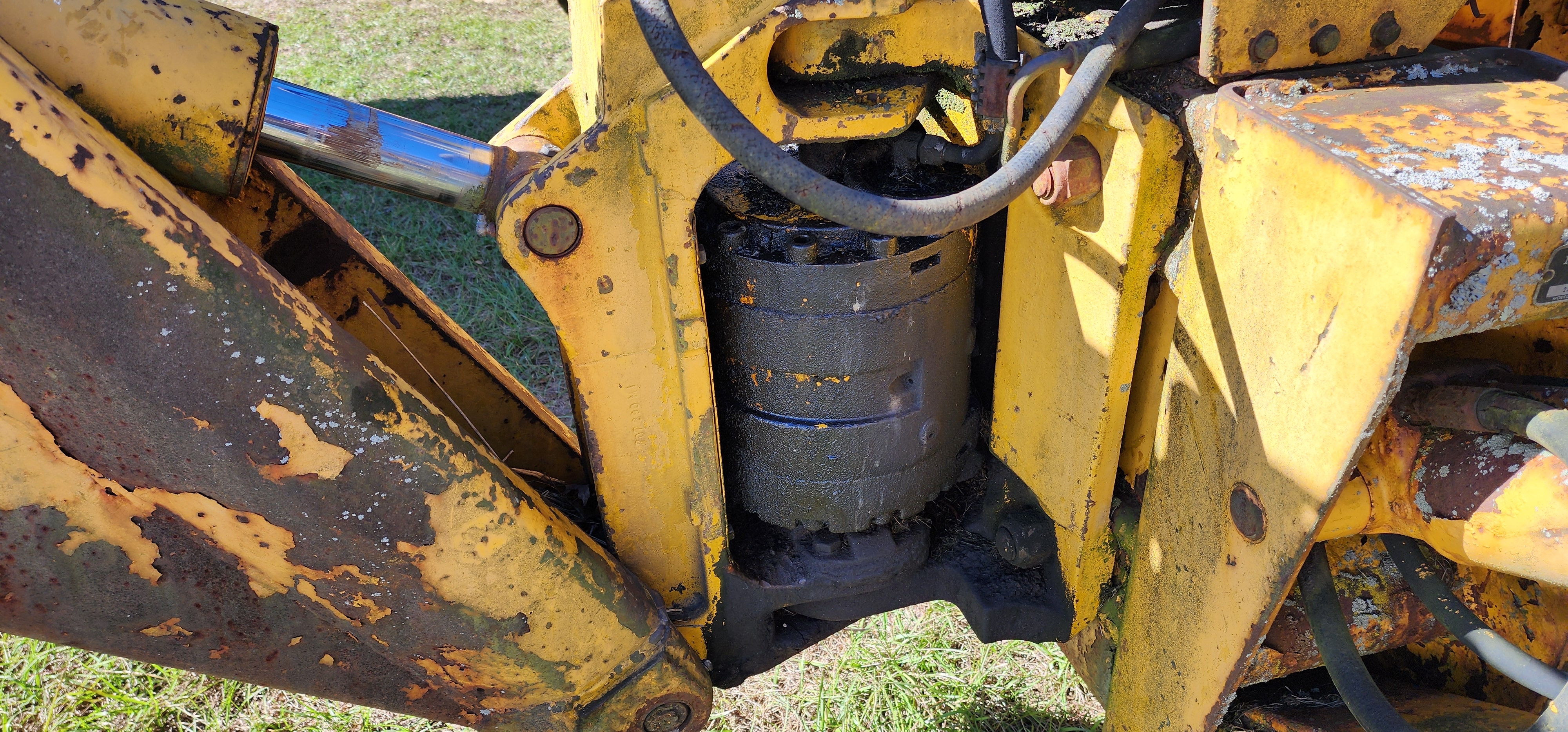

The swing motor looks to be leaking pretty bad, where can I get seals?

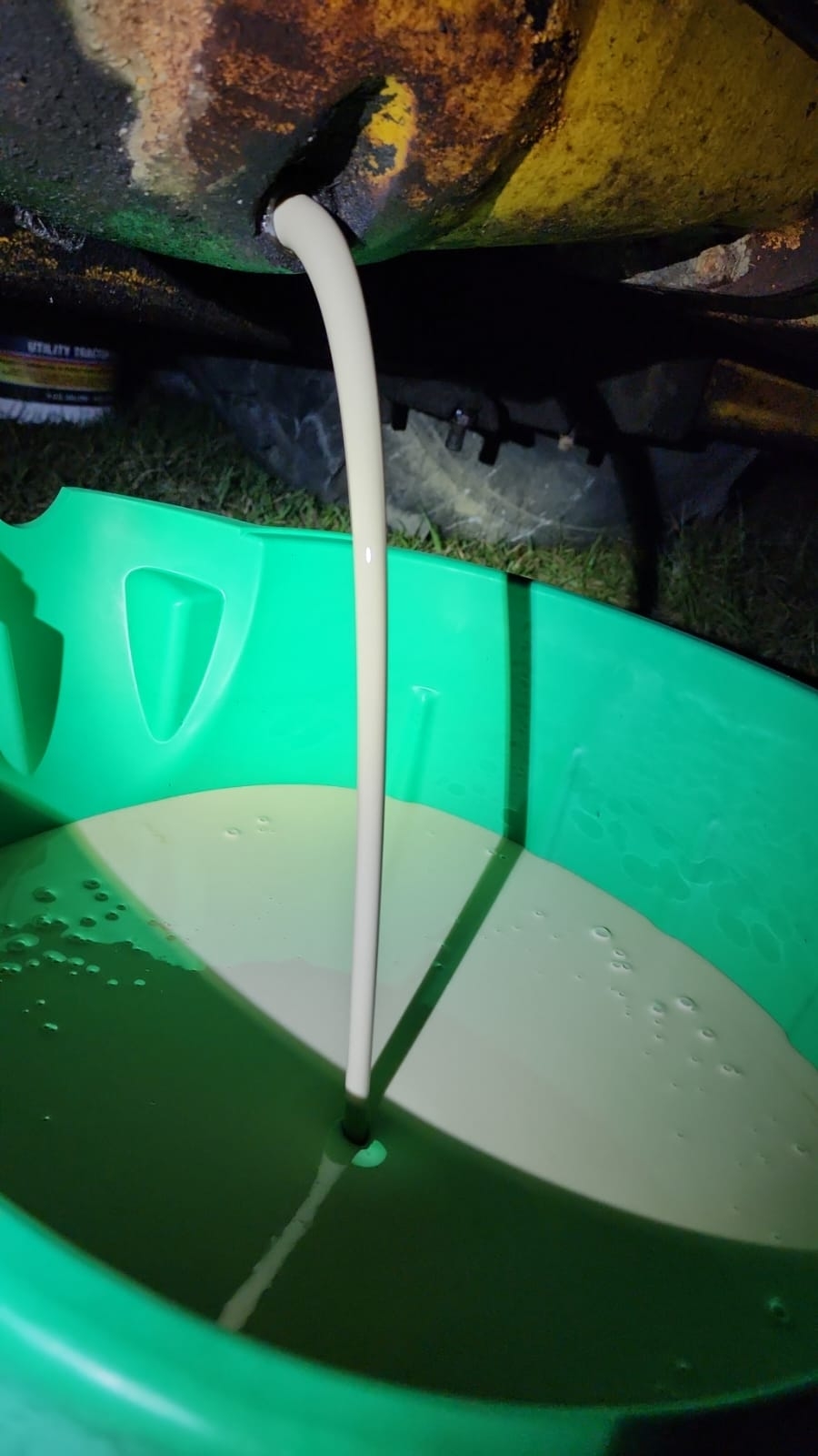

not really sure what to put back in, but this is what came out!
the gears look clean in the transmission
That's what trans/hydraulic fluid looks like when it has absorbed a lot of water - like milk. The water usually gets in as rain/snow seeping past the shifter boots. T/H fluid is made with additives to hold water in suspension instead of separating out.
Your T/H fluid started out as a clear oil of about the same viscosity as 20wt motor oil. And of course now that milky oil+water it is all through the hydraulic system including valves, filters, hoses, and hydraulic cylinders.
Good news is it is surprising how much water can get into the T/H oil and not cause a long term problem. You say the gears look good. That's why. And also a good reason to spend the money eventually to put in the best grade of T/H fluid. But first, you'll need to flush the system repeatedly. TH fluid is expensive, so either start with the cheapest, or do an initial flush or two with 20 wt. motor oil or diesel fuel and go from there.
That's why the Trans/Hydraulic (T/H) fluid is milky. It has rainwater in it. Also check the center of the steering wheel....that's another path for water.
Boots are common and universal. But an old fashioned tarp over the top is better. They conform to the tractor and allow air to circulate.
No idea, but there are active online hobby groups for all these old machines. Mine is a JD, but parts for all of them are findable online.
