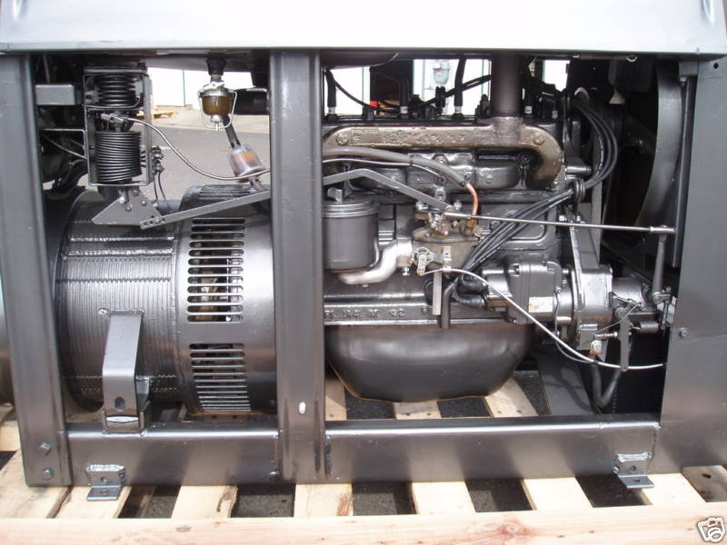

HMM. I wonder what octagon barrel means. Possibly the end cap?
But it certainly looks just like that one except in grey.
Should have taken a picture.
   / New(to me) Old Lincon SA-200 #12
Octagon barrel refers to the shape of the generator. Also indicates when Lincoln went cheap, which was about mid 1972. Lincoln started using aluminum in the windings instead of 100% copper. Octagon barrel SA-200's are not as sought after as the round barrel / 100% copper machines.
